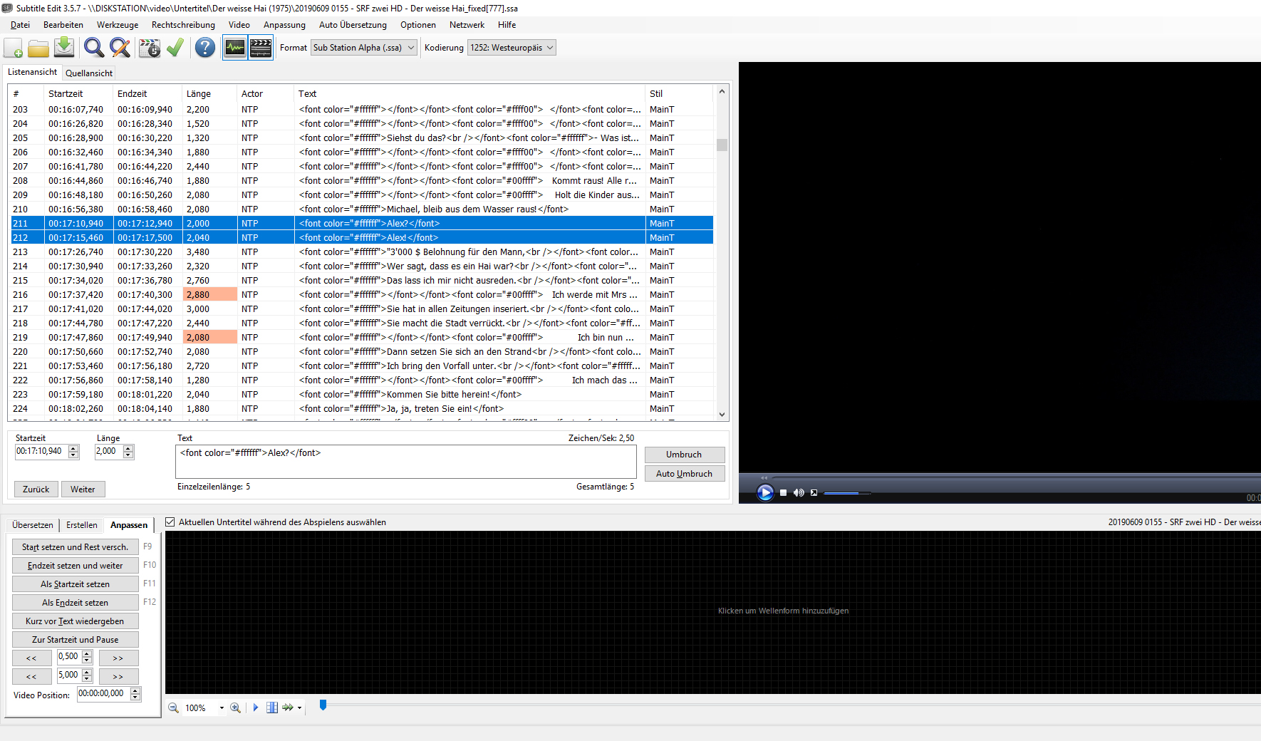

  1. I have some problems with CCExtractor because many subtitles are missed (more than 100 lines) after extracting to srt format. It works not good for movies which are recorded with black broadcast on screen especially. You will wondering why I recorded a movie with black screen because some TV broadcast have freezes, so I switched the function off and the subtitles works on screen well.

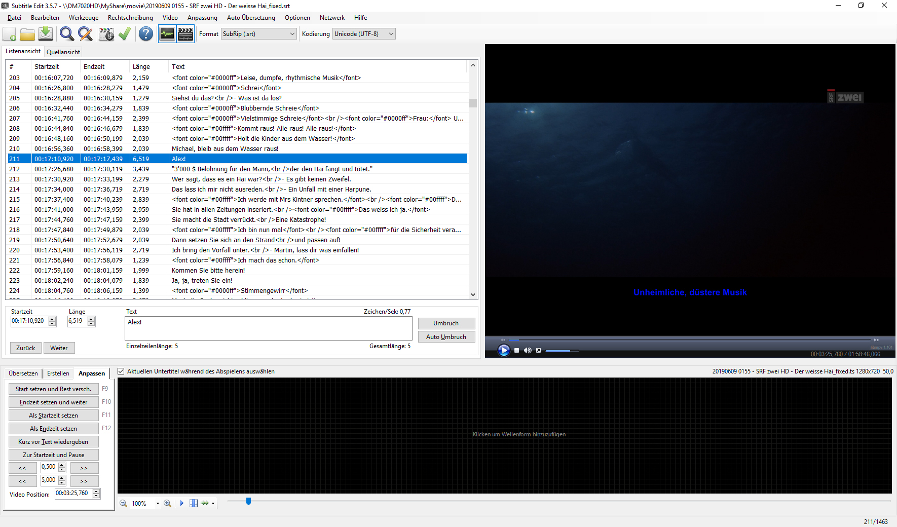

    Extracted by CCExtractor:
    [Attachment 49339 - Click to enlarge]
    Extracted by ProjectX:
    [Attachment 49340 - Click to enlarge]
