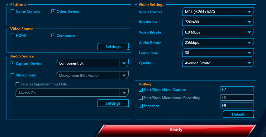

I've had my ExtremeCap U3 for a while now and just recently hooked it back up to my PC to digitize some old home movies on VHS. I attached it using component + RCA audio, then installed the latest RECentral + drivers from the website. I've created a profile in RECentral which is properly configured for my connections and when playing a VHS tape (and RECentral is in preview mode), it plays the video and audio just fine. Unfortunately, once the video has been captured and automatically saved to an MP4, there is no audio. I'd think it would be an encoder issue, but can't find any log files to get more details.
Below is what I've tried so (without luck) far, screenshots showing the above, then finally specs. Any suggestions would be welcome. Thanks!!

Profile Settings
[Attachment 49325 - Click to enlarge]

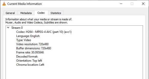

Captured MP4's Codec Specs
[Attachment 49326 - Click to enlarge]
