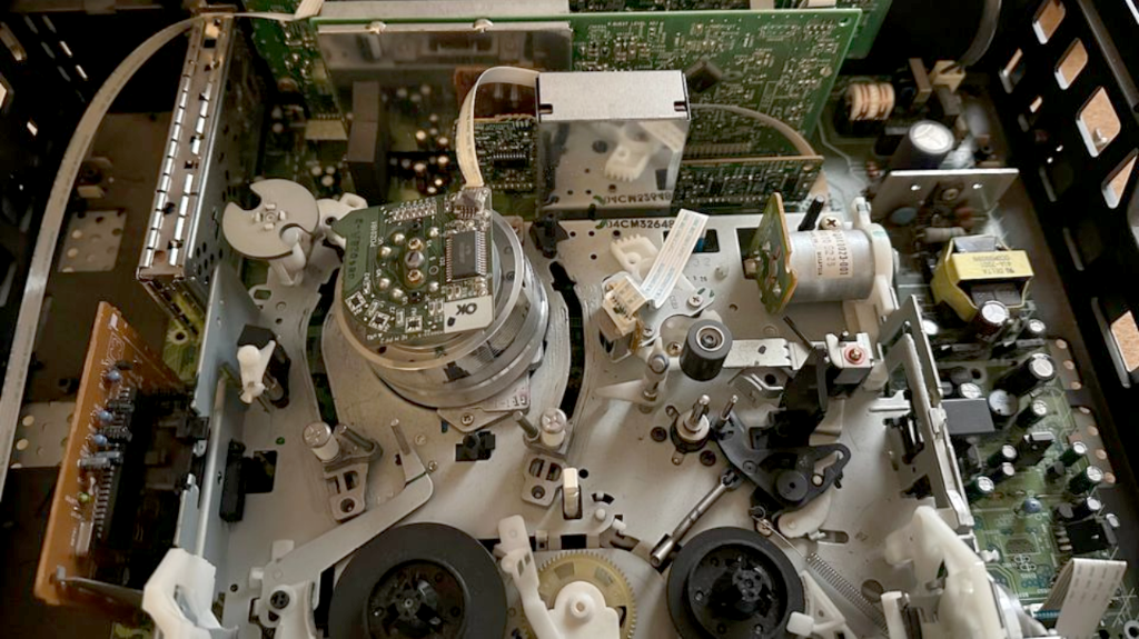

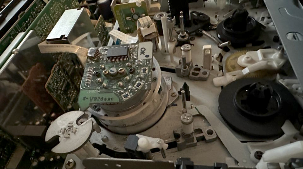

    Hi, I'm new here and I live in the Netherlands in Europe.
    I'm a hobbyist with a big love for old vintage video equipment, and I'm always open to learning from others.
    At the moment I'm digitizing my old VHS/S-VHS tapes and I want to achieve the best quality possible. I still have my Philips VR20D/58, which I bought new back in 2000, and it's still running like new. This is my main deck for capturing. Part of the hobby is trying other S-VHS recorders as well. Besides the Philips, I bought a used Panasonic NV-FS200, and I have a third recorder on the way: a used JVC HR-S9500EU. From the inside, it looks quite good in my opinion. I also had some good phone calls with the previous owner, who spent 30 years archiving analog video material and is now retired. He said the player has been well taken care of and assured me it is running fine. It will arrive tomorrow, and then I will test it. After buying the player, I started reading the horror stories about the Dynamic Drum, which is how I ended up on this forum, where I subscribed and made a donation.

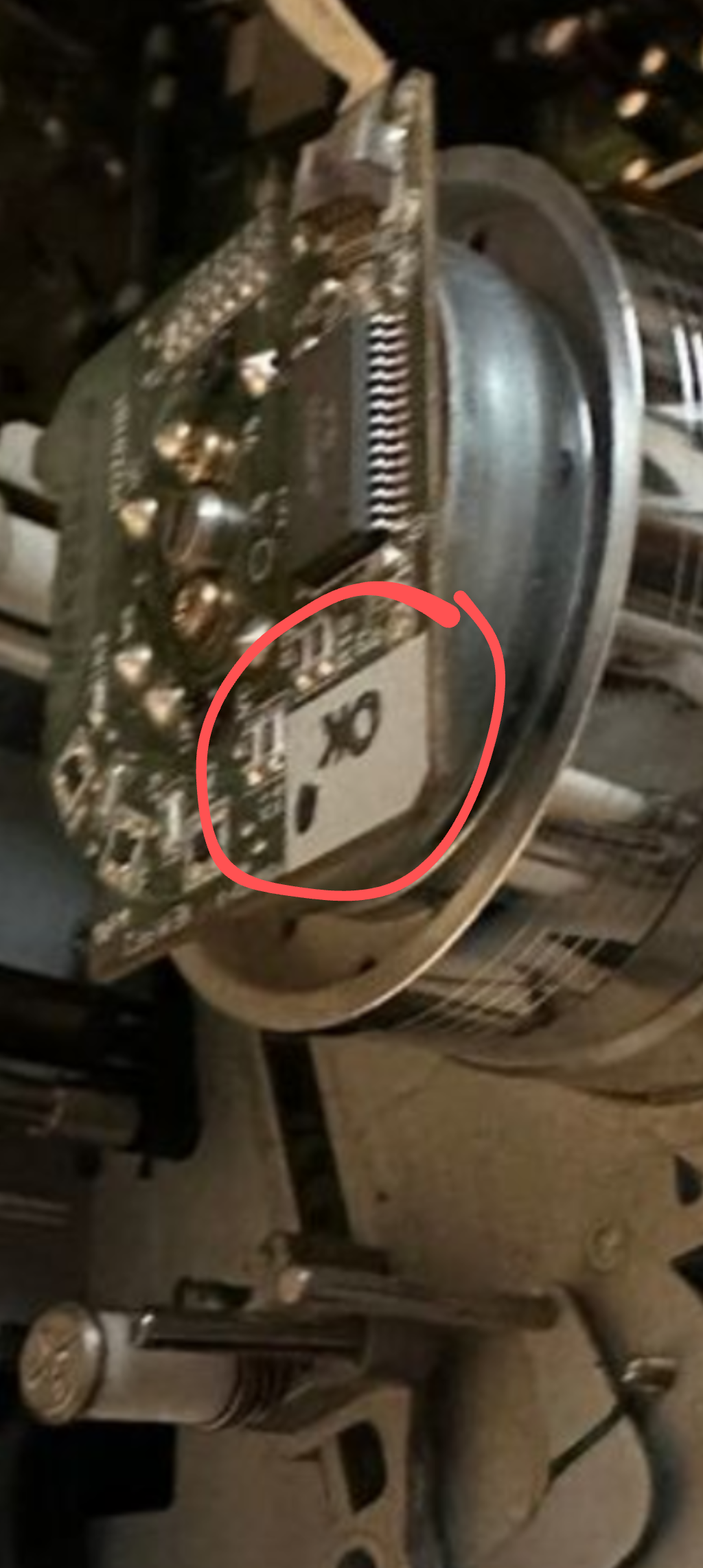

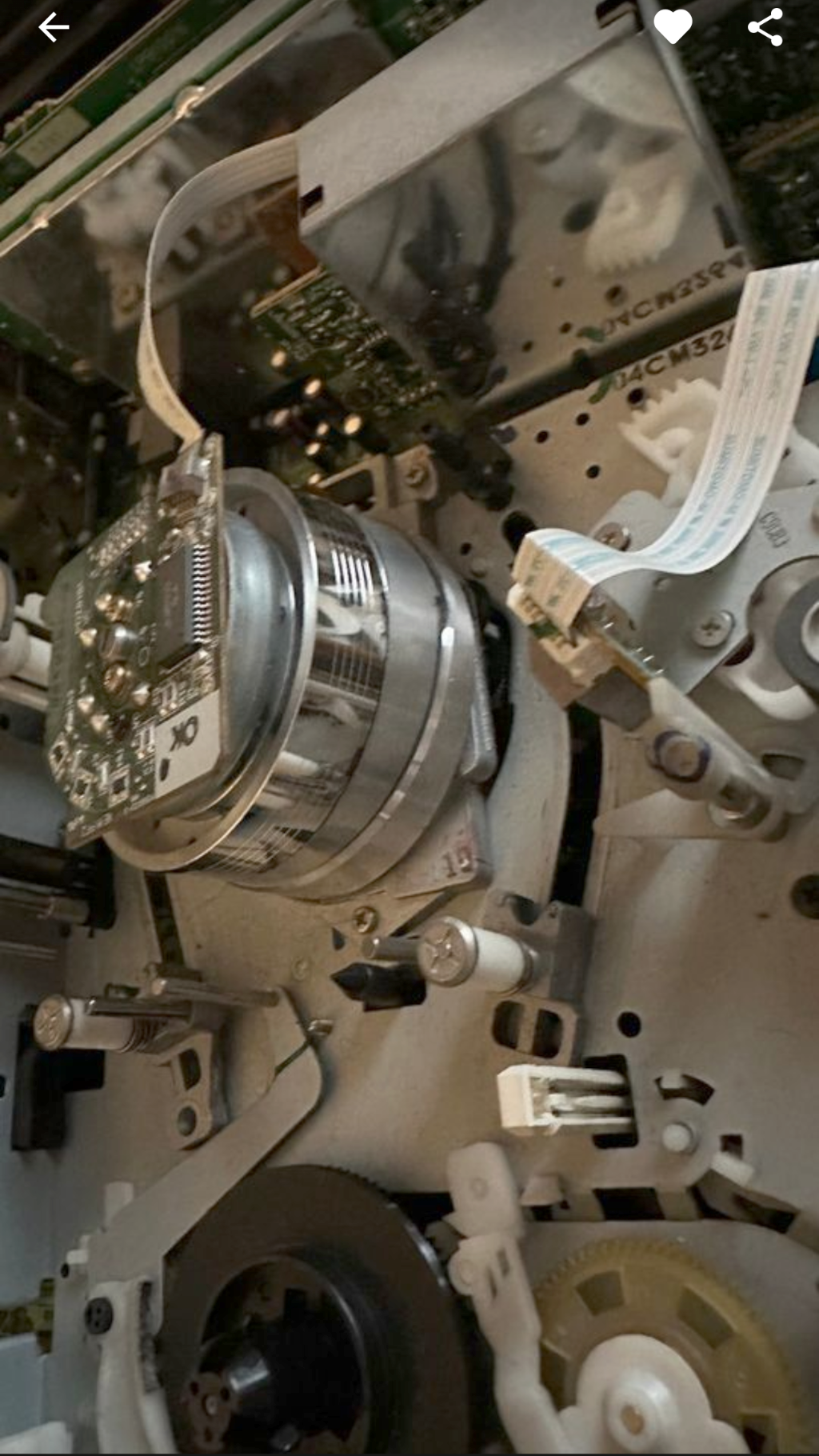

    I always like to be prepared, so I have already contacted Heikki and asked about the emulator. In the meantime, I would like to share some photos of the inside of the HR-S9500EU, and I noticed the “OK” sticker on the drum. Was this originally done at the factory, or could it indicate that it has been serviced before?
    Thanks for reading and for any advice.

    Jan 2026
    Amsterdam (The Netherlands- Europe)
    I ordered the emulator from Heikki yesterday. If you like it, I can share my experiences!
  9. Originally Posted by VR20D View Post
    ... and I noticed the “OK” sticker on the drum. Was this originally done at the factory,....
    I own a JVC HR-S9500E, little used an in top condition. Certainly one of the high-end consumer models. And yes, it has this "OK" sticker as well. Factory QC I assume.

    Big thanks to hkorpim (Heikki) for sending me the emulator. My JVC HR-S9500 is running perfectly!

  12. It worked great in my weird rebadged HR-S9800U, too. I taped down the ribbon cable on either side as it passes under the chassis to make sure that it won't interfere with the tape guides.
