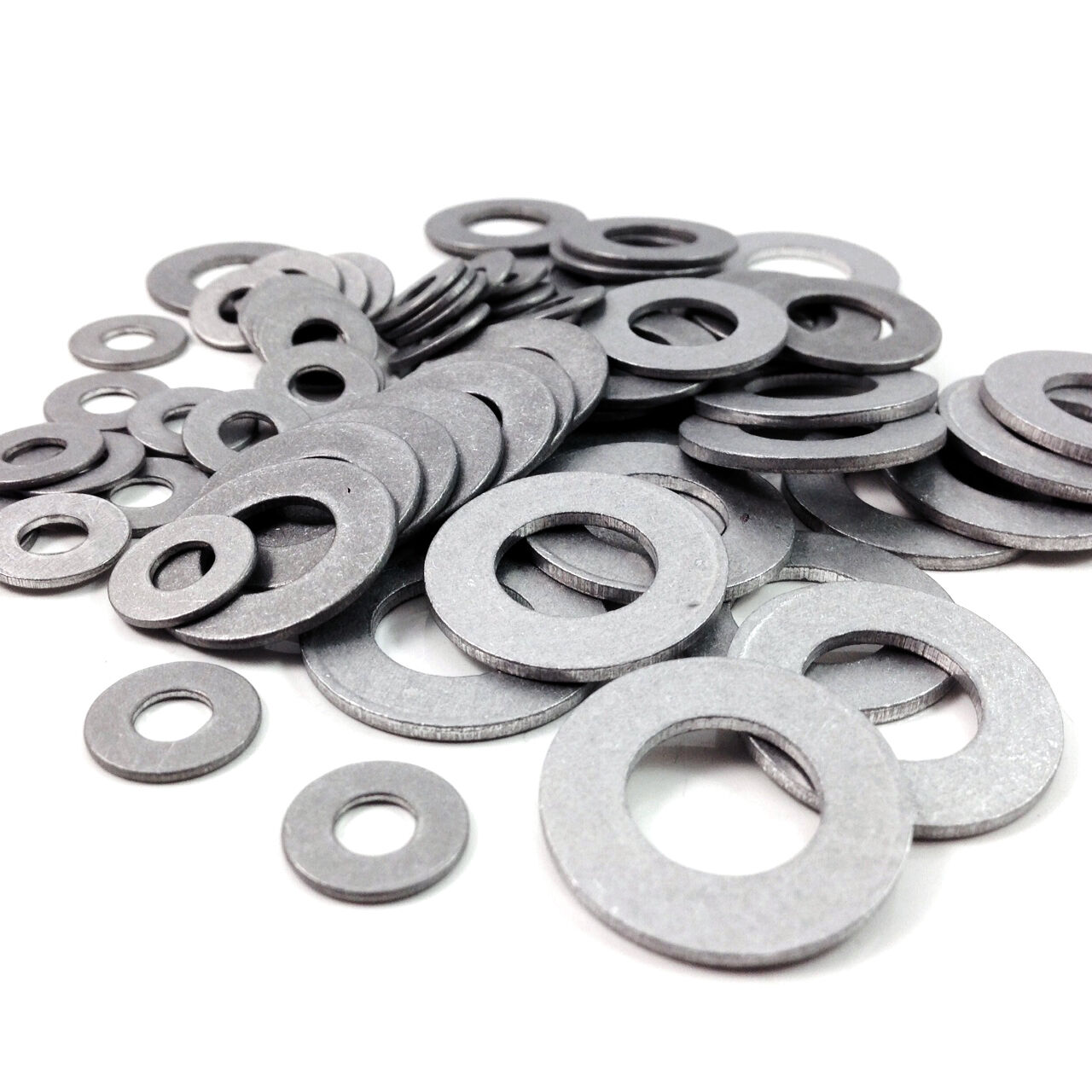

    How about using aluminium washers?
    First you glue the crack and then apply a washer of appropriate size with epoxy. That will prevent the gear from splitting again as the metal with the epoxy glue will hold it together.
    Sony used plastic gears with very thin washers in small handycams some 20 years ago.

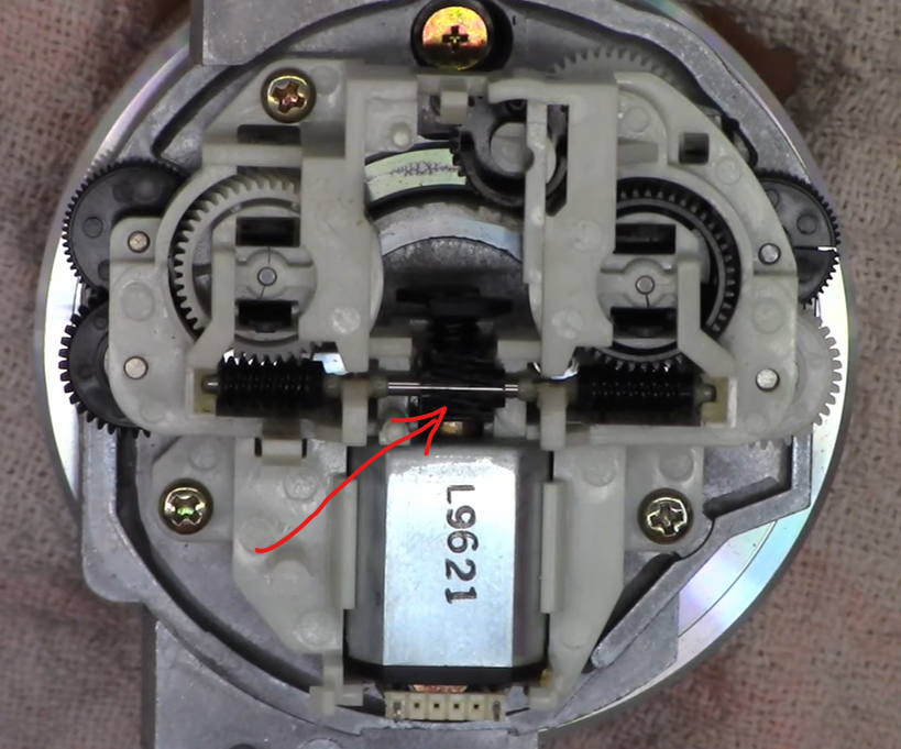

    I'm not an expert like you and i don't doubt what you say. But in PART 1 of the two videos, at 13':12'' he spots the split black gear.
    At 24':00'' he turns ON the device and in 2 seconds it switches OFF. Then inserts a tape wich procedure automaticaly turns ON the device, the tape is accepted, threaded, the drum spins and then it shuts OFF. Classic symptoms of Dynamic Drum System failure.
    In part 2 at 13':15'' he installs the motor and then the axel with transverse worm gear split and off the axel (see photo). And when he puts it back together it works. I don't know how he did it. The split black gear is not transmitting movement to the black gears left and right, but the sensors are reading the pulses from the pulley of the motor wich is turning freely.
    https://youtu.be/QvDw0mbaaiA?si=VONDMDf-uifYc1cn&t=817
