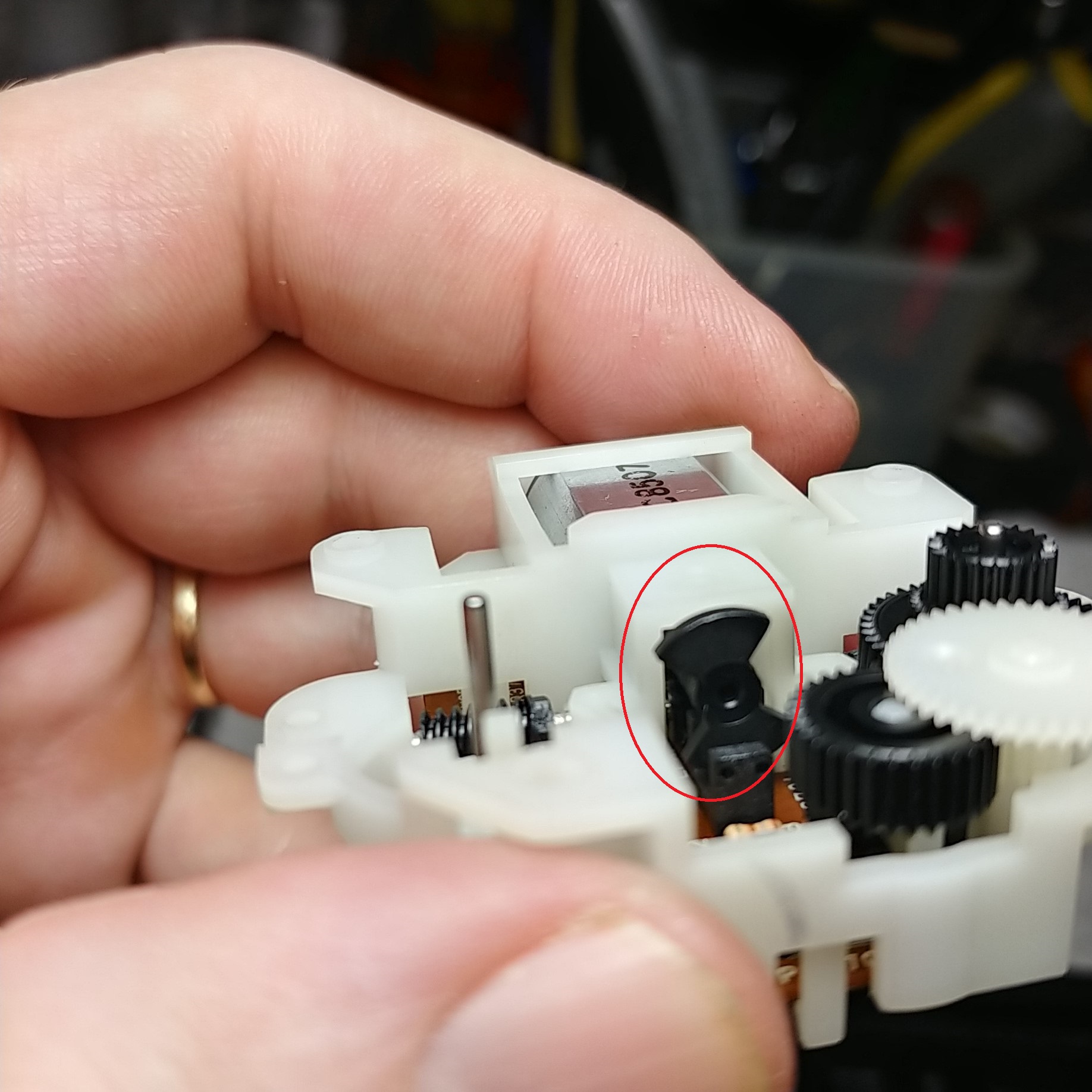

    2) The space under drum is very limited even if DD gearbox is removed, because the drum leans left and almost touches DD emulator.
    3) Plastic part in the picture below slides in direction of red arrow and touches DD emulator slightly.
    I see a lot of unused space in the PCB, You can redesign it to make it shorter so it will fit within the DD cavity.
  2. Trying this DD mod (i don't have the emulator) so i guess i'll try 2 options: resolder the gears or just disable DD.
    Anyway, i can't figure out how to remove the 4 gears for now if someone did it before, let me know the procedure, don't want to break things. THANKS

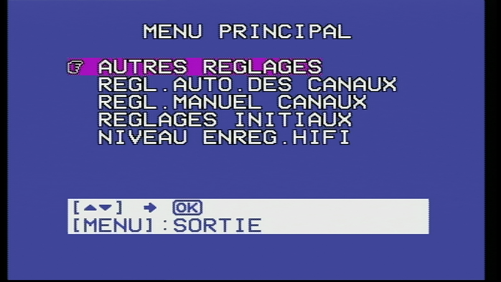

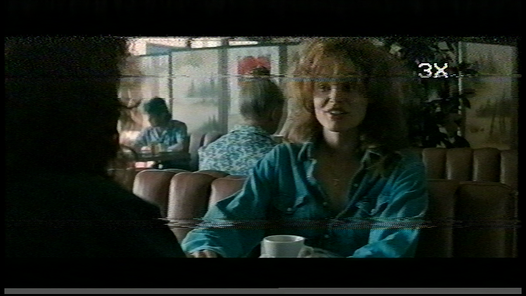

  6. Ok sucess for these (i put back the two big) , then there are the 2 screws with a spring, should i 3/4 turn these or not really ? (back to neutral position doing so, as i understand)
  7. It's a wrap ! I did a 1/4 turn for the 2 screws. I did have to tweak the P2 guide after that (snow on top) , nothing i'm not accustomed to. Then again, i don't know the history of this deck, best 10 bucks spent recently.

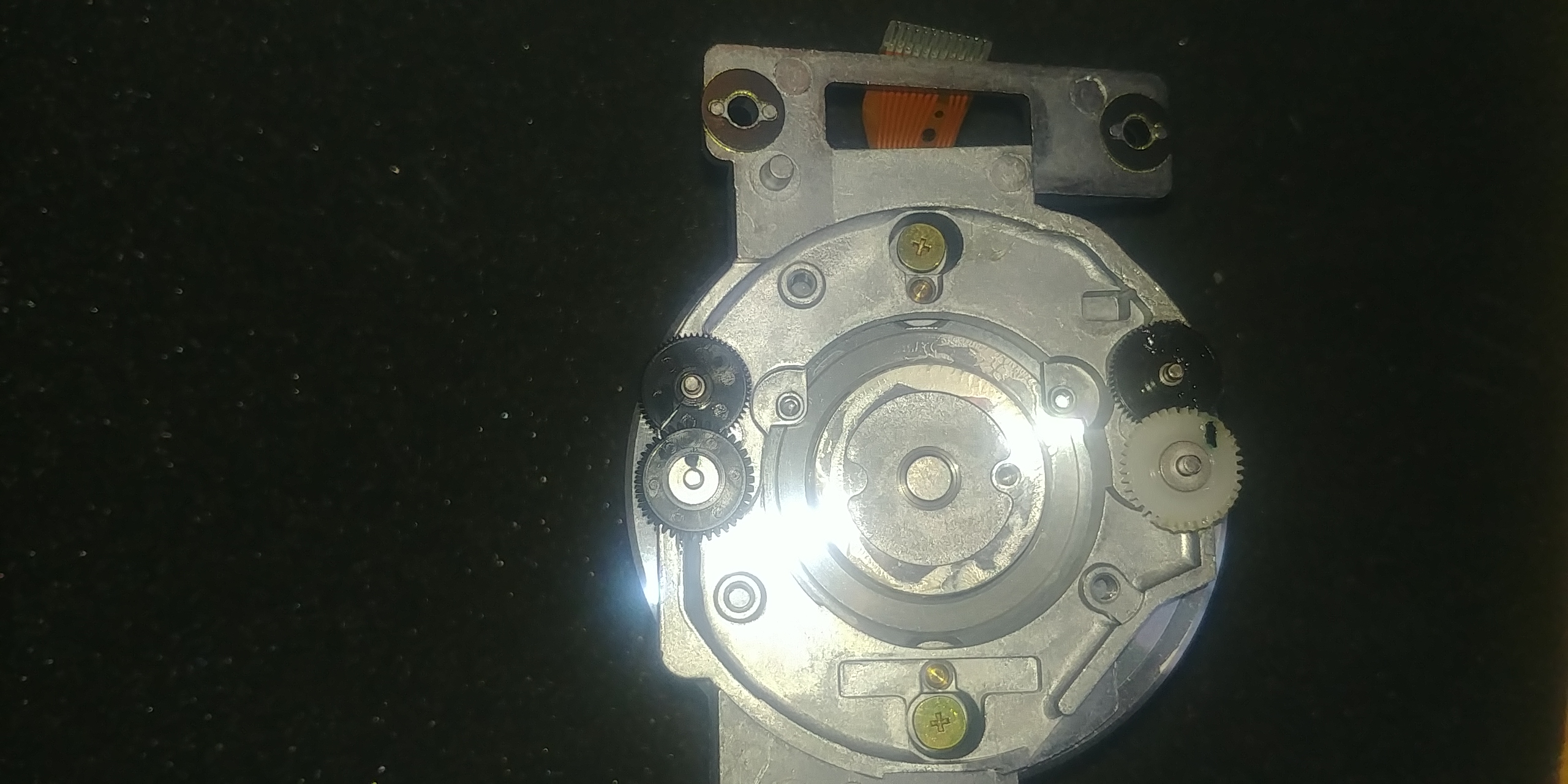

    Removal of gears explained on my video:
    https://youtu.be/w7tVzDlCa9w
    IMPORTANT: Do not unscrew lead ring alignment gears! It will misalign tape path. These two gears must be pulled off without rotating them.
    If you remove the gears for repair, you must place them back in exactly same position as they were. Otherwise DD no longer works properly and there will be noise bars on screen. Only try the alignment, if it is lost due to gear cracking /skipping teeth.

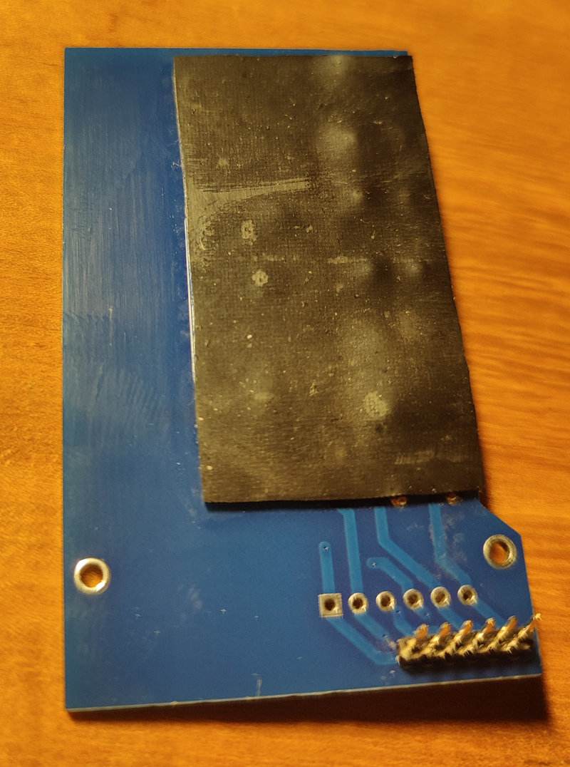

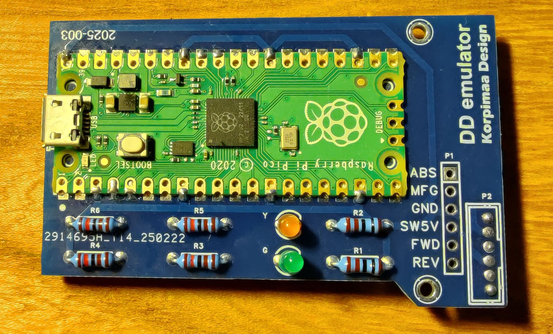

    Dellsam34, I have been listening to feedback from users. Now since last week I have new revision DD emulator PCB (pictures below), that has slightly modified shape (notch in corner) and mounting positions for 6 x 2.0mm pin header, that mounts directly to main board socket CN3501. It now fits under the head drum without contact to mechanism. ( This solution only, when original DD gearbox removed.). It also has the original 6 x 2.54mm mounting position for ribbon cable. New feature 2 screw holes for mounting if connected remote with ribbon cable. Direct mounting underneath head drum requires no fixing.
    Now, that it's available without ribbon cable, the price is lower: USD 63 + USD 10 shipping (most countries). Ribbon cable adds USD 15.

  12. Some unexpected development:yesterday i did shut down/disconnect from the mains,today nothing. Had to go back to them gears again (black:8 turns, white 7). motor shaft in the right position also. Everything works fine even after a disconnect. Also i did unscrew back the two spring-screws. Had to adjust P2 guide again aswell
    Here is the rocket science
    **See you later emulaters**

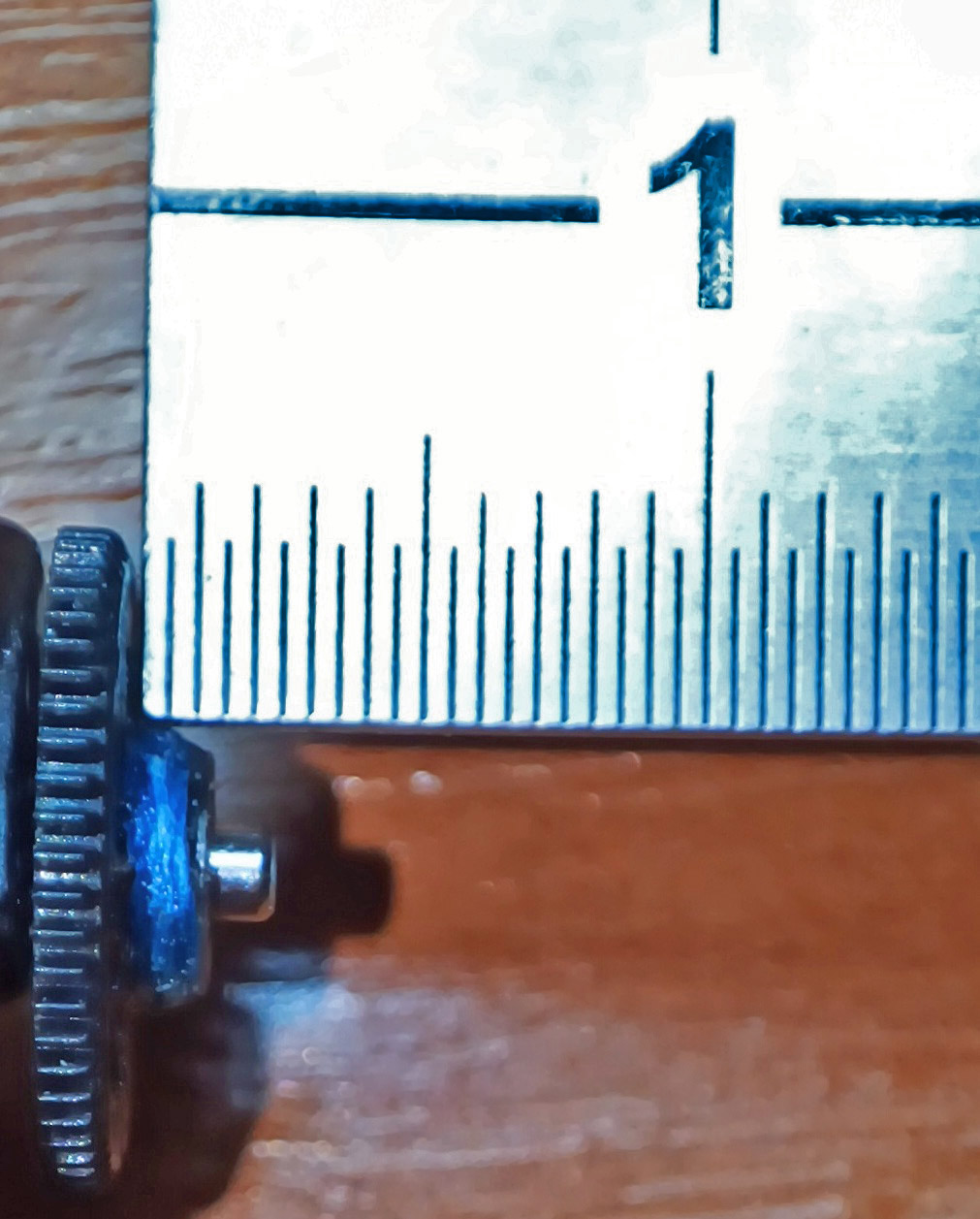

    I'm interested in this distance...
    How many mm can it be?
    [Attachment 86265 - Click to enlarge]
  21. Originally Posted by TOM11 View Post
    Do you think this item?:
    https://www.ebay.com/itm/326193312552
    Approximately 1,2...1,4 mm
