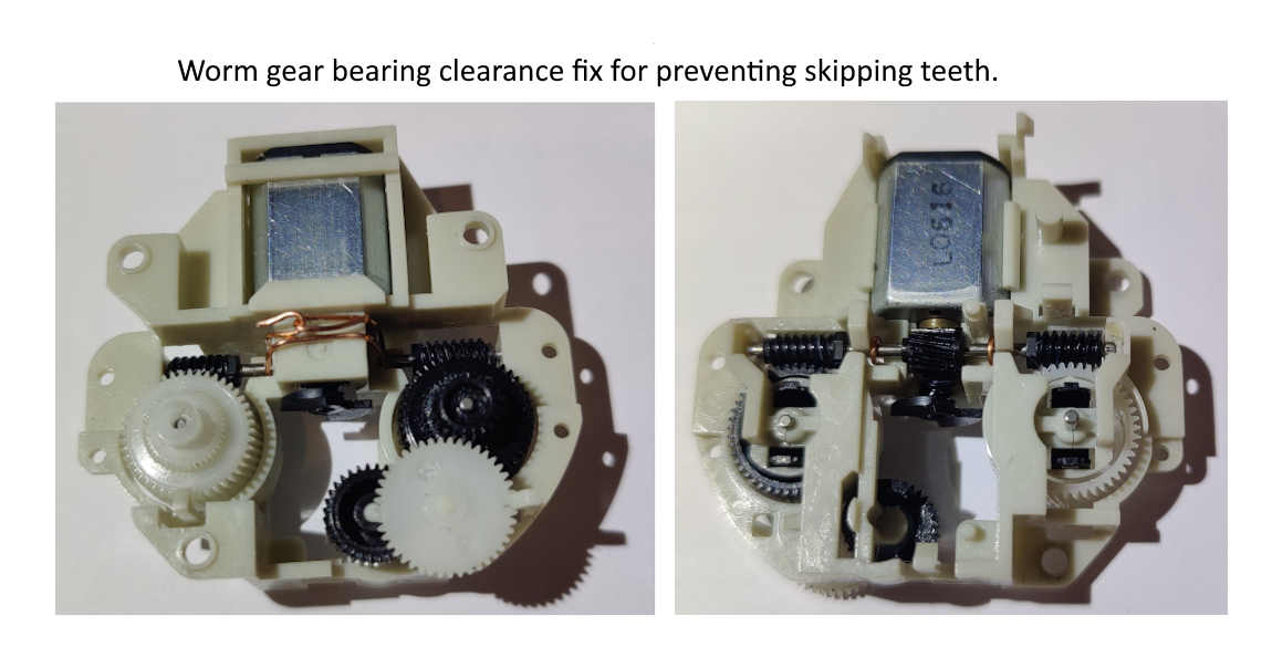

    I have the same experience. I have called them thumb gears because they don't appear to serve any purpose, but actually the axle of these fine gears have friction fit to tape path alignment screw inside drum. For the gear on Aristarhos' foto I have one tip: Try welding it. I have welded my gears using small soldering iron with sharp tip. Press cracked parts together and close the crack by melting. I's not so easy, but possible. If you have not welded nylon before, practice it by welding zip ties (also nylon) and find suitable temperature, that melts, but does not burn the plastics. The axle fit of these gears should not slip and may require super glue.
    In my DD gearbox also the worm drive started to skip gears. The spiral gears did not show visual cracks, but the axle was sitting too loose and was a bit noisy under load. The picture below illustrates how I fixed it with a wire.
    [Attachment 85316 - Click to enlarge]
  2. Originally Posted by hkorpim View Post

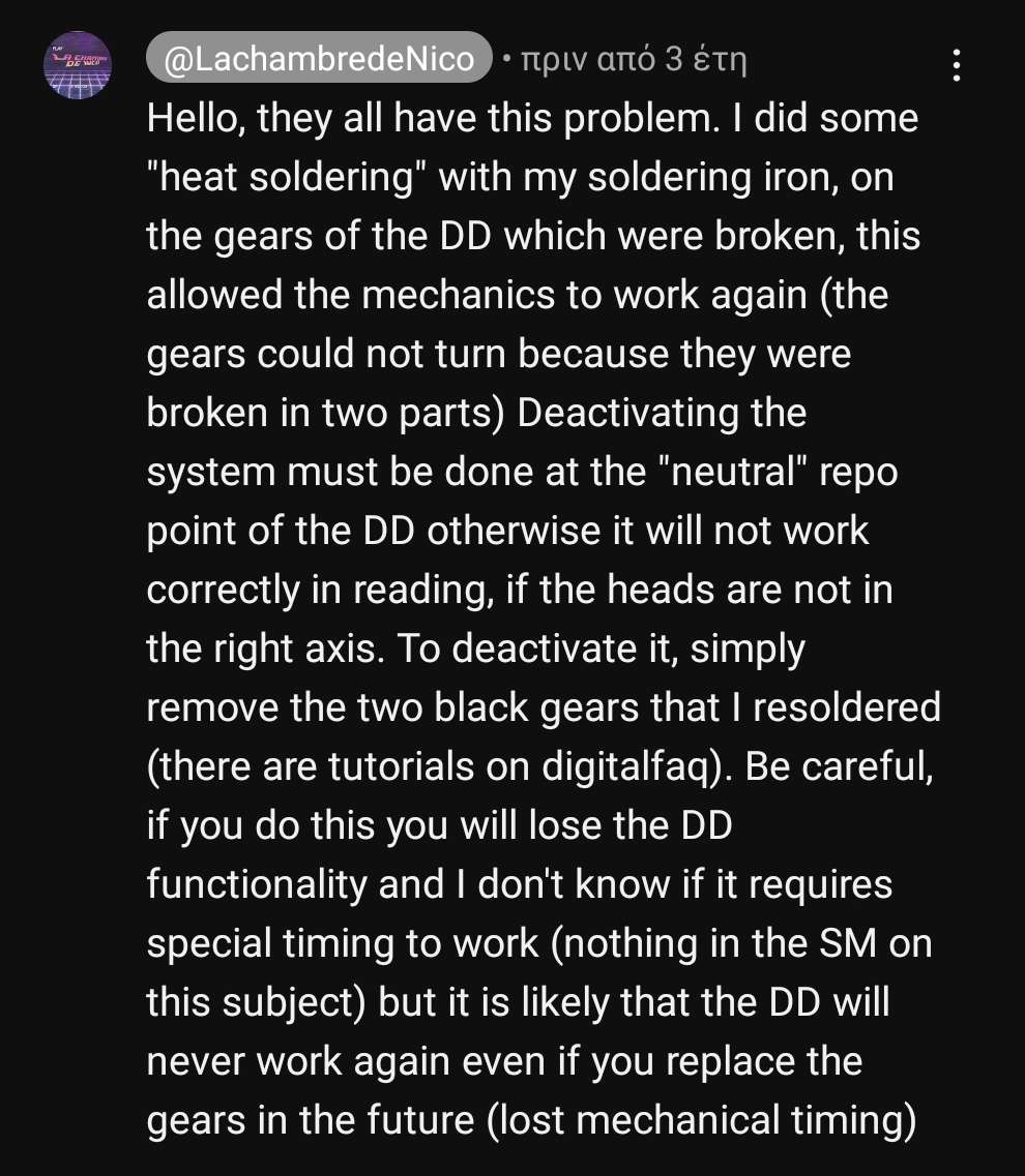

    Thank you for your tip on welding the plastic gear. I haven't tried it because i haven't practiced on other nylon parts to find the right temperature. It is a one shot fix and if it goes wrong you end up with gears burned beyond repair. On YouTube there is a French guy who claims he had fixed the split gears with a soldering gun.
    Here is his video.
    https://youtu.be/zcajJJoUOk4
    Unfortunately he didn't record the repair of the plastic gears, i don't speak french and the auto translation is bad. Also English is not my native language so bear with me.

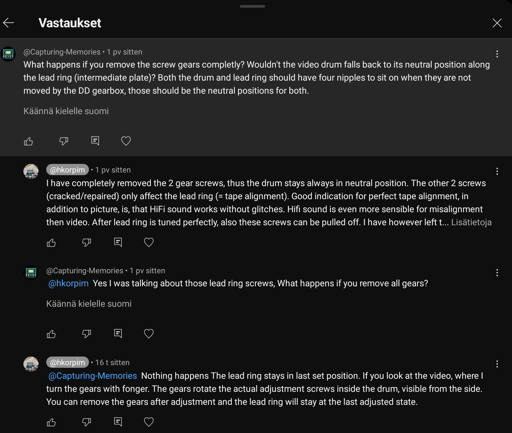

    This French guy also read this thread. Someone asked him how he fixed it and he replied he used a soldering iron.

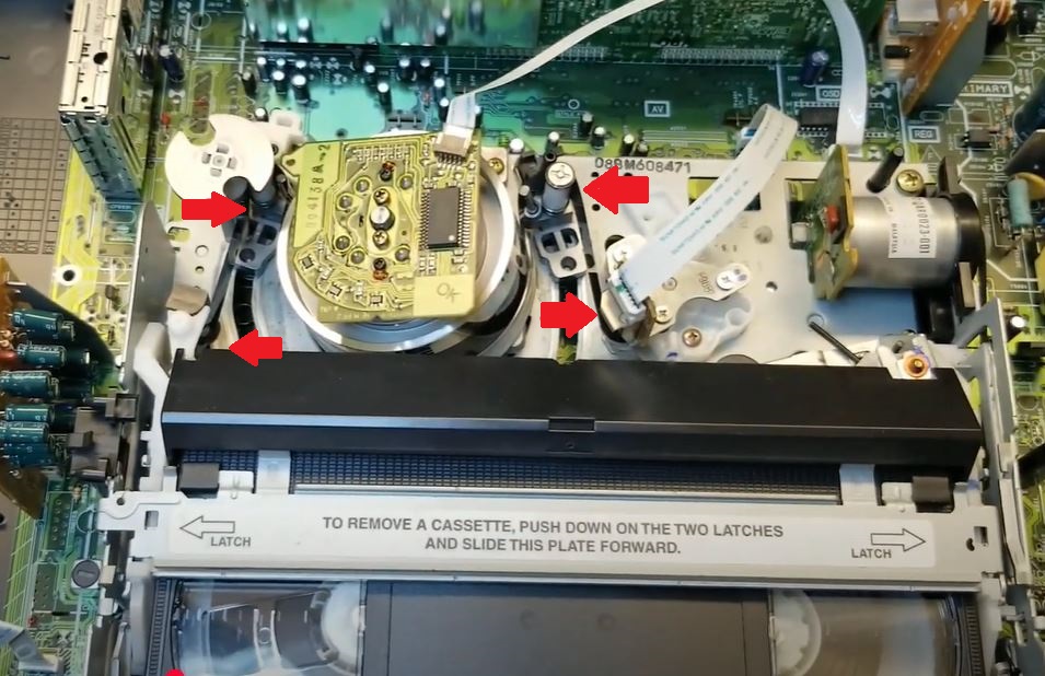

  4. Thank you for taking the time to make such a detailed video.
    Just a remark. Using pliers to remove the flat cable from the head drum is dangerous. One wrong move and it will tear. I've had it happen to me, that's why I'm pointing it out. I don't know if there is a safer way to remove it without excessive pull upwards.
    Jan 2025
    Tampere Finland
    Excellent point, Aristarhos! I should have made a note on this. I have put plastic cover on the round tips of my pliers made of heat-shrink tubing. A thin rubber tube would be even better. Anyway it must be soft against ribbon cable and with sufficent friction. I considered this method safer, than using fingers.
    For working on VCRs, I have various spudger-type tool kits, including plastic precision tweezers of various sizes. You can buy these cheap from Amazon (or probably Temu, etc).
    Thanks for pointing that out, Aristarhos.
    On one of his prior videos, I pointed out the dangers of adding foam (essentially heat insulation!) to the inside of the VCR.
    hkorpim, please be very careful with your advice. I think you need some feedback on your methods before you post more videos on this. The VCRs are already not working, and many of us don't wish to break it more (or worse, buying your mod = so spending more money + breaking it more!)
    We say this to help you, not "dump on you" as some people seem to think.
    I want to see gear fixed, not ruined more. Nor do I want to see people get their tapes damaged. That's where I'm coming from.

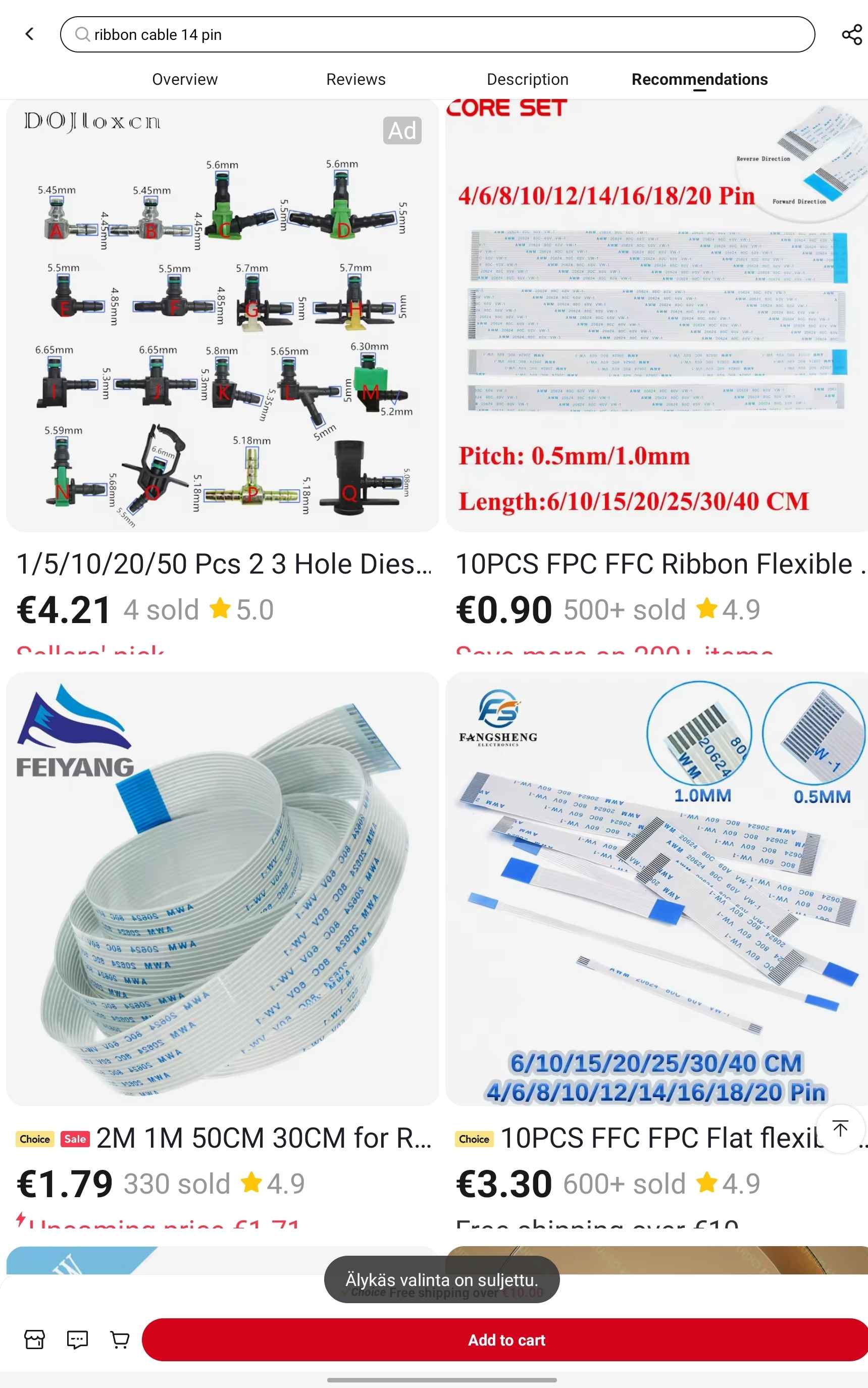

  16. You can find ribbon cables or Flat Flexible Cables in Aliexpress
    https://www.aliexpress.com/w/wholesale-ribbon-cables-fpc-ffc.html

    I will look into Aliexpress link as soon as I get my digital caliper working again to measure the pin pitch, It has a dead coin cell battery, It's always something.
  19. Capturing Memories dellsam34's Avatar
    Jan 2016
    While I'm at it I'm replacing all ribon cables except for the front connectors which I don't need and the AC head which was previously replaced, I will put information here for the JVC HR-S7600AM which should be compatible with most VCRs of the same family:
    The ribbon cables type is called FFC FPC
    Pitch is 1.25mm, connector width is 0.8mm but they don't seem to mention this, maybe the track spacing is standard.
    - Jog shuttle wheel: 14pin, 14cm long like this.
    - Video Head Motor: 5pin, 18cm long, Not sure if this is reversed or straight since I no longer have the connector on the stator PCB, I'm getting this connector and going with a reversed cable like this.
    - TBC to YC board bridge cable: 7pin, 8cm long, this is hard to find in this configuration so I will get any pin and trim it down to 7pin, like this.

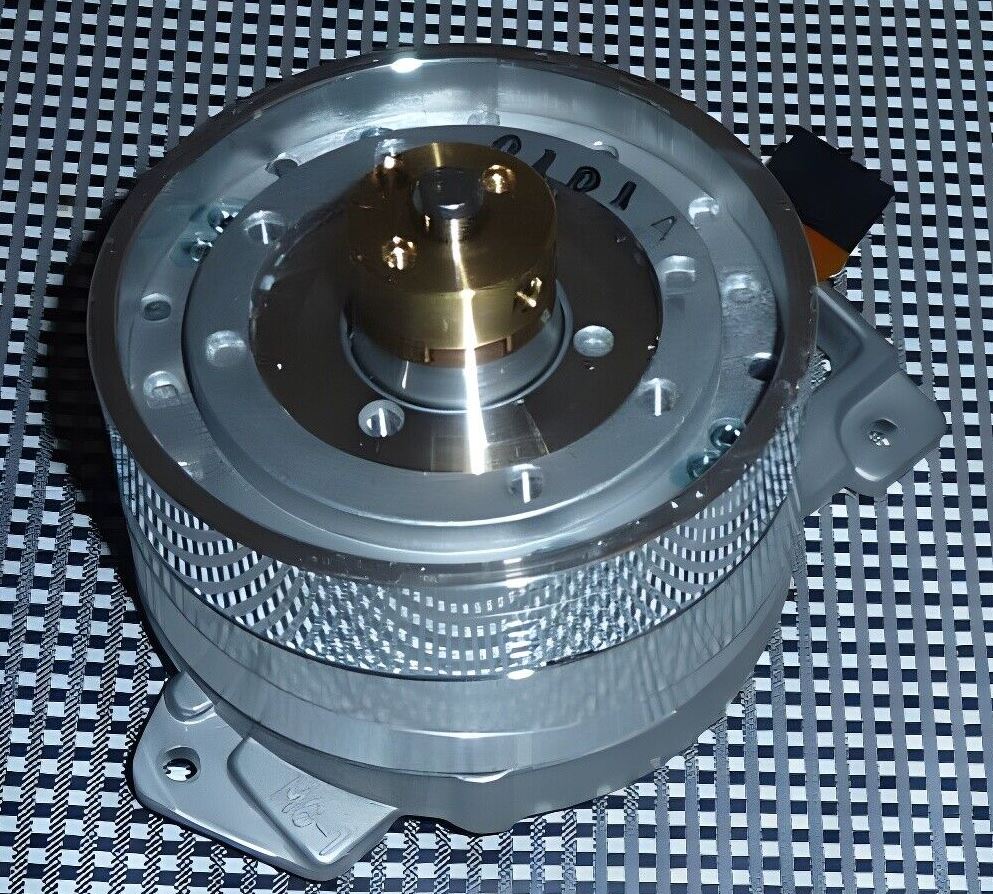

  20. In Europe JVC released this model as HR-S7600EU and it does not have a dynamic drum. I have two devices of this model.
Name:	JVC HR-S7600EU.jpg
  21. Capturing Memories dellsam34's Avatar
    Jan 2016
    If you can pop the cover and take some pictures that would help tracking down some candidate heads to replace the DD heads now that we have a way to disable the electronics, I believe this head LP20617-006A JVC DRUM SUB ASSY with 2SP, 2LP, 2HiFi and FE heads should replace high end models with the DD system.
  22. I will post some pictures as soon as i can.

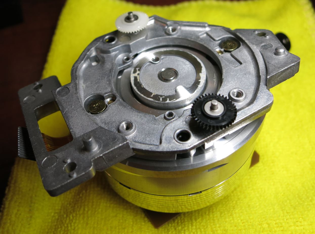

    The chassi plates of the two drums seem to have the same size and the three srew holes of the base seem to be in the same place.
    But i suspect that the height is differnet because the drum with the DD system has an intermediate plate with the spring loaded srews.
    So if a swap is possible, probably it will need serious tape path alignment to the input and output posts and the head that reads the pulses to find the posistion of the video. The last pisture is from a JVC HR-S7600U.
    1st Photo: LP20617-001A JVC DRUM SUB ASSY 483569127311
    2nd Photo: Dynamic Drum
    3rd photo: JVC HR-S7600U
    EDIT:
    Here is a video showing the inside of a european JVC HR-S7600 without dynamic drum
    https://www.youtube.com/watch?v=s1YJYaLuWRM

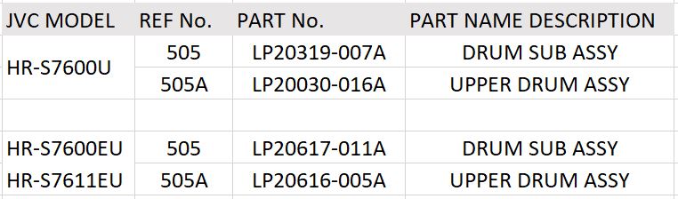

  24. According to the service manuals of HR-S7600U and HR-S7600EU, these are the part numbers of lower and upper drum assy.
    HTML Code:
    JVC MODEL	REF No.	PART No.	PART NAME DESCRIPTION
    HR-S7600U	505	LP20319-007A	DRUM SUB ASSY
    	        505A	LP20030-016A	UPPER DRUM ASSY
    HR-S7600EU	505	LP20617-011A	DRUM SUB ASSY
    	        505A	LP20616-005A	UPPER DRUM ASSY
    HR-S7611EU must be the black color model of the silver HR-S7600EU.
