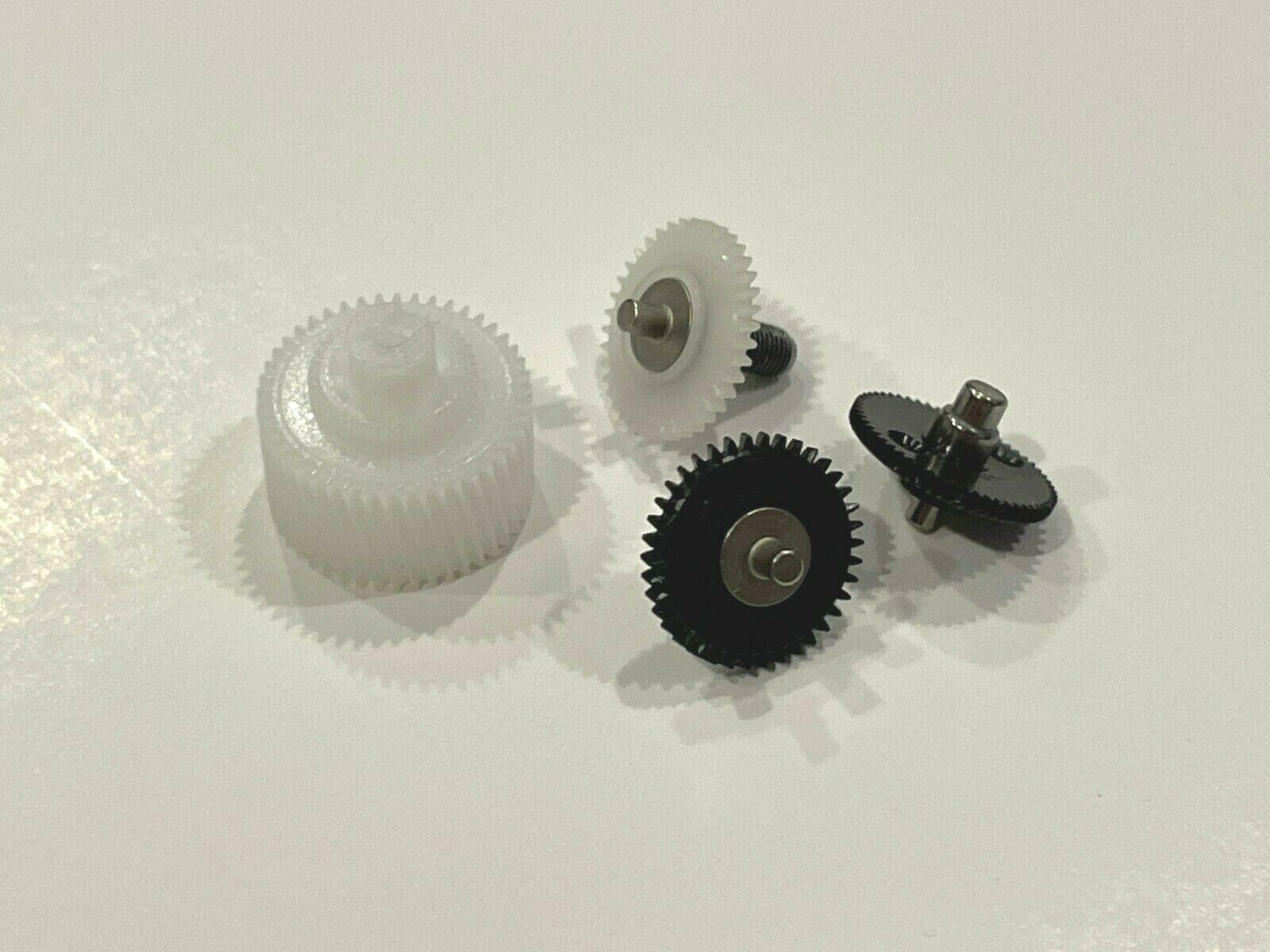

    There is a chap on eBay who 3D print the upper gears and selling them for $350 a set, just to make the mechanical bypass work as outlined in this thread's original post, The small gears with metal core are not easy to reproduce with a FDM printer due to the brittlness of the plastic when put over the metal shaft. A company may charge you an arm and leg for that but you can give it a shot, I'm not too optimistic about the whole 3D print concept, it may not last as long as the original gears.
    We should be gratfull for this DD emulator that came to reality, We've been dreaming about it for years, So far it is the best fix.
    Yes i'm aware of that seller on ebay. I assume he's selling the complete service of the machine and not just the gears. You have to send him your device and he fixes it.
    His listing says "Expert Service - JVC VCR VHS Dynamic Drum Disabling Service **3D Printed Gears**"

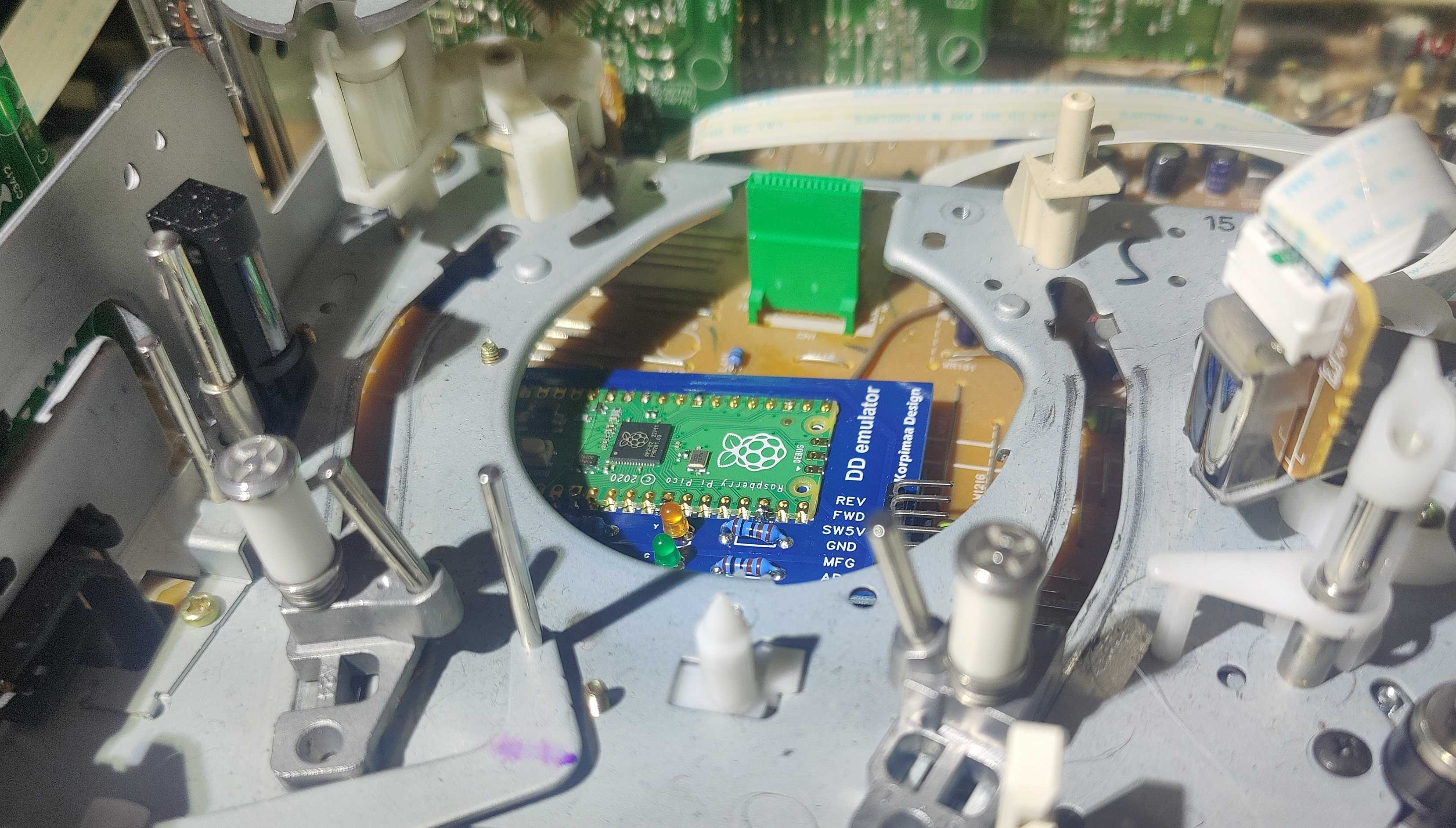

    In my long message yesterday, I said, that 'DD emulator' could be mounted directly to main board socket CN3501. I made rough feasibility study of available space and it looks OK. This applies to my HR-S9700, but I think (?) other models don't differ much on that location. The current pin header in 'DD emulator' is 6 pins / 2.54mm pitch. CN3501 requires 6 pins / 2.00mm pitch. On next revision of PCB I will add this direct mounting option. I also need to reverse order of terminals REV/FWD/SW5V/GND/MFG/ABS. For direct mounting ribbon cable is no longer needed. See below foto of 'DD emulator' placement under video head drum. Disadvantage of this mounting option is, that it will occupy the space of DD gearbox.
    For next revision of PCB I will also revise the technical installation document with proper advice for fixing e.g. with zip ties.
    [Attachment 85283 - Click to enlarge]
    First 'DD emulator' to U.S. was posted today to dellsam34. Transportation will take 4... 7 days.

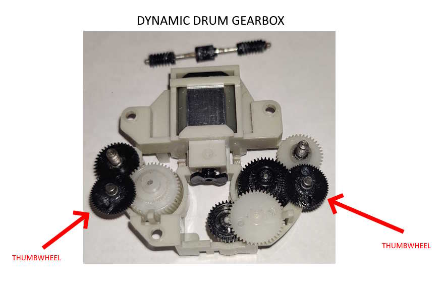

    Alex9876 asked today how to adjust the mechanism after replacing the gears (or after disassembly...). I have one hint, which is shown in picture below. The 2 outer gear don't seem to serve any purpose, but they are actually thubwheels for adjustment. First screw the screwgear into video head drum, but not so tight, that either of the screws starts to tilt the drum - Leave some clearance for adjustment in next step. Secondly mount the gearbox to video head drum with 3 screws, but without SENSOR PCB and without the worm gear axle. Play a tape and when playing tape, if the picture is misaligned or scrambled, turn from one of the thumb screws (that rotates the gear screw) trying to find good picture = neutral position of video drum. If one thumb screw doesn't find alignment/good picture, turn the other one opposite side. After alignment is OK, adjust the other thumbscrew so, that it will just touch the drum with zero clearance, but not forcing it. After done, screw off video head drum, snap the worm axle in, clip on sensor PCB, solder motor wires and screw it back to deck.
    For this method there is only one problem: the VCR shuts off after 3 seconds. You can only make this setting with DD emulator connected on a running VCR.
    If you don't have ways to prevent shut off, you can try with trial and error: very gently manually screw the gear screws in, for zero or very very small clearance without forcing any tilt. Adjust DD gearbox gear alignment as described in my technical document "JVC Dynamic Drum gearbox" features and settings", that can be found from this thread. After that mount the DD gearbox fully assembled including sensor PCB to deck. With some luck, it should work properly.
    [Attachment 85284 - Click to enlarge]

    One more thing to supplement my previous message regarding the drum alignment adjustment: Do not rotate the 'thumbwheels' when the gearbox is removed. They have friction contact to adjusts the tape path, so only rotate them after the screw gears are set correctly and the gears and gearbox are mounted. If picture is perfect, better not to touch any of these 4 gears and if you need to remove the gear screws, record their position i.e. how many turns out, when screwing them off. If you remove the thumbscrews, just pull them off without rotating them.

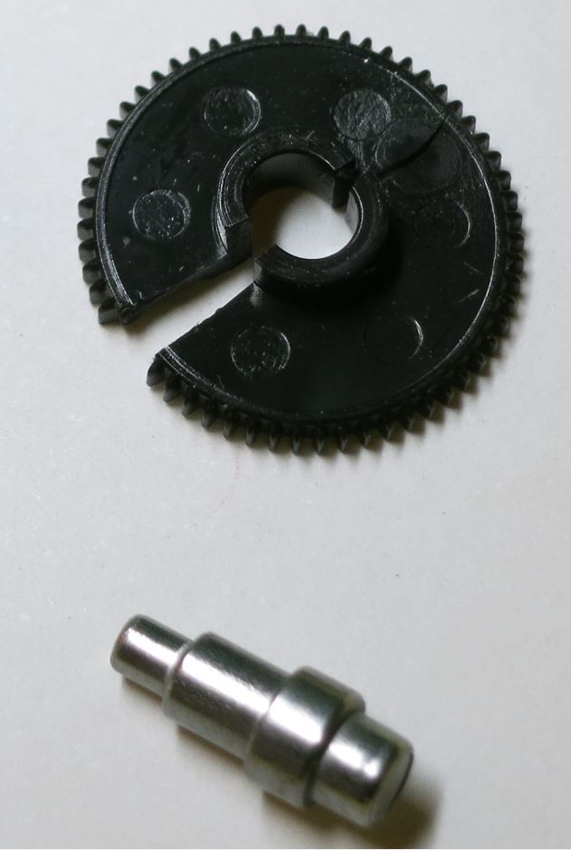

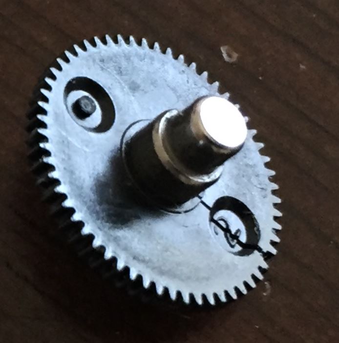

  18. I decided to share with you the story of how I restored the Dynamic Drum mechanism. Please be lenient with my methods, I must admit I am not a mechanic. But this is my first attempt. Here is the link to the file.
    https://docs.google.com/document/d/1oTRx1onKzR8mEepGSTyVwVkw9LwGxveJX_0tAwIrwRo/edit?usp=sharing
  19. Originally Posted by Alex9876 View Post
    Thank you Alex9876. As far as I'm concerned, your effort is very much appreciated.

    Thanks for sharing the repair procedure of the cracked gear. One question, Wouldn't be easier to rim the hole of the plastic gear than filing the metal shaft with sanding paper?

    Hi! It seems to me that the inner bore of the pinion is harder to reduce evenly than the shaft. But it is also an option.

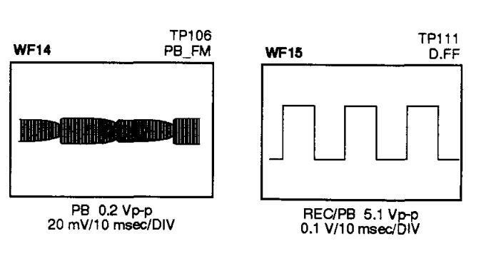

  25. In case anyone is interested, from the Service Manual this is the prosedure to preset the dynamic drum.
    Needed equipment are an Oscilloscope, an Alignment tape [MHPE-L] with Stairstep signal (color bars?), a preseting remote control unit [PTU94008] wich apparently is impossible to find. Measurement on test points: point •TP106 (PB FM) and Trigger slope (+) •TP111 (DRUM FF)
    "Connect the oscilloscope to TP106(PB FM/COL) of the main board assembly and to TP11(KD.FF) of the main board assembly for external sync connection."
    From the manual of the PTU94008 pressing keys M+D or M+E triggers the Dynamic Drum or the Head Switch point.
    Maybe pressing keys M+D control the motor of the DD gears and tilts the head to adjust the initial position.
    Image Attached Thumbnails jvc_presetter_remotes_ptu94023b_ptu94008_manual.pdf
