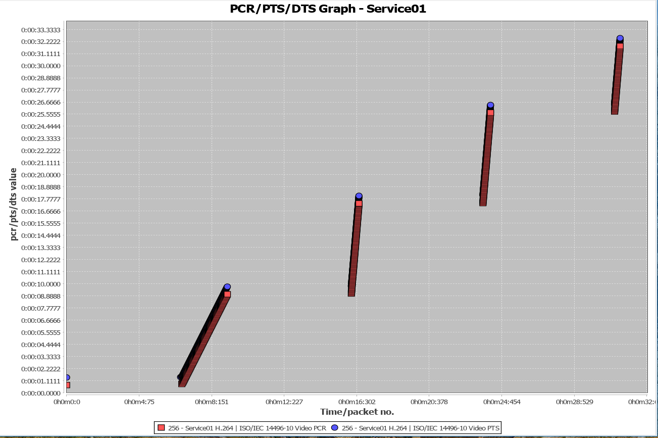

Non-expert looking for help converting a transport stream file that has funky timing into a transport stream that will pass TR 101 290 timing requirements. I have some experience with FFMPEG, but not a deep understanding.
This is the file I have:
[Attachment 49284 - Click to enlarge]
[Attachment 49285 - Click to enlarge]

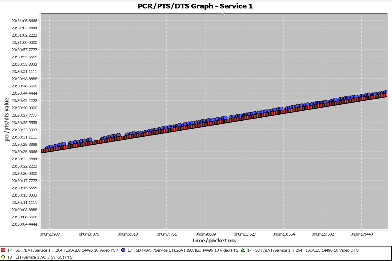

And this is a the type of timing I am looking for:
[Attachment 49286 - Click to enlarge]

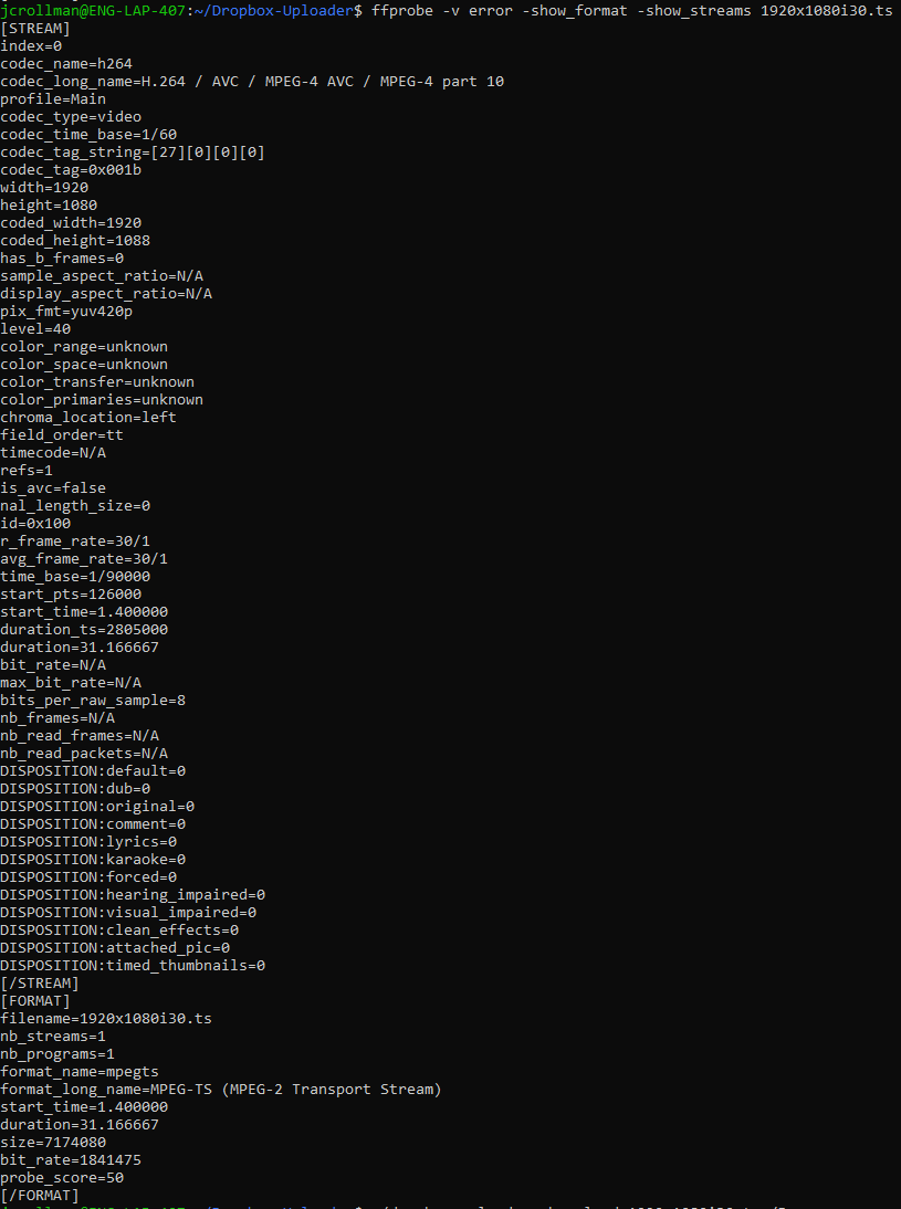

I've been toying with settb and setpts with commands similar to this:
but I really don't know what I am doing. Take the numbers with a grain of salt - that is me trying to figure out what the numbers mean.ffmpeg -y -i 1920x1080.avi -flags +ildct+ilme -framerate 30 -c:v h264 -pix_fmt yuv420p -filter:v "settb=1/90K, setpts=(RTCTIME-RTCSTART)/90K" -crf 10 -profile:v main -level 4.0 1920x1080i30.ts
