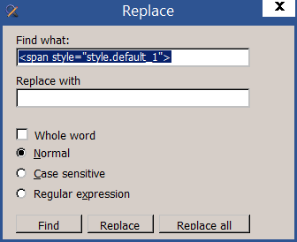

  6. I'm a Super Moderator johns0's Avatar
    canada
    You can add those lines to the multiple replace in the rules section of subtitle so they get added permanently.
