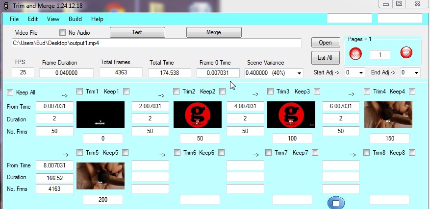

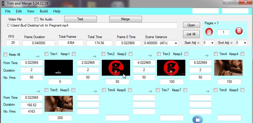

    Ok ... As anyone has learned FFmpeg is a great tool, used by many editors/converter/etc. The only thing is it has some quirks like not cutting at an I-Frame, even if you give it the correct time down to microseconds. For this reason, after much trial and error I use the following method to cut at I-Frame and get frame 0 pts = 0.000000.
    I reference ffmpeg because it is widely used by many cutting/ editing software types. Using a 30 FPS, mp4, avc, 0.033333 Frame duration, with GOP (I-Frames) every 250 frames, You have a key frame at 0 and 0.033333 x 25 = @ 8.33325 seconds. If you try to cut at say 2.00000, and you use an -ss as input option, ffmpeg will seek to the Key frame 0 which is BEFORE the cut time since -ss xxx is BEFORE the -i input. Since it can't play from the non-keyframe, you will get some dead video time roughly 8 seconds long until the next Key frame occurs and it's PTS will be whatever time is is away from the cut point.
    The method I have found that works for me (-copyts and -start_at_zero, and also -seek_timestamp does not for me without recoding), is cut at exactly 2 frames before the key frame you want to cut at. (or more also works up to a point) and use the -ss as an Output option after -i so ffmpeg will seek to the Key frame After the cut time. It will leave a little overhead for some reason I have yet to find searching the internet.
    The following example is a downloaded video starting at time 0.022969 . I find 2/3 of that and use -ss as input option, since ffmpeg cannot seek to a key frame BEFORE because there is only 0.022969 before the key frame and it is not an I-frame.
    Refer to the frame 0 time in the images below and frame 50 image with the little black square just entering into the circle. It stays the same but the Start time gradually gets to 0
    [Attachment 49257 - Click to enlarge]
    0.022969 x 2 / 3 = 0.015312
    ffmpeg -ss 0.015312 -i "C:\Users\Bud\Desktop\oh Im Pregnant.mp4"  -c copy output1.mp4
    This results in frame zero time of 0.007012.
    [Attachment 49258 - Click to enlarge]
    add 0.007012 + Original offset (2/3 of 0.022969 = 0.015312) = 0.022343
    run ffmpeg again same as before but with the new time
    ffmpeg -ss 0.022343 -i "C:\Users\Bud\Desktop\oh Im Pregnant.mp4" -c copy output1.mp4
    Result is frame 0 time of 0.000000
    [Attachment 49259 - Click to enlarge]
    It's cpnvoluted but work for most MP4's that use AVC 264 codec. Other codec require other algorythms.

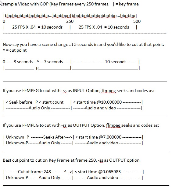

    First let me explain the following information is mainly from FFMPEG as the cutting utility since it is used by so many other editors. FFMPEG is great! but it has many quirks, the main one being it will not recognize a key frame even if you seek to it with 6 places precision. I have never been able to get the No_Accurate_Seek, Start_at_zero or any of the other filters to work without re-encoding or messing up the video.
    Also my findings, after much trial and error with automated scripts, work on MP4 and FLV so far. Not all Start times for all videos need to be 0 and some should not be. What you describe is what you get from a poorly cut (or transmitted) video. I have successfully acquired start times of 0.000000 by cutting 2 frames before I frames and, knowing there is almost always some over head, apply a function to achieve zero.
    I'm sure there are many here that know more than I do, but this has worked for me and I have incorporated into the program i used as an example above. This works when I KNOW there will be a minimal non-zero start time after cutting. If you receive a non-zero video, it may be able to fixed, depending on why the start is not 0.000000, the container type, and other factors.
    There may or may not be video during your blank portion and this is determined by the reported length, Using the example below, if I cut in the wrong place I get:
    1.. A reported 20 second video that plays audio for 10 seconds (frozen screen) and correct video for 10 seconds.
    2. A 10 second video starting in the wrong place.
    3. An 10 second video with a start time of something less than 2 frames duration (Example 0.033333 frame duration yields start time of around 0.065983)
    If you already have a video that is like one of the above, you will have to try several methods to correct it, depending on the container and the codec used to encode it.
    Before everyone here finds fault with my explanation, I would like to point out that everyone knows you have to cut on a key frame or re-encode the portion up to the following key frame from your cut, but if you search high and low for a way to COPY portions of a video, none has worked to achieve a 0.000000 start pts until I for a way to fake it.
    To answer the question of whether there is data before 16 seconds, all i know is many times ffprobe says frame 0 is a 'P' frame when that cannot be without displaying a distorted picture, so there must be more in front of it so there must be an 'I' frame before it somewhere?.
    But why would start time ever be anything but zero for a whole track (excepting small non-zero values to help with syncing audio/video)? I've not found an explanation. And Webm/VP9 structure is entirely different. So internals specific to a particular container/CODEC may not provide a general answer.
    Some containers use a different clock and hardly ever show 0 such as mpeg-ts, others are edited wrong, while others may have been joined wrong.
    Q3: IF a "start" time is significantly away from zero (e.g. 15 seconds), what is in the video track before that start time? Is there always a key frame at 0, making the video from zero to 15s usable but "hidden", or something else? (I'm assuming here that the video hasn't been badly edited with a key frame chopped off the beginning.)
    There may or may not be data that can be recovered. The example below is start time of 7 seconds, which is less that the 250 GOP so there is no data to recover. You should be able to use ffmpeg and -ss as input option 0.000000 and encode this.
    FFmpeg -ss 0.000000 -i video.mp4 -vcodec libx264 -acodec copy -crf 20 Test_Out.mp4
    . If there is anything usable, it should now show up.

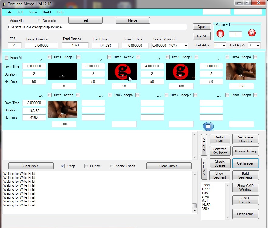

    METHOD for MP4 and FLV (with original start time of 0.000000)
    1. Cut 2 frames before Key frame you wish to cut at using -ss as Output option and -c copy. More may work up to a point. Less will never work. output such as output2.mp4
    2. Obtain Start PTS Output2.mp4 ( @ 0.065983 or other)
    3. Find 2/3 of this (0.048989 may be other.)
    4. Use ffmpeg to cut the output2.mp4 using -ss as input option and -ccopy. obtain output3.mp4
    5. Find Start PTS of Output3.mp4 (0.001001)
    6. Add this to item 3 above (0.048989 + 0.001001 = 0.048990)
    7. Repeat step 4. You will have a Output3.mp4 cut at exactly the key frame with Start PTS of 0.00000
    Variations need to be applied if you already have a messed up video.
    Visual representation:
    [Attachment 49336 - Click to enlarge]
    Image above should say best to cut at Frame 248
