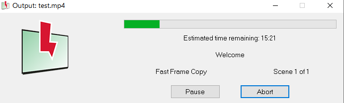

    Sharing an example dialog of a 4min video (cut 2 seconds from end of video)
