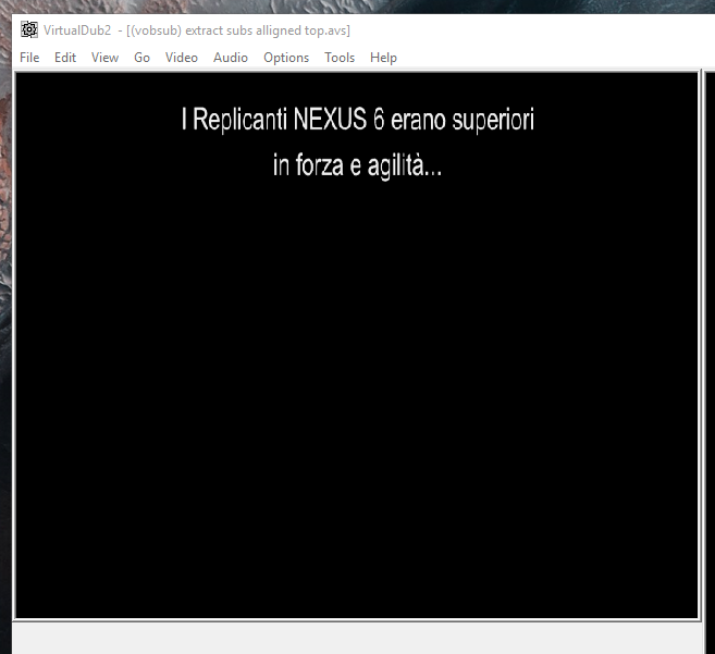

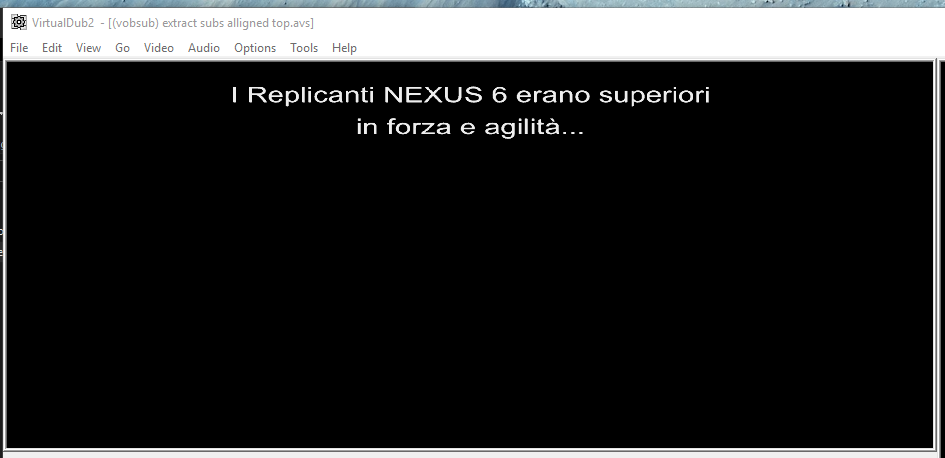

  12. It looks like it scales the subs. The first screenshot is at 720x576, the second at 1920x800 (same as the subs source).
    [Attachment 49275 - Click to enlarge]
    [Attachment 49276 - Click to enlarge]
    Also the output was the same but at the higher resolution took a lot longer to complete. Is it possible to also have a visual output while processing? Like seeing the actual frames with the top aligned subs.
