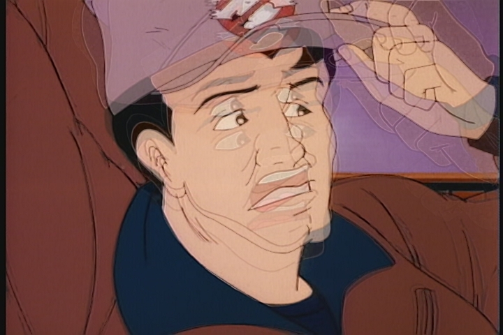

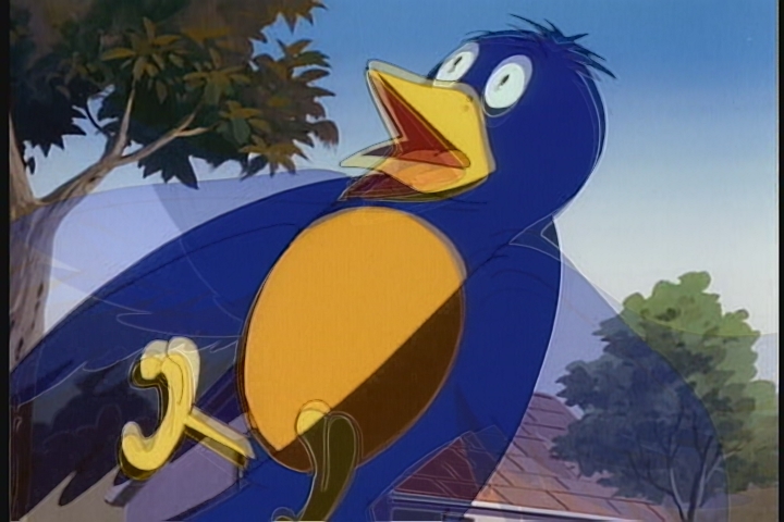

  20. Nothing's changed. Take a look at both images I uploaded, and this is with the Temporaldegrain2 default settings.Image
    [Attachment 49244 - Click to enlarge]
    [Attachment 49245 - Click to enlarge]
    Mar 2008
    Upload some of this source and I'll see what happens in my setup
