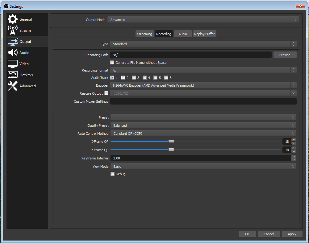

    The fact is that I tried to set different settings, these are the settings of one of the content makers on Fortnight. My computer is powerful. RTX2080, Intel Core I7 8700k, 16GB RAM, 1TB HDD

    Use CQ instead of CBR.

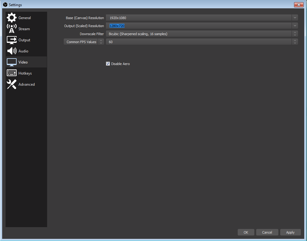

  29. Originally Posted by KarMa View Post
    [Attachment 49239 - Click to enlarge]
    Set output to 1920x1080. It's set to 720p by default.
    I have 1920x1080, in video were shown my video.
