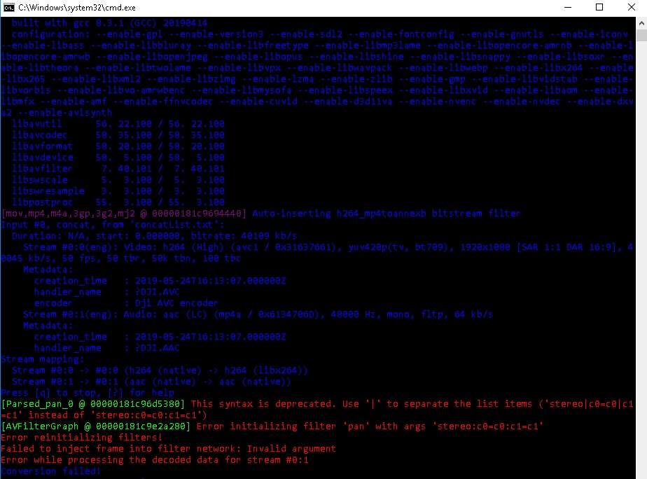

consider input source file1.mp4 and file2.mp4
where file1.mp4 is this: https://www.dropbox.com/s/witu89yucy4vysr/file1.MP4?dl=0
and file2.mp4 is this: https://www.dropbox.com/s/x5hvuc5ufe2c5e2/file2.MP4?dl=0
I would like encode they as concat files (I'm inside a batch routine) so I need to use a commandline like this:
Code:ffmpeg64bit_2019.exe -threads auto -y -f concat -safe 0 -i concatList.txt -pix_fmt yuv420p -c:v libx264 -profile:v main -level:v 4.2 -g 33 -bf 2 -crf 21 -af "pan=stereo:c0=c0:c1=c1,volume=1.0,apad" -c:a aac -b:a 512k -ar 48000 osmo.MP4
where concatList.txt is - in my case -:
and ffmpeg is this (downloaded from zeranoe 28.05.2019) https://www.dropbox.com/s/x5hvuc5ufe2c5e2/file2.MP4?dl=0Code:file 'C:\Users\Administrator\Desktop\marionette 3\file1.MP4' file 'C:\Users\Administrator\Desktop\marionette 3\file2.MP4'
but I get an error
[Attachment 49211 - Click to enlarge]
please can you correct the commandline???
