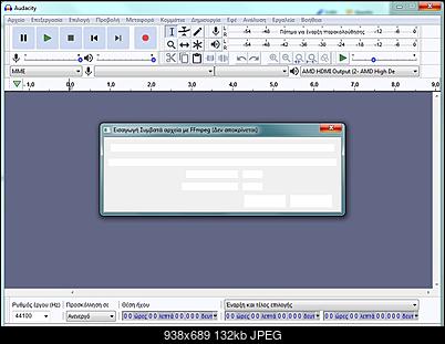

    I download and install audacity but really i don't understand how it work.
    And how i do convertation truehd into ac3 5.1?
    I try it but when i add a sound file it stuck.
    Here is a picture:
Name:	Χωρίς τίτλο.jpg
    Isn't there any program more stable like mkvtoolnix or tsmuxer?
