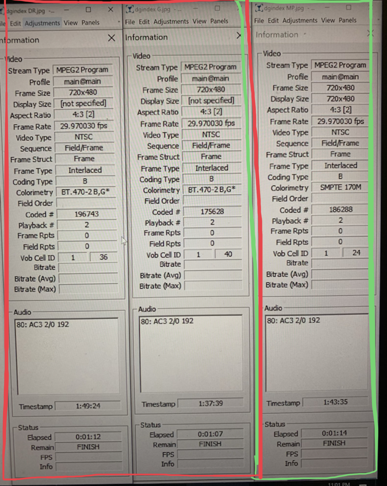

  1. I've been racking my brain trying to figure this out but I'm at a loss. I've been trying to both upscale and interpolate this DVD to convert its framerate from 29.97 to 59.94fps. Instead of the end result being a 59.94fps video with interpolated frames, I get a 59.94fps video with DOUBLED frames. No motion interpolation. By using the same script, I've been able to successfully perform this process on some DVDs, but not others. I've compared the DGIndex logs of one DVD that's worked, and two DVDs that haven't. I can't seem to figure out what is causing this problem. To perform this process, I first created .d2v files from the .vob DVD files, then rendering the video from that. I'm able to tell that I'm getting doubled frames as early as the preview screen in VirtualDub, so the issue lies in either the script or the encoding in the DVDs. I'd greatly appreciate any help.

    Here's the two nonworking .d2v files on the left, then the working one on the right:
    [Attachment 49129 - Click to enlarge]
    I'm probably not posting the necessary info here, but I can provide whatever I need to.

  2. Probably that DVD's actual content is 29.97p , not 29.97i
  3. Is it possible for it to be 29.97p even when the frame type shows up as "interlaced"? In which case, how should I edit the script?
  4. Yes, it's possible. It's common for progressive 29.97fps sources to be encoded as interlaced.
    I have no idea if that's what is really going on, but the doubling you mentioned could easily result from that. My question is, what's your obsession with getting 59.94fps out of it? Before bobbing you should understand what you have and how it should be treated and not just blindly put on a bobber.
    You might post a short sample from the DVD, one with steady motion, 10 seconds or so. Also, your source is already YV12, so you don't need the Convert line in your script.
  5. On DVD the video is stored as fields and is always flagged as interlaced (by the DVD standard), even when the video is progressive. When the video is 29.97p the 2 fields are from the same point in time. QTGMC therefore produces 2 identical pictures, one from the top and one from the "identical" bottom field with no motion in between. QTGMC is a bob-deinterlacer and does not do any temporal motion interpolation. So if your video is 29.97p and you want to produce 59.94i you would have to synthesize the missing field with a temporal interpolator.
