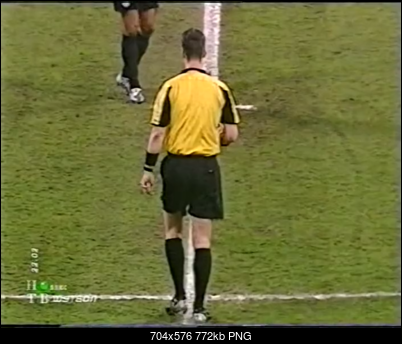

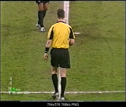

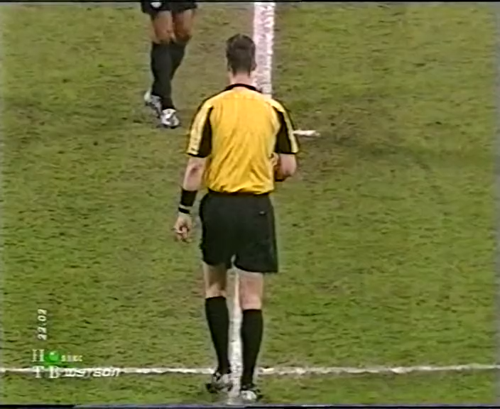

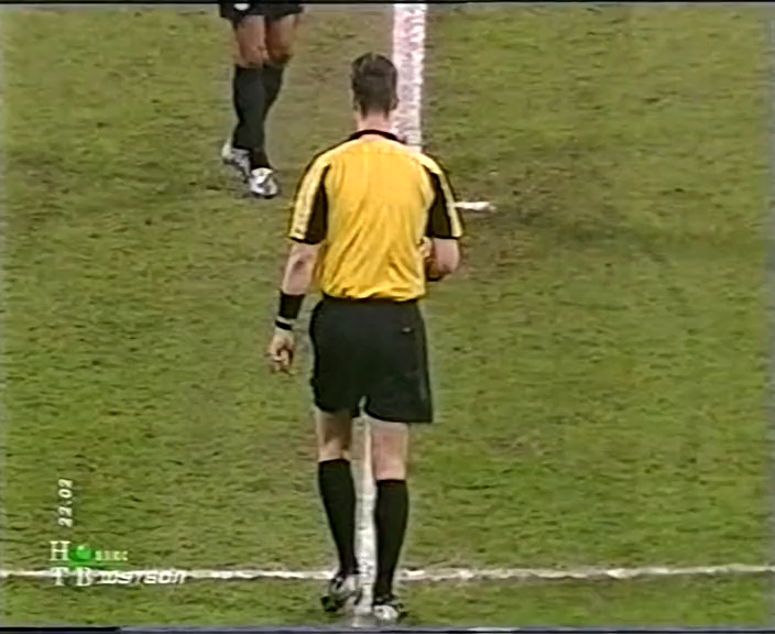

  18. Sorry, first I have to get back to your script... I tried it after adding Deblock_qed_i() function and got different results than the video you uploaded previously. These are the first 2 frames of your (last two) and my (first two) video.

    It's visible on the logo in the bottom left corner of my video that it's different on each 2 separated frames from a field after deinterlacing, so I guess it has something to do with deinterlacing. What could be the problem?
  19. I wouldn't worry about the first few frames of your clip. It has orphaned B frames from an open GOP at the start. Different decoders will do different things with that.
  20. What makes problems is this difference between frames. When I watch your video, there is no flickering. If you take a look on my video you will see how 2 frames from the same field are different in constant details and it creates flickering. It happens all the time, not just with the first few frames.
  21. I downloaded your video in post #14 -- I see the flickering you are talking about. What deinterlacer did you use? Post your the entire script.

  23. There's no way QTGMC(preset="slow") produced those bobbing edges.

  25. No. Try encoding again. Or use VirtualDub to open your script and step through frame by frame.
  26. Problem solved. I had to update Avisynth and its plugins to the latest version. By the way, what determines the bitrate of the encoded video? I see that its size is ~31 MB in my case, whereas one of the encoded videos uploaded here had the size of ~41 MB using the same encoding settings.
