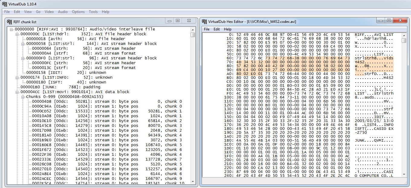

  4. It looks like you don't have much more than the AVI header (at the start of the file). The two videos are both 3 minutes long but the good one is 100x bigger. You can try using VirtualDub's Hex Editor (Tools -> Hex Editor) and its RIFF Chunk Tree viewer (Edit -> Riff Chunk Tree) to see there are any video packets (sample below). I suspect not.
    [Attachment 49085 - Click to enlarge]
    On the left is the RIFF Chunk Tree. In the bottom half of the list are a few of the audio and video chunks. Your 3 minute, 11 fps video should have thousands of chunks.
    Given the the file is so severely truncated you won't be able to recover much. Imagine a 300 page book where you have only the first 3 pages. You may have the title page and the table of contents. There's no way you can restore the body of the book from that.

  9. That means the file is too damaged for VirtualDub's RIFF Chuck Tree tool to analyze. You can try parsing/searching the hex data manually (you can see the RIFF chunks, identified by fourcc codes, in the image I posted). The video chunks are identified by the fourcc (plain text) "00dc", audio chunks by "01wb".

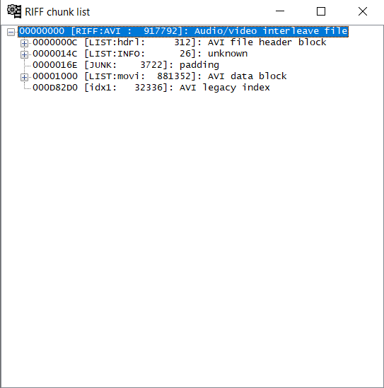

  14. Junk chunks are normal. Pretty much every AVI file has them. They are used as padding to align later data. Notice how the movi chunk immediately after it starts at address 00001000. But the video chunks is very small, only about 4000 bytes (1035 hex), very small for a 1080p video. I suspect there's nothing there.
