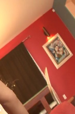

Okay I've managed to catch a frame that highlights the problem. Here hopefully you can see the jagged lines that, I believe, are the result of a filter, probably deinterlacing, that was applied to the source before authoring. -
It's hard to say from just that image. There's no combing, just aliasing. Try an antialiaser like Santiag() or AAA(), followed with a very mild aWarpSharp() to resharpen. Or maybe QTGMC(InputType=2) or 3.

You're right it's more aliasing than combing, my bad. I wonder how it was introduced in the video.
I've tried running Santiag, which is giving fairly good results but aWarpSharp seems more destructive than it is worth. Did you mean running QTGMC *after* Santiag or as a replacement? -
No, I meant to try using QTGMC(InputType=2) instead of Santiag(). That setting is meant to clean up bad deinterlacing. But I don't think that's really the problem. It looks to me like the video may have been downscaled with a nearest neighbor filter.
