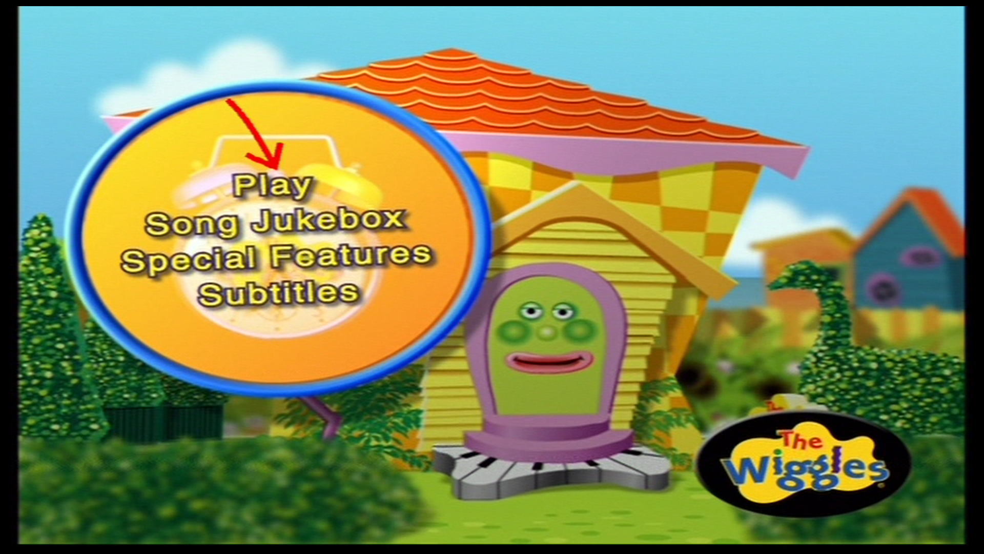

  4. Not an blurry edge. I am talking about videos with black borders. There are some videos that have slight artifact at the clear edge of the video with black borders. Are there any ways to make it look clean after cropping out all black borders? Here's the example. Look at the left side. Image
    [Attachment 49540 - Click to enlarge]

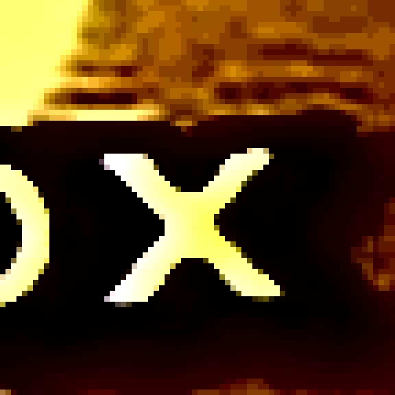

  5. I see ringing artifacts. For example, in this contrast stretched 8x enlargement of the area around the letter x in the word jukebox:
    [Attachment 49541 - Click to enlarge]
    Is that what you are talking about? Some of it i scaused by compression, some caused by scaling SD to HD, possibly other causes like sharpening filters, etc. There are some filters designed to alleviate them but they can be very damaging to the picture. Is that from your source or is that after you processed it?

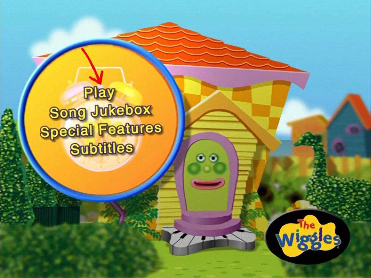

  7. You can reduce the first generation halos with AviSynth and FineDehalo(rx=1, ry=3):
    [Attachment 49542 - Click to enlarge]
    The video also needs to have the chroma better aligned with the luma, ChromaShiftSP(x=2.0, y=1.0):
    [Attachment 49543 - Click to enlarge]

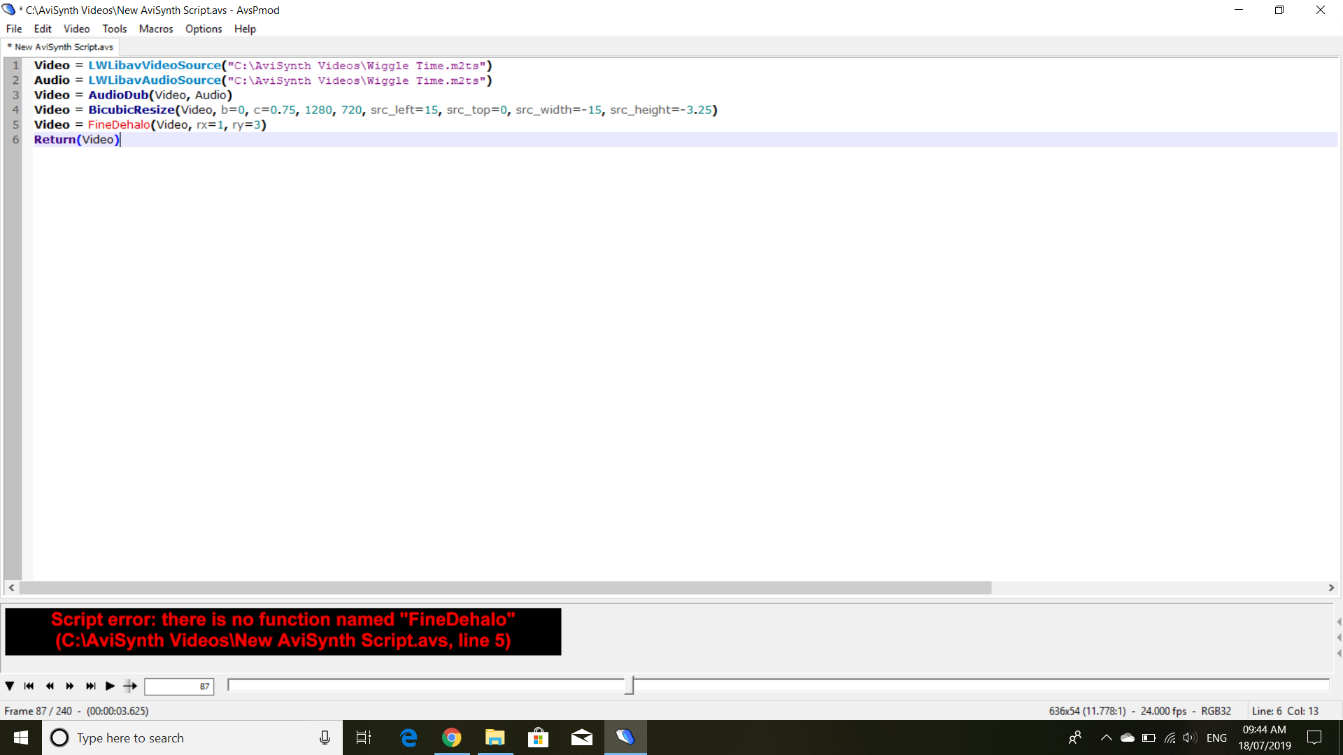

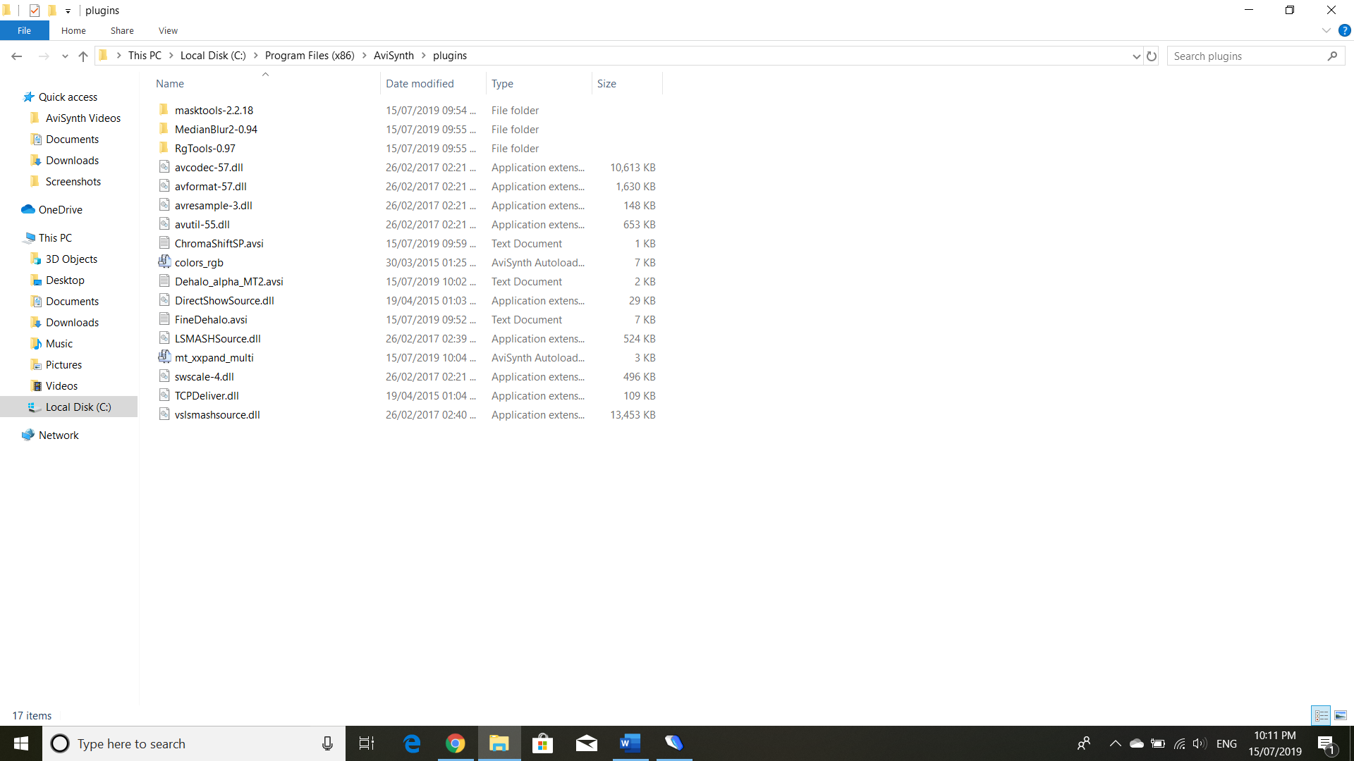

  9. I've download FineDehalo and ChromaShiftSP files, but they are both in avsi format. I've put all of those contents into AviSynth Plugin and SysWOW64 folders, but filters still don't work. Image
    [Attachment 49547 - Click to enlarge]
  10. Is that the right AviSynth folder? Do you have both 32 bit and 64 bit AviSynth installed? Are you using an editor/converter that uses a private version of AviSynth? MeGUI, for example.
  11. Yes it is. I've downloaded other filters and they work just fine without any problems. I don't know if there's any requirement files missing. Are files supposed to be converted from avsi to dll?

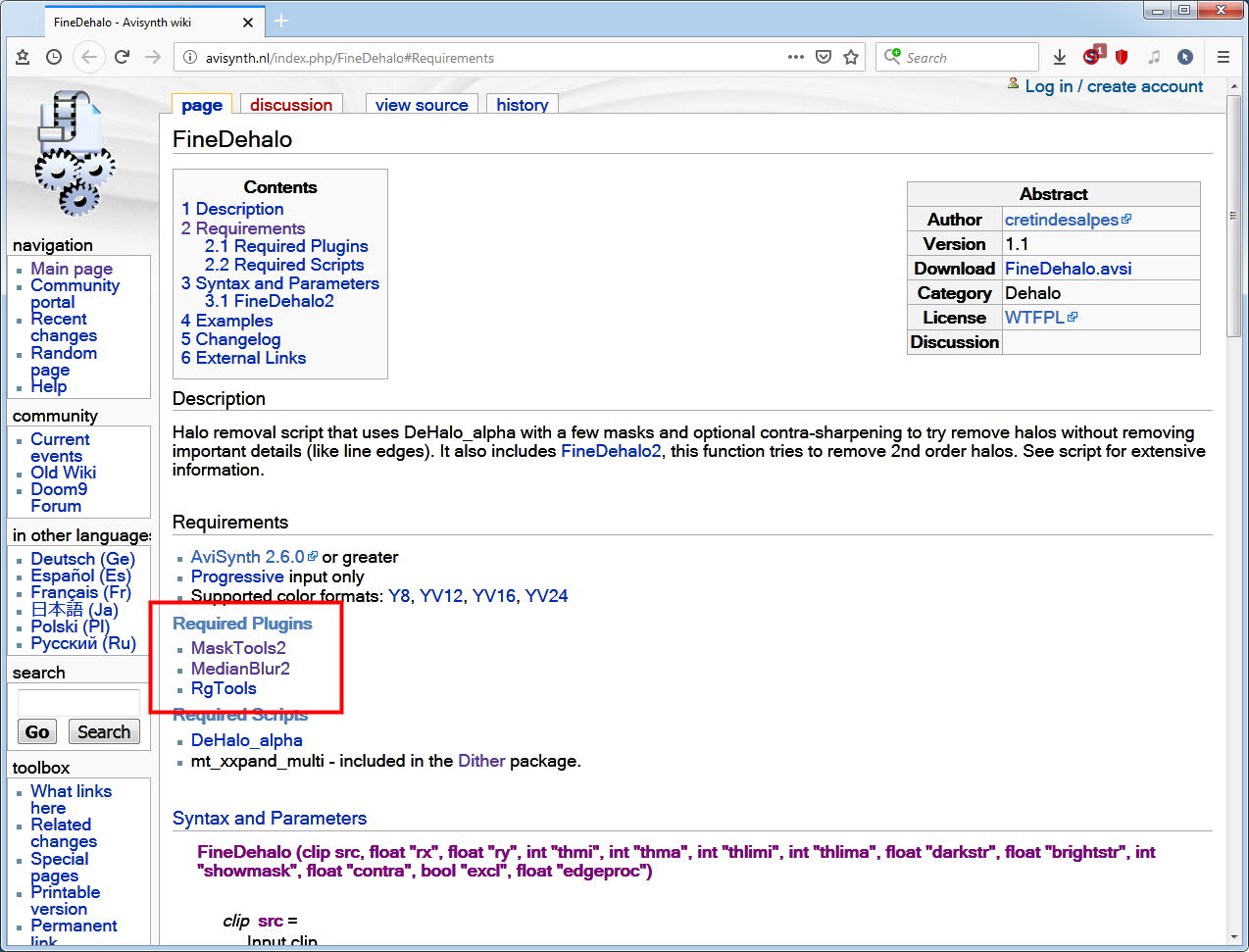

  12. [QUOTE=jseo13579;2555184]I don't know if there's any requirement files missing.
    Why didn't you check when you downloaded the avsi files?
    http://avisynth.nl/index.php/FineDehalo#Requirements
    http://avisynth.nl/index.php/ChromaShiftSP#Requirements

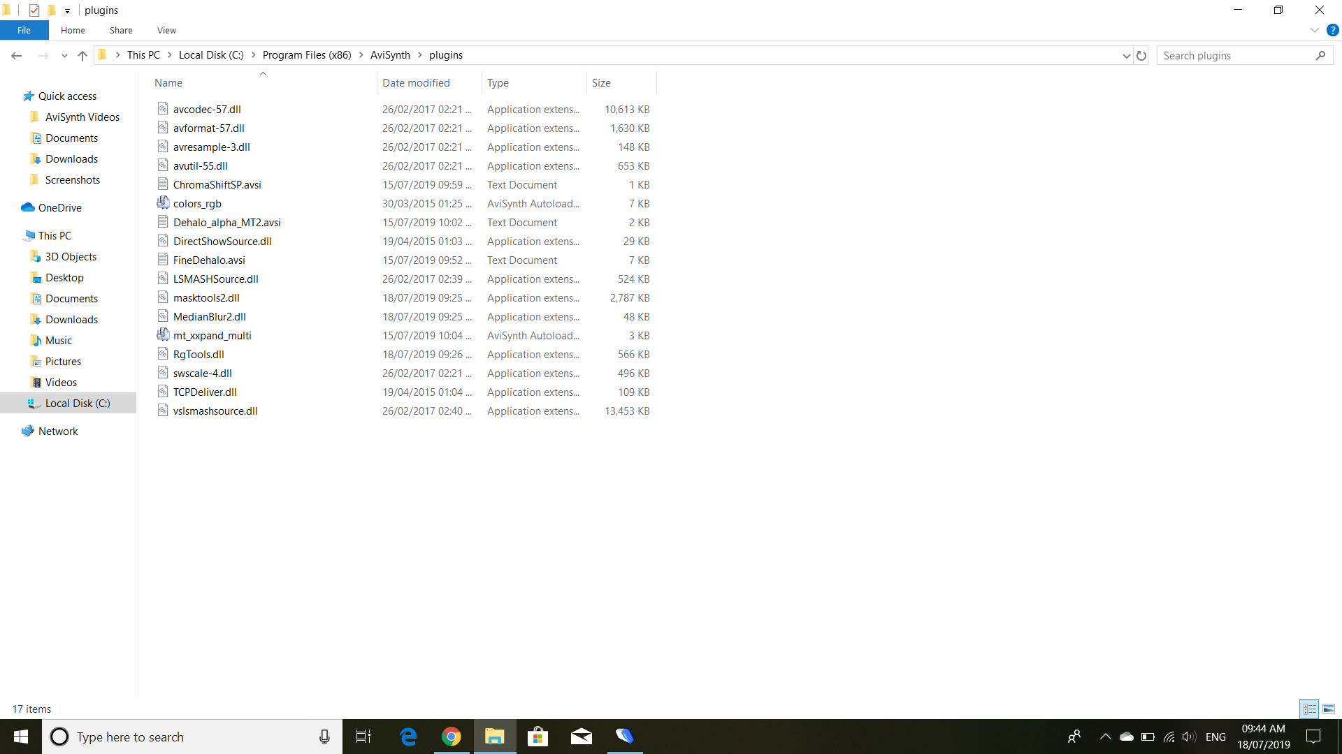

  13. Yes, that's where I got all my files from. There's only avsi file and I've saved it before pasting it into AviSynth Plugin and SysWOW64 folders.
  14. Yeah, I've downloaded those as well. You can see those folders in my AviSynth Plugin file on my screenshot I've posted above.
  15. I see folders, not dll files. AviSynth only looks in the plugins folder, not sub folders from there. You need to put the dll files from those folders into the plugins folder.
  16. I don't understand, but dll files are not included in the download. I've downloaded zip files and none of them include dll files. Where do I get it?

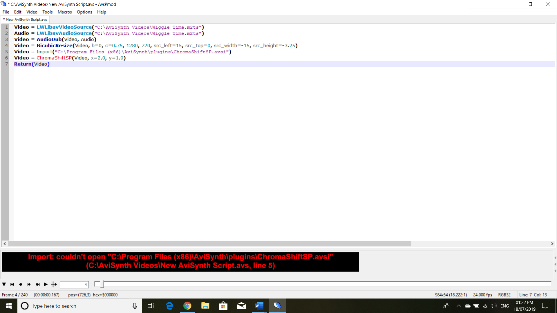

  20. Image
    [Attachment 49579 - Click to enlarge]
    [Attachment 49580 - Click to enlarge]
    . Now I have installed all required files for FineDehalo and ChromaShiftSP, but both of them don't work.
  21. Forget FineDehalo() for now and concentrate on ChromaShiftSP() -- it doesn't have any third party requirements so it's easier to diagnose. Remove the FineDehalo() line from your script and add the ChromaShiftSP() line I gave you earlier. Do you get a "no function named ChromaShiftSP" error when you open the script? If so, import the AVSI manually in your script by adding this line to the top of the script:
    import("C:\Program Files (x86)\AviSynth\plugins\ChromaShiftSP.avsi")
    Do you still get an error message?

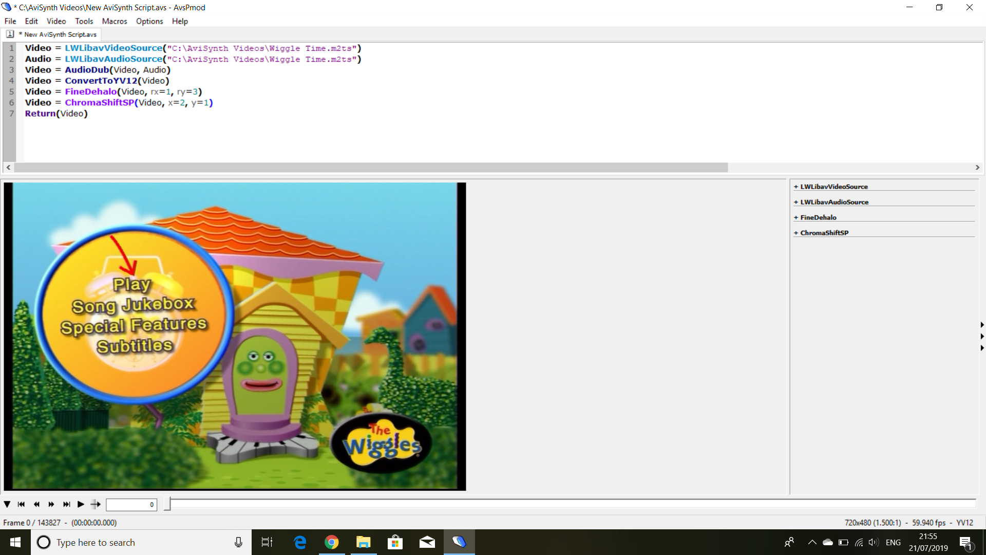

  27. I used FineDehalo and ChromaShiftSP setting you've posted, but I don't get the same result. Right edge gained an artifact. Anything I'm doing wrong? Image
    [Attachment 49597 - Click to enlarge]
  28. Why is the image a different size and aspect ratio? The chroma artifact at the right edge is because of the black border. Crop the black borders away before shifting the chroma. And the chroma is shifted too much now -- probably because if the smaller image.
    As was suggested earlier, you should post a sample of your source video for more concrete suggestions.
