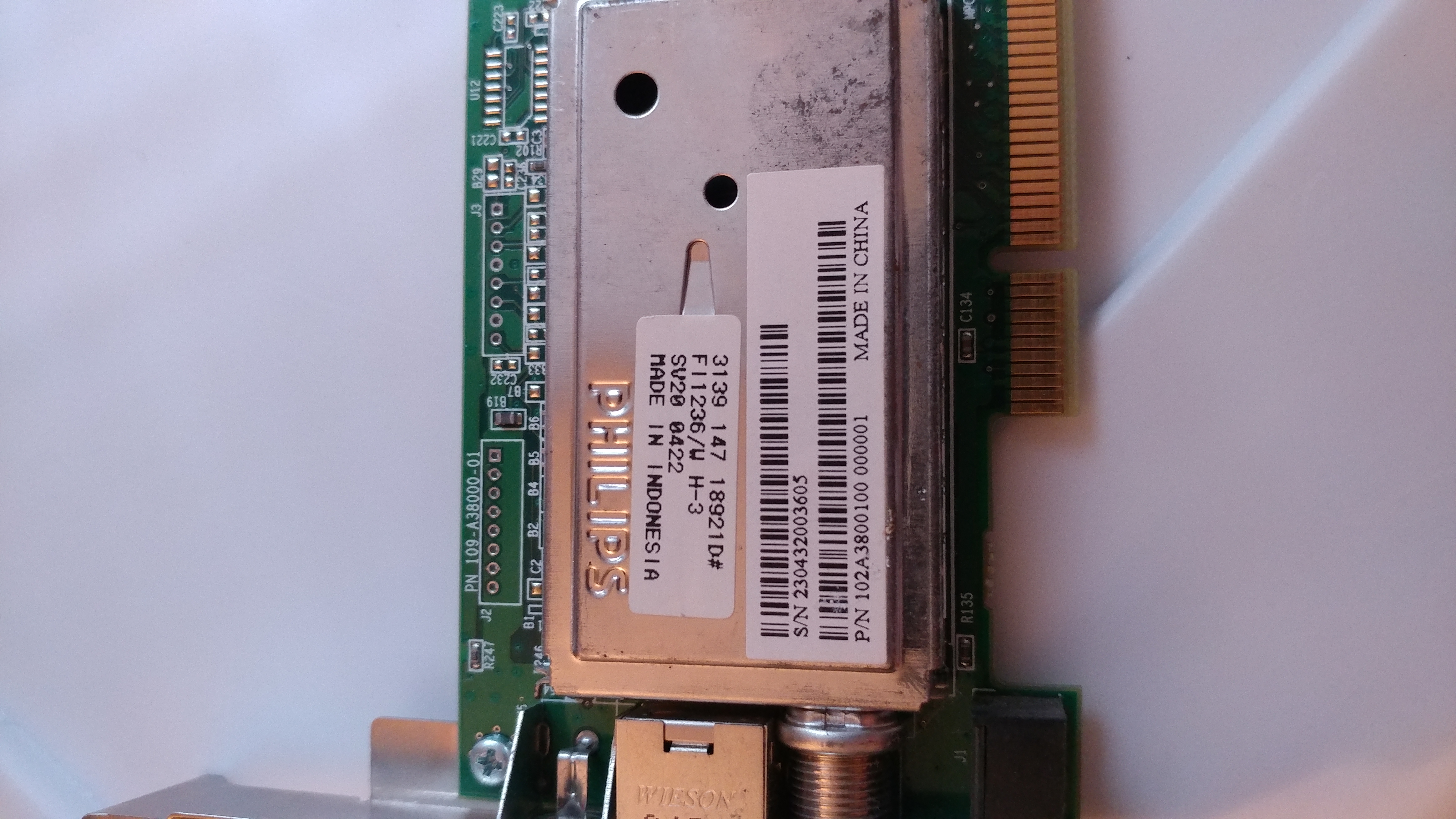

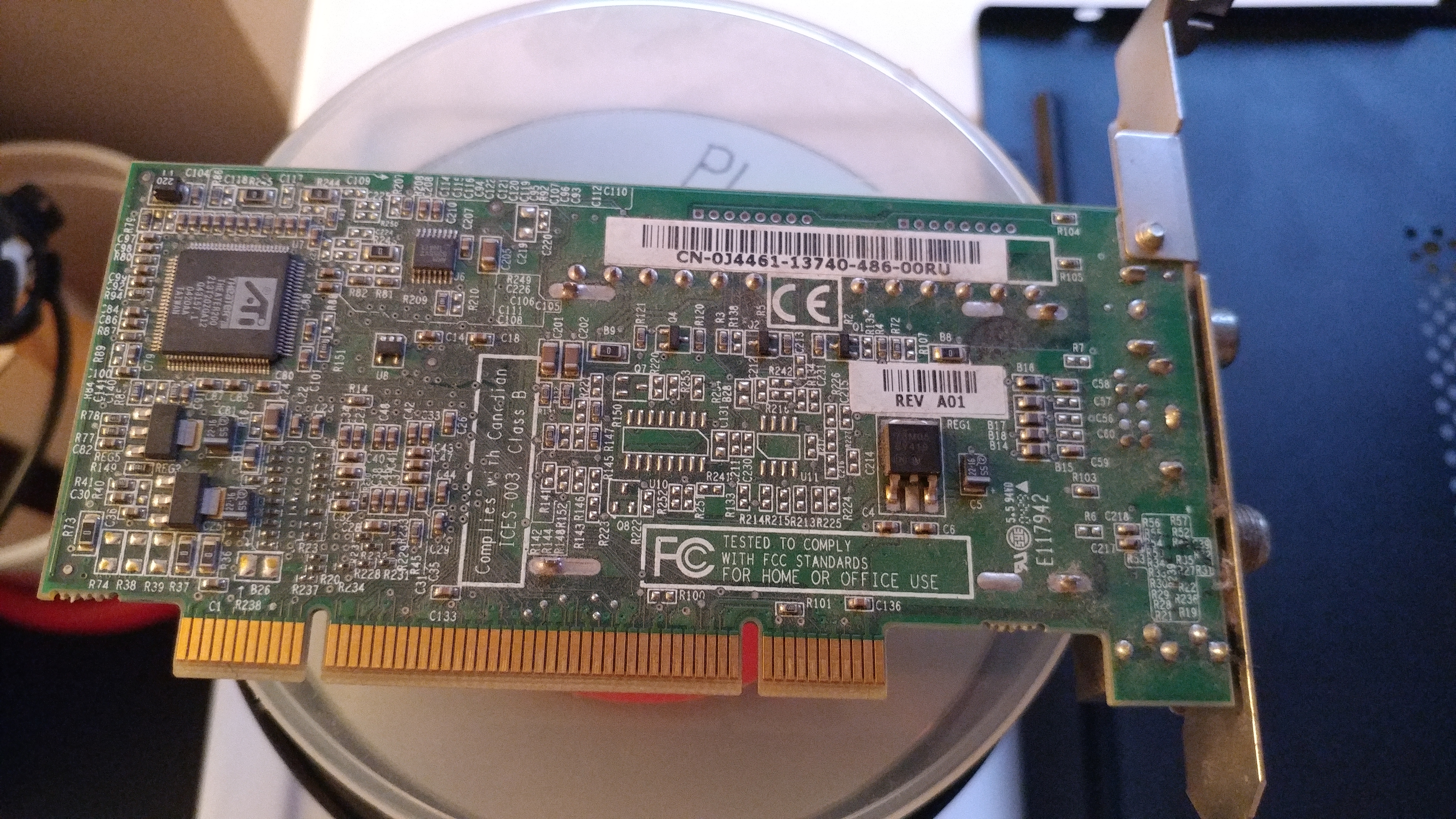

    This capture card seems to be a mystery, and I cannot find the drivers for it anywhere! The seller on eBay had it listed as an "ATi Wonder Pro PCI".
    https://www.ebay.com/itm/ATI-TV-Wonder-Pro-PCI-Philips-F11236-W-TV-Tuner-Video-Capture...orig_cvip=true
    Doing some googling showed many results but none of them were for this card. It just seems very vague as to what it is. It also appears that many of the parts on this card are used in many other capture cards, so that didn't help the confusion.

    Googling the part number printed on the circuit board 109-A38000-01 shows that it's made for Dell desktops, This could be your driver:
    https://www.dell.com/support/home/us/en/04/drivers/driversdetails?driverid=78vkn

    It's a Dell ATi Elite 109-A50330-11 PCI TV Tuner Card.

  9. Capturing Memories dellsam34's Avatar
    Jan 2016

  10. Originally Posted by dellsam34 View Post
    So, I tired this one out and managed to get video but no audio. However I was able to capture audio from the line-in but it was not in sync.

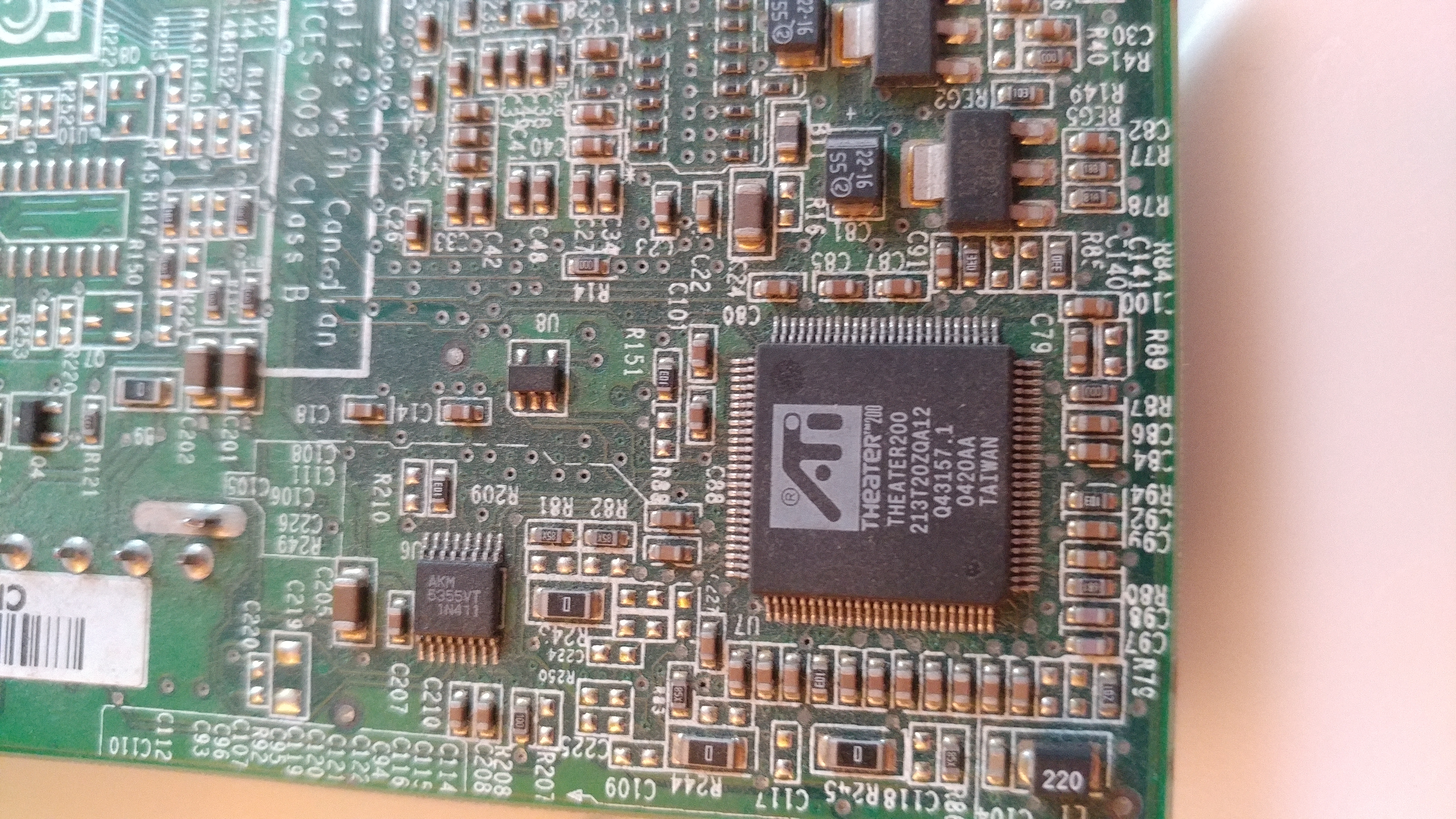

    If I recall correctly, TV tuner cards based on the ATI Theatre 200 chip only ever had drivers available for XP. The video features of this card probably won't work with any newer version of Windows.

  15. Provide Hardware ID - something like PCI\VEN_8086&DEV_10F5&SUBSYS_20EE17AA&REV_03
  16. Originally Posted by pandy View Post
    provide hardware id - something like pci\ven_8086&dev_10f5&subsys_20ee17aa&rev_03
    pci\ven_4444&dev_0016&subsys_fffb1002&rev_01
