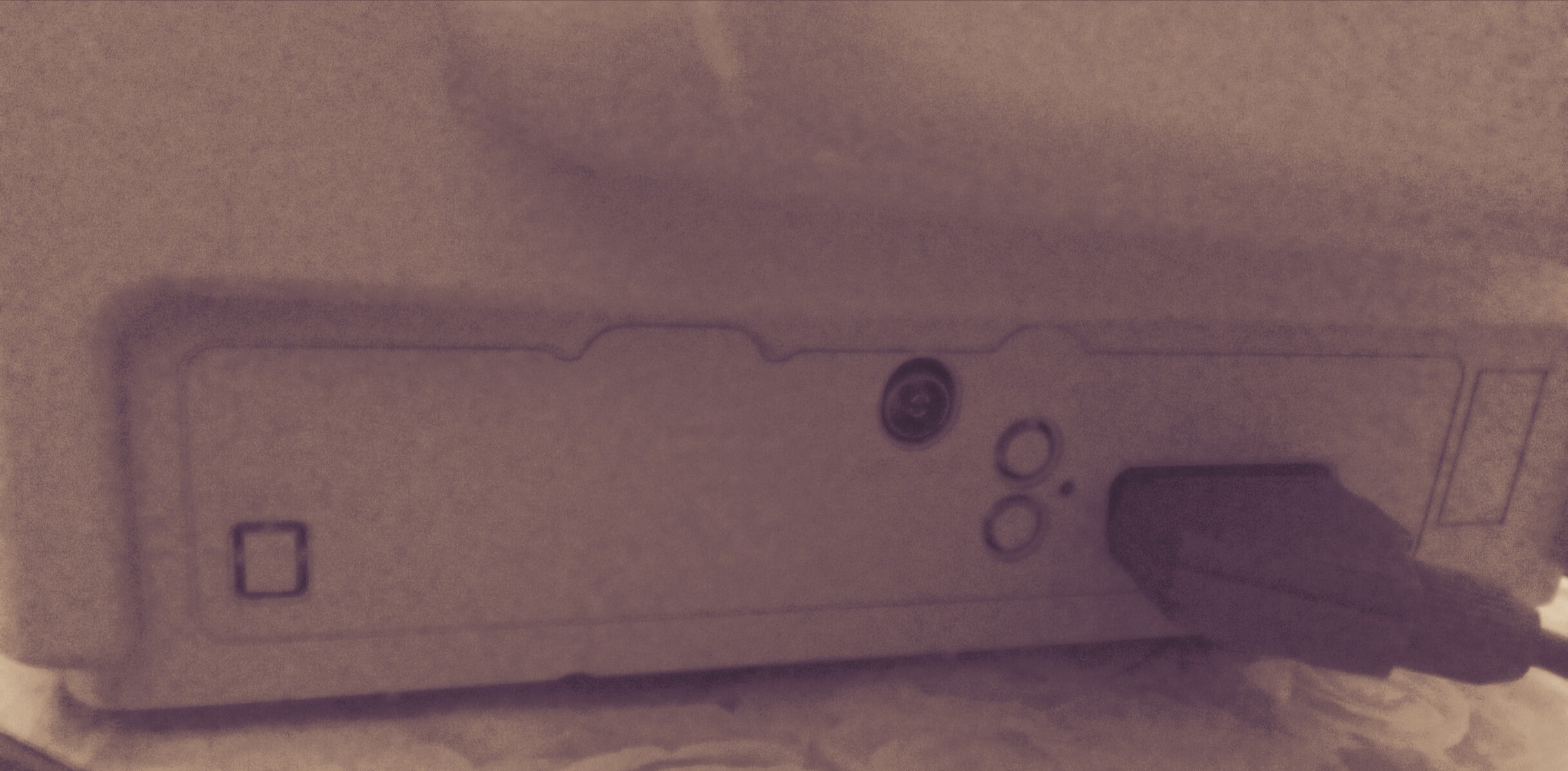

    can you post a screen shot of the back of the CRT TV ??
    in order to see all the hook ups it has.
    and who is the manufacture & what is the model of the CRT TV ??

  23. Member
    Sep 2008
    Originally Posted by october262 View Post
    Originally Posted by alih786 View Post
    Originally Posted by jokster View Post
    if the crt has two scart inputs, see if one is marked rgb - use that one
    only one scart input mate
    can you post a screen shot of the back of the crt tv ??
    In order to see all the hook ups it has.
    And who is the manufacture & what is the model of the crt tv ??
    hitachi
    c1426r
    [Attachment 49517 - Click to enlarge]
    [Attachment 49518 - Click to enlarge]

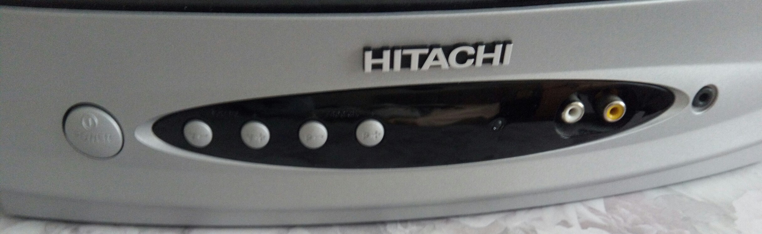

  24. Member
    Feb 2006
    are you using the yellow & white connections that are on the front
    of the TV or the connections on the back of the TV ??
  25. Member
    Sep 2008
    The Back.
    My DVD player only has a Scart connection. And I do not have a yellow and white rc/rgb cable for the TV front.
