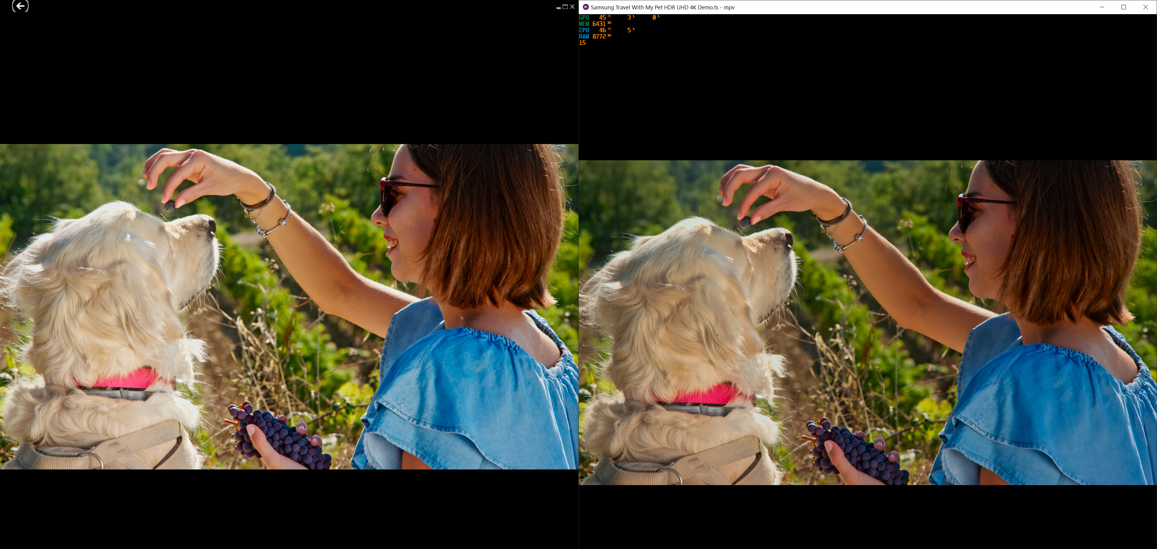

    Hello, hope this is the right section.
    So the output image on screen of mpc-hc or even potplayer (between those two there's no differences) is really different on color and brightness between the on from MPV.
    I installed LAV megafilters and using high end GPU settings for UHD displays, settings in MPV are the following:
    priority = high
    keep-open = yes
    autofit-larger = 50%x50%
    scale = ewa_lanczossharp
    hwdec = auto-copy
    gpu-api = d3d11
    gpu-context = d3d11
    profile = gpu-hq
    video-sync = display-resample
    alang = eng,en,enUS,en-US,English,it,ita,Italian
    cache = 8388604
    cscale = ewa_lanczossharp
    dscale = ewa_lanczossharp
    So why are they so different? What is supposed to be the correct one?
    Also i have another question, what happens when i play HDR content on a non-HDR display?

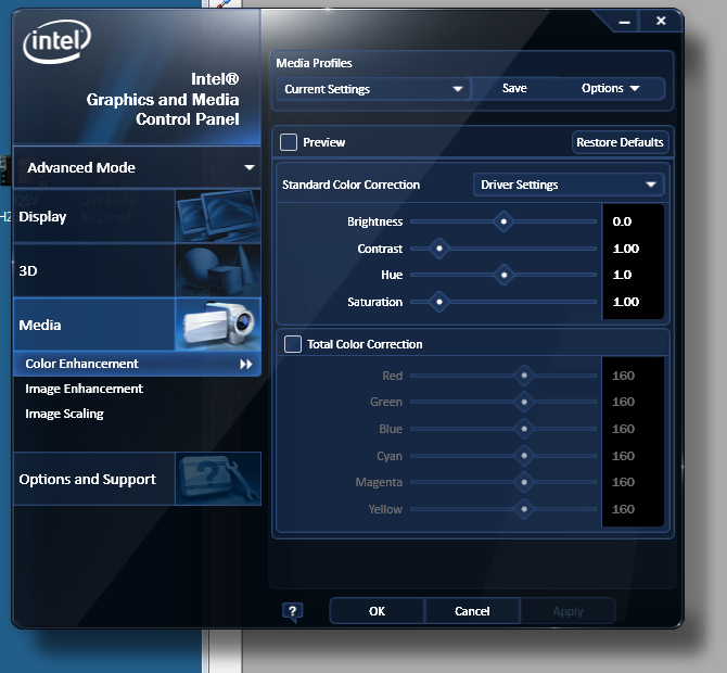

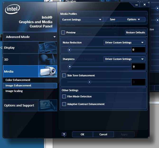

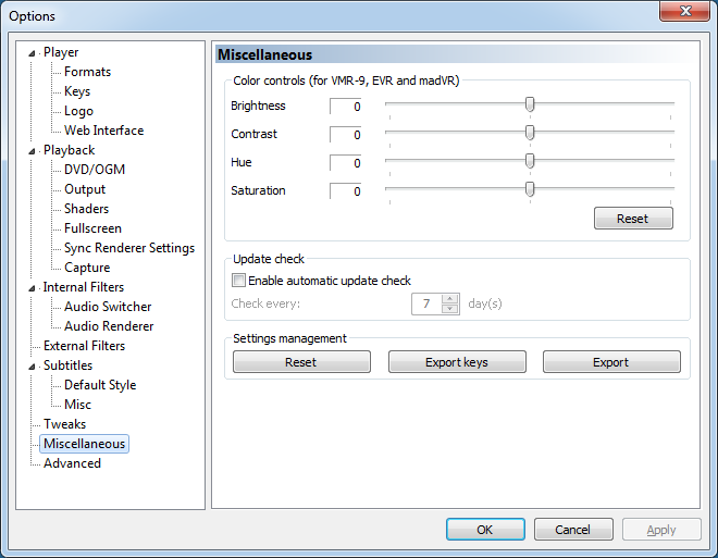

    For example, MPCHC has its own proc amp controls:
    [Attachment 49007 - Click to enlarge]
    Every graphics card driver has proc amp and other "enhancement" controls:
    [Attachment 49008 - Click to enlarge]
    [Attachment 49009 - Click to enlarge]
    Players may use their own proc amp or the system proc amp.
    I mean the differences between your screen shots is too large to be explained simply as a rec.601 vs. rec.709 error
    Is the video HDR? Players may use vastly different tonemapping algorithms. If it's not HDR it could be some GPU driver setting ("image enhancements").

    Everything is disabled, both in MPC-HC and radeon settings, the only thing i can find which might be related is "compromise on tone & gamut mapping accuracy" but disabling it doesn't make a difference
