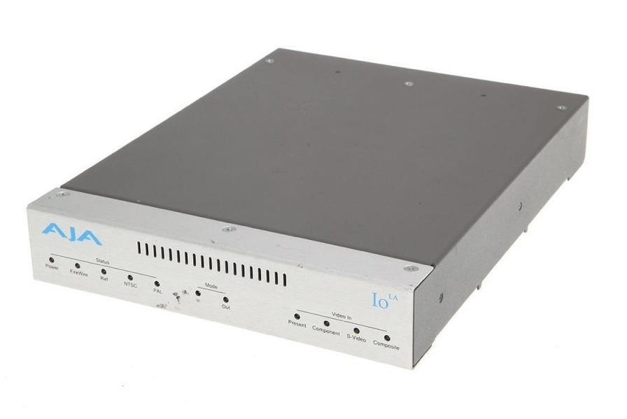

    Yes, You read that right, Aja back in the day made an analog video capture device, The AJA Io LA that can capture 10/8 bit uncompressed video and 24 bit audio in addition to DV25 and DV50 from composite/S-Video/component using a firewire connection between the capture box and a Mac computer.
    Here is direct quotes from the devices's manual:
    "Many people associate FireWire with DV (Digital Video); unfortunately this has led some to believe that it only works with compressed video. The AJA Io family of products do not compress video or audio—they simply uses the impressive bandwidth of FireWire as a conduit to send A/V data to and from the Power Mac."
    "FireWire is a cross-platform implementation of the high-speed serial data bus defined by IEEE Standard 1394-1995. It can be used to move large amounts of data between computers and peripheral devices—any type of data. It features simplified cabling, hot swapping, and transfer speeds of up to 400 megabits per second (FireWire 400). A new 800 megabit per second implementation (FireWire 800) is also available on many current Apple computers. AJA has co-developed the Io family of products with Apple to use FireWire for transferring 10-bit uncompressed video and 24-bit audio to and from an Apple Power Mac or Xserve"
    I bought one very cheap from ebay to test it on a PC platform since I have a laptop with firewire, I will report back if it works with the common Windows capture software when I get it.
    They are still available on ebay, I got the cheapest off the list already sorry.
    Here is some online pictures of the capture box:

  2. Member DB83's Avatar
    Jul 2007
    Good luck with that.
    I see nothing in the manual about Windows support and the drivers are only for Mac OS.
    The manual also goes on to say that uncompressed capture requires a raid array since although the interface can support the data a single hdd will not.
  3. At Firewire's 400 Mb/s (50 MB/s) modern drives can probably keep up, at least on the outer cylinders. Certainly SSDs can. But who cares about a 15 year old niche capture device that requires specialized drivers? IEEE 1394 is just a physical connection -- it could be used to transfer any type of digital data.

  6. Capturing Memories dellsam34's Avatar
    Jan 2016
    Lossless SD @ 10bit is around 270Mbps so modern computers and hard drives are not the problem. Now drivers could be an issue since there is no external buttons to control the box and tel it at what mode to capture, a software such as Final Cut Pro could be required (It originally shiped with the box), I will try Premiere on the PC to extract 8 or 10 bit videos and from there use ffmpeg to compress to modern codecs, Too bad it doesn't have a frame sync/TBC like my BrightEye 75, But $17 was worth a try.

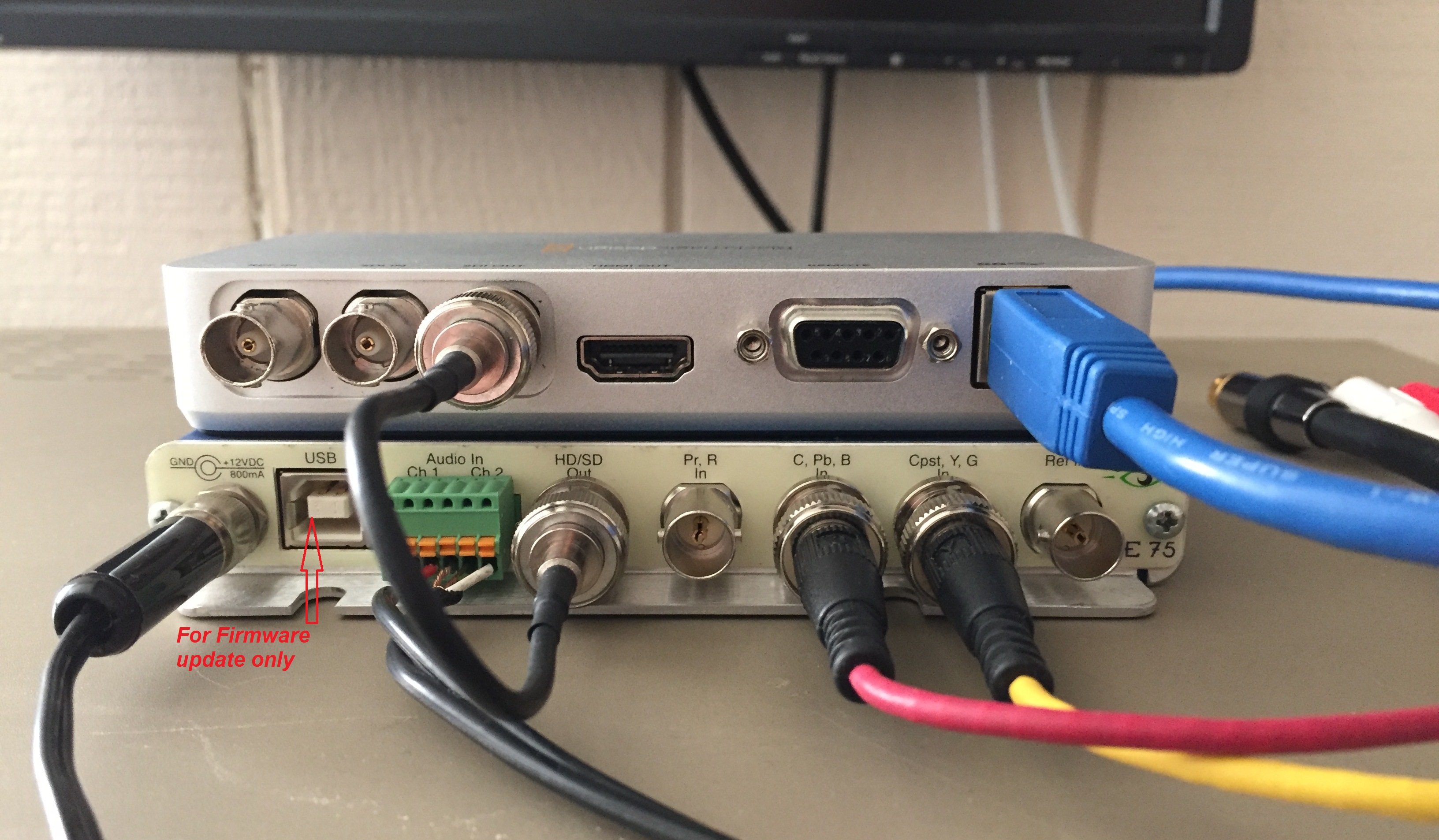

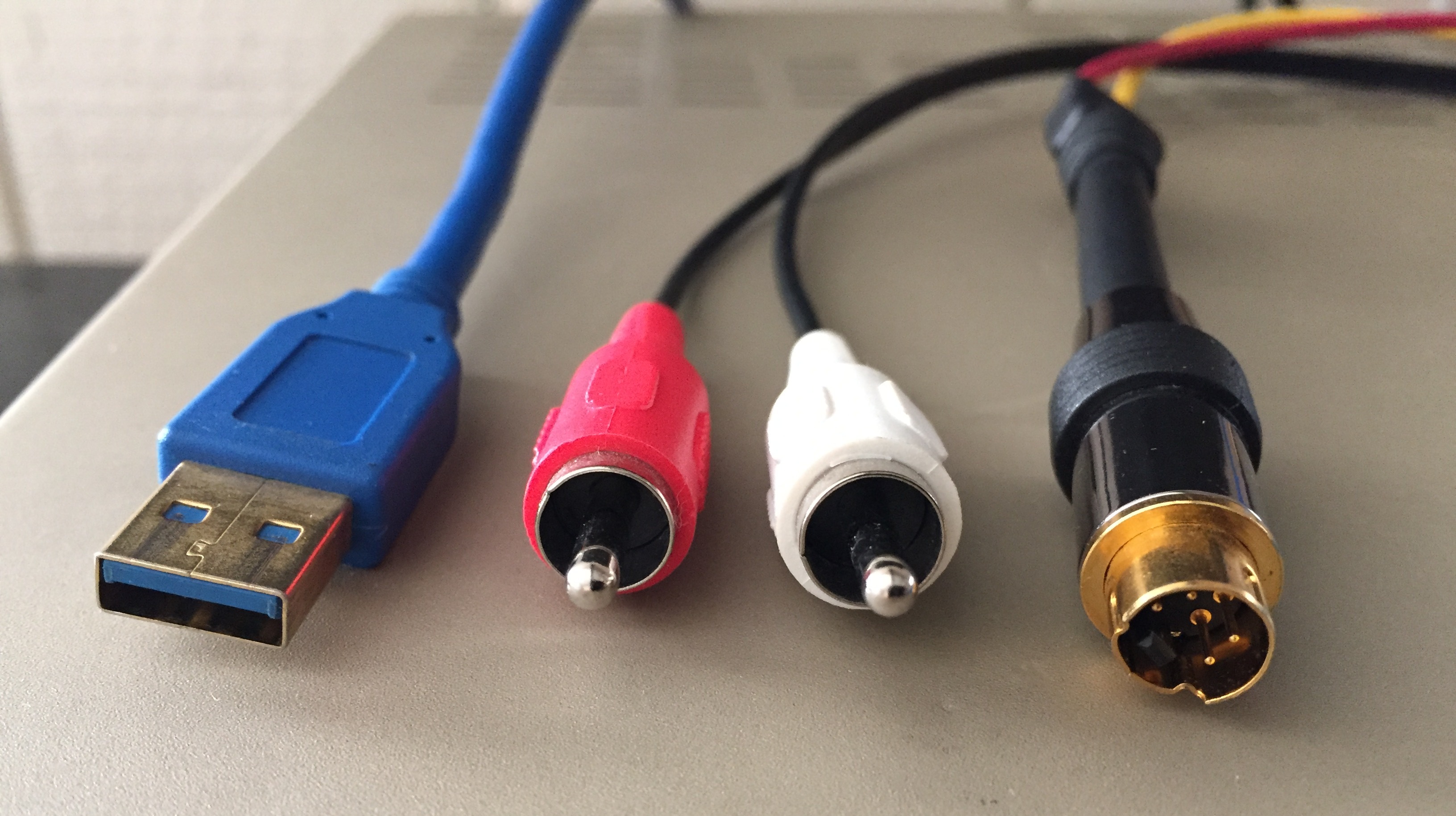

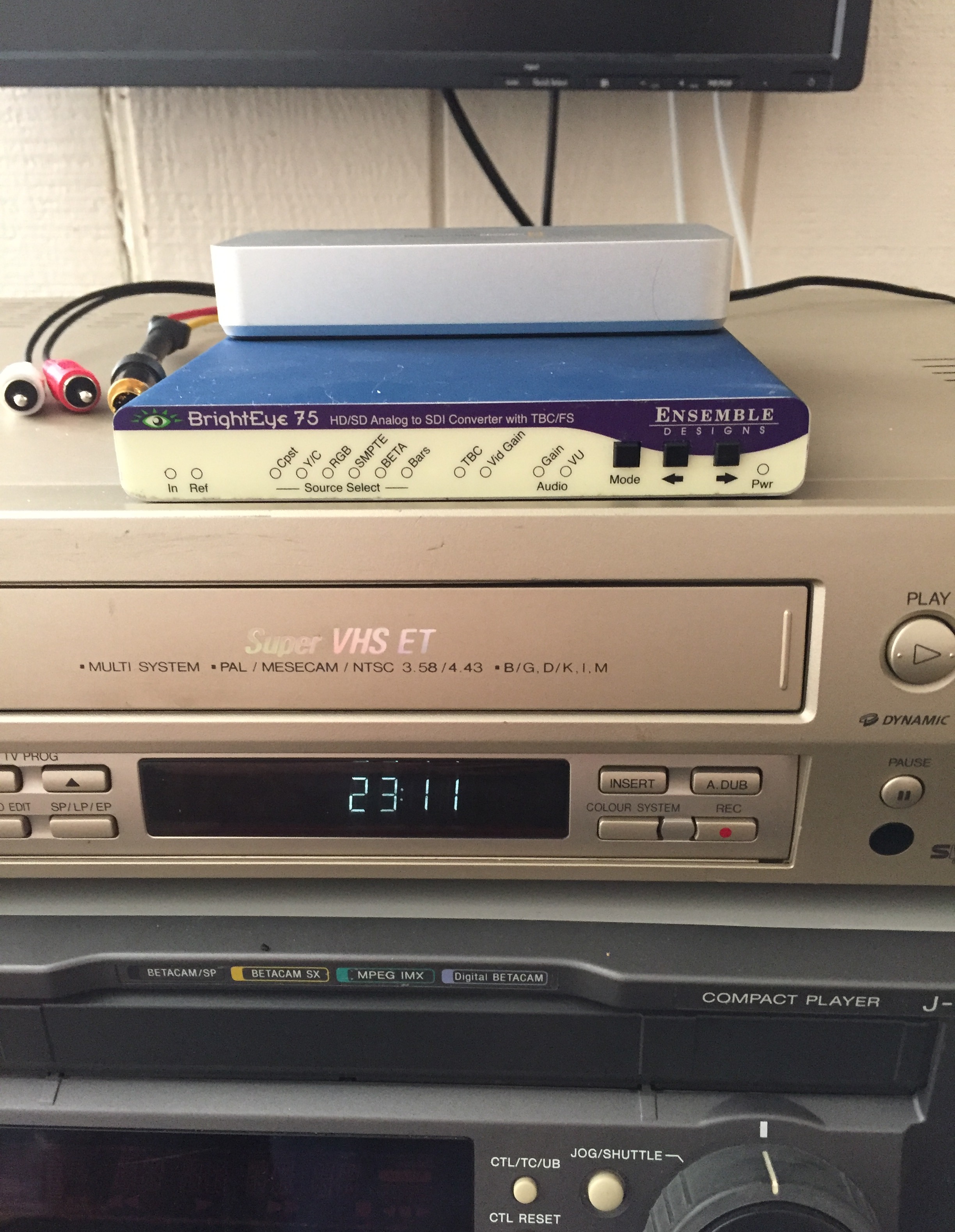

    While learning the capture business for the last few years I was dealing with the same dilemma about PC friendly consumer equipment and non PC friendly pro equipment with weird connections and I'm glad that I finally found one thing than can streamline all those three together (PC, Consumer VCR's, Pro capture devices) with no problems at all, And that thing is the Digital SDI port.
    SDI connection from its SD days to nowadays HD and even 4K kept a friendly relationship with all operating systems throughout the years when using the appropriate interface (SDI/SCSI, SDI/Firewire, SDI/USB), For today's systems all what is needed is a SDI USB 3.0 dongle that connects your weird pro analog video capture device to a modern computer and you are ready to capture 10 bit or 8 bit 4:2:2 from any analog source with pretty much any software including Vdub on any version of OS.
    Although SDI USB dongles do nothing to the video they just act as a communication gate between the analog capture device and the USB port they are still expensive due to the demand from the pro community to connect the modern pro gear to computer. But they serve another purpose which justifies the price, You can connect them to any video player with SDI out such as Betacam for transferring the content without having to rely on the analog outputs of the player, Hence a lot of people call those dongles SDI capture devices but in reality they are not, They just transfer the raw uncompressed digital video as it is to the computer kind of like transferring D8 or DV to computer (except they are compressed streams).
    An analog video capture system based on SDI would look like below in the stack, I know ugly but works with no problems, No frames dropped, no audio sync problems, no blue screen issues for loosing the signal, It just works:

  24. Originally Posted by dellsam34 View Post
    Ugly?! That's a stack of beauty!
    Thanks for the SDI info, that gives me hope that my Promax Promedia Converter may just work as an analog/SDI capture/converter device box thing. I'll have to get an SDI input card/dongle and see if I can get my own stack of stuff to all work.
  25. Capturing Memories dellsam34's Avatar
    Jan 2016
    Is it the one here? Aside from the lack of TBC/Frame Sync it is a good capture box, If you have a firewire port on your computer you're good to go.
