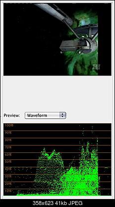

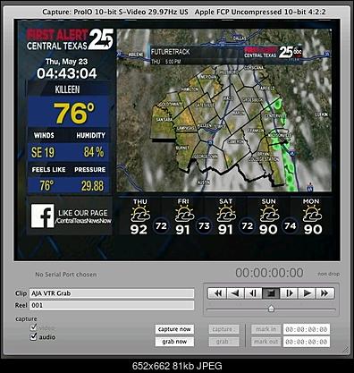

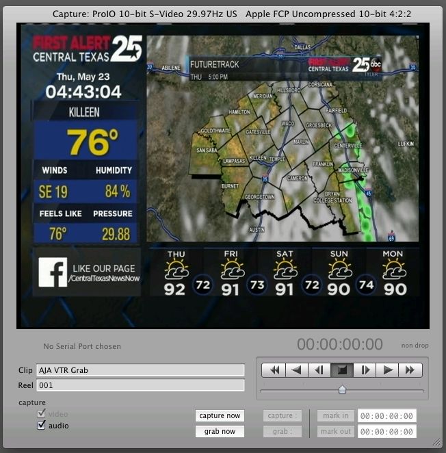

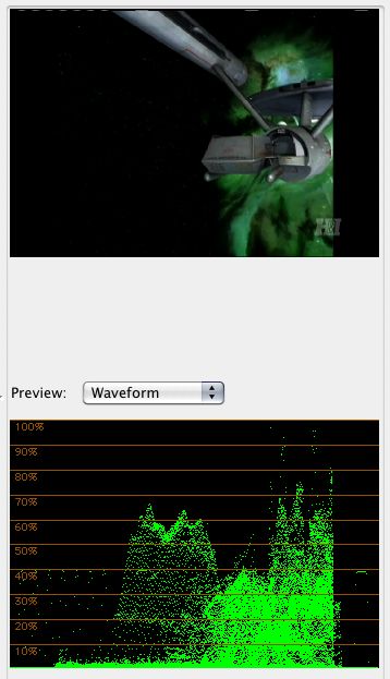

    The AJA VTR application still holds up today, its very nice for free software.
    Preview of: Compression, Vectorscope, Waveform, Histogram, RGB Parade or RGB Waveform
