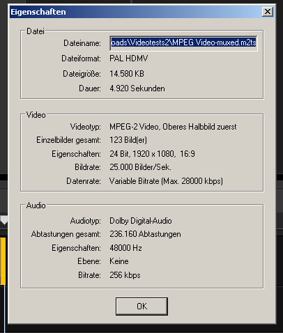

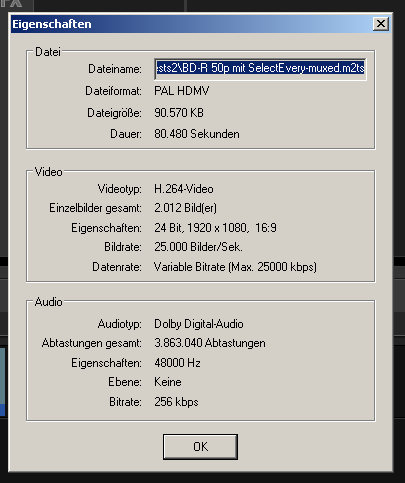

    The video now seems to be in the right format, at least as far as the frame rate is concerned. In MCP-HC is now synonymous almost the same format as in my camcorder displayed except for two differences that make me still startled, see red marked lines.
    General
    Complete name                  : F:\Downloads\Videotests2\Blu-Ray Test-muxed.m2ts
    Format                         : BDAV
    Format/Info                    : Blu-ray Video
    File size                      : 16.8 MiB
    Duration                       : 8 s 656 ms
    Overall bit rate mode          : Variable
    Overall bit rate               : 16.2 Mb/s
    Maximum Overall bit rate       : 35.5 Mb/s
    Video
    Menu ID                        : 1 (0x1)
    Format                         : AVC
    Format/Info                    : Advanced Video Codec
    Format profile                 : High@L4.1
    Format settings                : CABAC / 3 Ref Frames
    Format settings, CABAC         : Yes
    Format settings, ReFrames      : 3 frames
    Codec ID                       : 27
    Duration                       : 8 s 600 ms
    Bit rate mode                  : Variable
    Bit rate                       : 15.3 Mb/s
    Maximum bit rate               : 40.0 Mb/s
    Width                          : 1 920 pixels
    Height                         : 1 080 pixels
    Display aspect ratio           : 16:9
    Frame rate                     : 25.000 FPS
    Color space                    : YUV
    Chroma subsampling             : 4:2:0
    Bit depth                      : 8 bits
    Scan type                      : MBAFF
    Scan type, store method        : Interleaved fields
    Scan order                     : Top Field First
    Bits/(Pixel*Frame)             : 0.296
    Stream size                    : 15.7 MiB (94%)
    Color range                    : Limited
    Color primaries                : BT.709

    Apr 2019
    Germany
    I just found out that there seems to be a problem with the files converted with MeGUI after I tried to import the finished 1080i50 files into "Corel VideoStudio". While the MPEG files exported so far by "Magix Video Deluxe" are correctly recognized and played back, the files converted by MeGUI and x264 get a constant flickering and green color flashes during playback. Also, the "Smart Rendering" does not work here (Magix Video Deluxe Export works). After I looked at the file properties, I saw that the headers are completely different, see attachments, although both files should be actually in M2TS format. The exported MPG-file by "Magic Video Deluxe" will be displayed correctly as MPEG2 video, upper field first. The file converted with MeGUI and x264 as H.264 file, although I have exported as RAWVAC first and then muxed 264- and AC3-File with the M2TS Muxer. Apparently that's not completely compliant. So, what have I done wrong? How do I get the correct header in the file or how do I export and mux it correctly with MeGUI, so that the file is recognized correctly by Corel VideoStudio again?
Name:	Corel Video Deluxe MPEG Export (Blu-Ray Settings).jpg
Name:	MeGUI x264 Export (Blu-Ray Settings).jpg

    Most professional authoring programs work with elementary streams only . Putting it into a container changes the sequence header and reduces compatibility. Did you try importing the .264 (or .avc) file directly
    I import the ready muxed M2TS-File from the 264- and AC3-File which I have muxed with the M2TS-Muxer from MeGUI. Since you can not really go wrong.
    Originally Posted by _Al_ View Post
    to make interlace video , today , in 2019 is a nonsense if you recorded it 50p or 60p. Forget BD authoring tools and their limitations, or use multiavchd if you desire a menu.
    Do not create interlace content. There might be plenty of workflows over web, but check the date it was written down.
    Your footage is from GoPro, perhaps lots of action and movement, jerkiness to create interlacing out of you full frames makes no sense.
    Yes, I can see it but that don't help for the moment at the moment as I still have some 1050i50 videos on the hard drive which are collected for the completion of a new BD-R. The next one I will definitely only burn in 1050p50 but for that I have to test one of the proposed authoring programs here and that is new territory for me because so far I have done this exclusively with Corel Video Studio.
    I don't want to dispense of the disk menus, because somehow this belongs to the convenience for me to watch such videos from the couch.
  28. Originally Posted by PARALAX View Post
    Yes, I used all the Blu-Ray settings from the program wich was recommended.
    Here is a copy of the Log-File:
    1) I recommended not to use CRF , rather you should use 2pass . Because of glitches in VBV capped CRF . Not like the ones you described, but certain frames have a fluctuating quality. Still you should avoid it.
    2) You don't need 4 slices for L4.0 , only L4.1 requires 4 slices for BD
    3) Level should be set to 4.1. L4.0 is limited to 24Mb/s maxrate for BD , so your vbv values are incorrect for L4.0 (you have it set to 25Mb/s) . You should use --vbv-maxrate 40000 --vbv-bufsize 30000 for L4.1 . (Some people go a bit lower just in case like --vbv-maxrate 39500 , --vbv-bufsize 29500 , but I never had problem with it
    Not a good idea . Because an authoring tool has to demux it again then remux .
    TS is less bad, but certain container fromat definitely make it incompatible
    But if you use TS (not recommended) , then uncheckmark insertSEI and VUI options in TSMuxer . Those options make it incompatible for programs like scnearist BD , so maybe here as well . Authoring programs prefer ES .
    It's probably an issue with your authoring software, for example certain muxers has problem with open gop. You can try using closed GOP, but at the expense of slightly lower quality (It won't have a huge impact)
  29. Member
    Apr 2019
    Germany
    I really can't complain about the quality. It's very close to the original. Only bigger areas with dark colors are compressed more, but the ugly block formation, which I previously knew from MPEG videos and partly from xVid are even with the default settings barely noticeable. Nevertheless, I tested the 2pass setting and will take a closer look at it.
    M2TS fully complies with the Blu-Ray specification, especially since these files are just as on the disk. I can expect that a good authoring program can handle with such a file format without re-encoding (Smart Rendering), especially since I do not post-edit it but only create my disk menus. Otherwise, the program is good for nothing. Another file format makes no sense in my opinion, especially since I do not know what you can take there. Apart from that, MeGUI only offers Muxer for MP4, AVI and MKV. All these formats make no sense for creating Blu-Ray discs and would certainly have to be re-encoded, even because the different file header.
    That's what I also think meanwhile, although as I already said all videos from my Camcorder are accepted without problems. However, my version of Corel Video Studio is still from 2011 and actually more than outdated. So far, there was no good reason for me to upgrade and spend money once again, especially since I have just bought the latest version of Magix Video Deluxe a few days ago.
    Anyway, here's the log file with your recommended settings. Unfortunately it has do nothing except a larger 264-file. Corel Video Studio still plays the video flickering and does not accept smart rendering.

    ---[Information] [01.05.2019 23:52:38] Network Optix tsMuxeR.  Version 2.6.12. www.networkoptix.com
    ---[Information] [01.05.2019 23:52:38] Decoding H264 stream (track 1): Profile: High@4.1  Resolution: 1920:1080i  Frame rate: 25
    ---[Information] [01.05.2019 23:52:38] B-pyramid level 1 detected. Shift DTS to 2 frames
    ---[Information] [01.05.2019 23:52:38] H264 bitstream changed: insert pict timing and buffering period SEI units
    ---[Information] [01.05.2019 23:52:38] Decoding AC3 stream (track 2): Bitrate: 256Kbps Sample Rate: 48KHz Channels: 2
    ---[Information] [01.05.2019 23:52:38] Processed 215 video frames
    ---[Information] [01.05.2019 23:52:38] Flushing write buffer
    ---[Information] [01.05.2019 23:52:38] Mux successful complete
    ---[Information] [01.05.2019 23:52:38] Muxing time: 0 sec
    --[Information] [01.05.2019 23:52:38] MediaInfo
    ---[Information] File: F:\Downloads\Videotests2\Testvideo2-muxed.m2ts
    -[Information] Format: BDAV
    -[Information] FileSize: 22321152
    -[Information] PlayTime: 00:00:08.656
    ---[Information] General
    -[Information] ID: 4113
    -[Information] StreamOrder: 0-0
    -[Information] CodecID: 27
    -[Information] Format: AVC
    -[Information] FormatInfo: Advanced Video Codec
    -[Information] Width: 1920
    -[Information] Height: 1080
    -[Information] FrameCount: 215
    -[Information] FrameRate: 25.000
    -[Information] Duration: 00:00:08.600
    -[Information] ScanType: MBAFF
    -[Information] Bits Depth: 8
    -[Information] AspectRatio: 1.778
    -[Information] AspectRatioString: 16:9
    -[Information] PixelAspectRatio: 1.000
    -[Information] Delay: 4200000.000
    ---[Information] Video
    -[Information] ID: 4352
    -[Information] StreamOrder: 0-1
    -[Information] CodecID: 129
    -[Information] Format: AC-3
    -[Information] FormatInfo: Audio Coding 3
    -[Information] SamplingRate: 48000
    -[Information] SamplingRateString: 48.0 kHz
    -[Information] Channels: 2
    -[Information] ChannelsString: 2 channels
    -[Information] ChannelPositionsString2: 2/0/0
    -[Information] BitRateMode: CBR
    -[Information] [01.05.2019 23:52:38] The language information is not available for this track. The default MeGUI language has been selected.
    ---[Information] Audio
    --[Information] [01.05.2019 23:52:38] Postprocessing
    -[Information] [01.05.2019 23:52:38] Successfully deleted F:\Downloads\Videotests2\Testvideo2-muxed.meta
    ---[Information] [01.05.2019 23:52:38] Deleting intermediate files
    --[Information] [01.05.2019 23:52:38] Job completed
