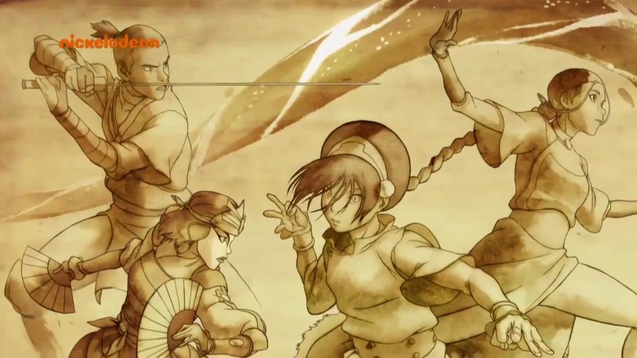

The frame I was searching for:
[Attachment 48908 - Click to enlarge]

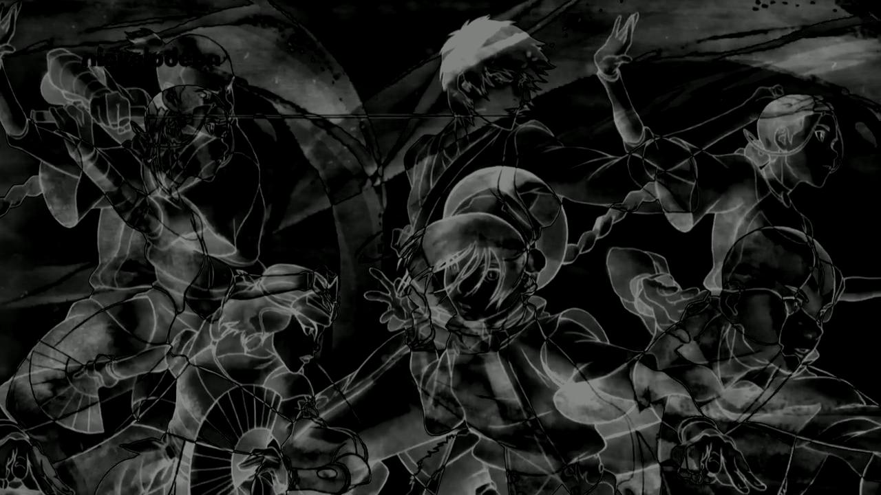

A diff example of a non-matching frame:
[Attachment 48909 - Click to enlarge]
Diff of the matching frame is all black. I'm sure you can imagine what it looks like.

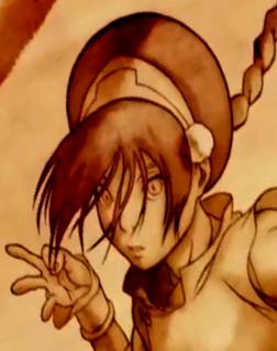

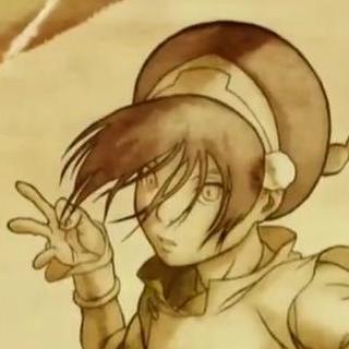

As noted earlier, this won't work if the image is only a portion of the frame. For example, this small image was cropped from the same frame:
[Attachment 48910 - Click to enlarge]
There is no way to know beforehand what portion of the frame to compare too (subtract from). It gets even more difficult if the cropped image is further distorted (brightness, contrast, rotated, scaled, etc.):
[Attachment 48911 - Click to enlarge]
It would be very difficult to match that image to the video frame. It would probably require some A.I. algorithm.Last edited by jagabo; 29th Apr 2019 at 10:00.
