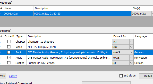

    I have now used MeGui to split the file into 8 wavs, initially I couldn't find the option but if you select 'all demux options' from that settings menu you screen-shotted it gives you the option. One thing I noticed is it refers to the 7.1 audio as strange setup (see below) - is that something to be worried about? I wonder if that blu ray company have somehow taken the 5.1 from the other disc and bodged it to make fake 7.1?
    [Attachment 48919 - Click to enlarge]

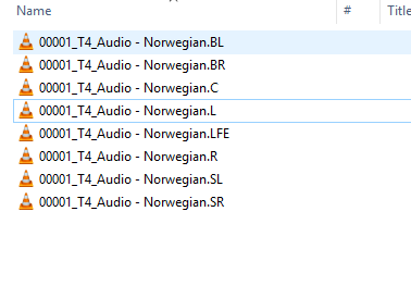

    Once split to wavs these are the files I have:
    [Attachment 48920 - Click to enlarge]
    Does this look normal? I don't have DTS Master Audio Suite (too expensive) but I found a manual for it and it shows that 7.1 DTS should have L, R, C, LFE, Lss, Rss, Lsr and Rsr. I don't have the last four, instead I've got SL, SR, BL and BR?

  4. There's no surround channels in PC-land, so the audio needs to be decoded to a standard wave-file layout. That's normal and has to happen even when you simply play the audio on a PC. http://www.cs.bath.ac.uk/~jpff/NOS-DREAM/researchdev/wave-ex/wave_ex.html#POSITIONS
    I think it was originally based on the official cinema layout that nobody uses, except cinemas.
    To make it more interesting, codecs don't always use the same channel order internally.
    http://avisynth.nl/index.php/GetChannel
    None of that should matter as the audio should be re-mapped to the wave file layout when it's decoded, and encoders expect a wave file layout as the input and remap the channels as required for encoding. Well... there's some possible ambiguity when it comes to 7.1ch audio, as Microsoft chose the theatre layout as the default Windows 7.1ch layout originally (L R C LFE BL BR FCL FCR) instead of the layout for home cinema (L R C LFE BL BR SL SR). I think that changed with Vista, or maybe Win7. The theatre layout is also the default for AAC. As a result, there was some hackery involved in the early days of AAC 7.1ch encoding. You can read about it here, but the upshot is, if you ever encode 7.1ch audio as AAC, use the QAAC encoder.
    If you combine the channels into a single wave file again, be sure to use the wave file channel order. (L R C LFE BL BR SL SR)
    Anyway.... the channels are labelled correctly.
    Side L/R = Lss/Rss (Lss/Rss might mean surround side).
    Back L/R = Lsr/Rsr (surround rear, I assume)
    For the record, 5.1ch audio is sometimes decoded with the surround channels as Side and sometimes as Back. Side is preferable given the 7.1ch layout, but all lossy encoders will accept either Side or Back as the surround channels for 5.1ch audio.

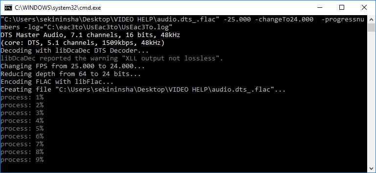

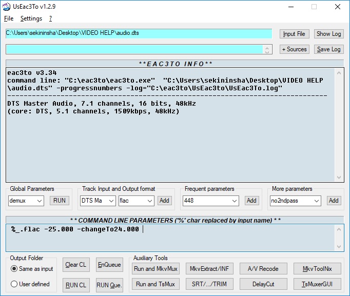

  5. @luciofulci.. and because you do not try this with eac3to I use UsEac3to (gui)
    [Attachment 48932 - Click to enlarge]
    [Attachment 48933 - Click to enlarge]
    regards
