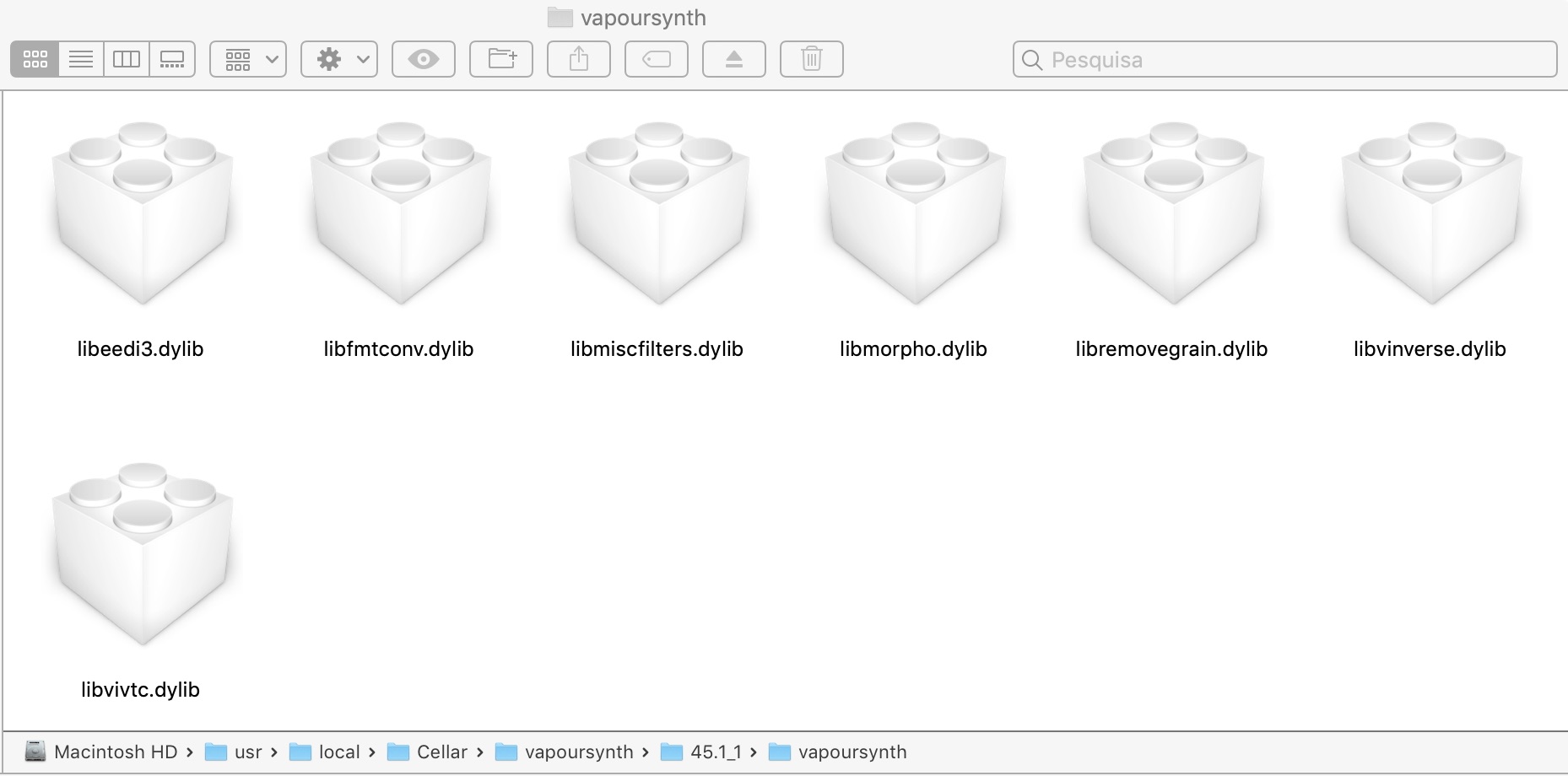

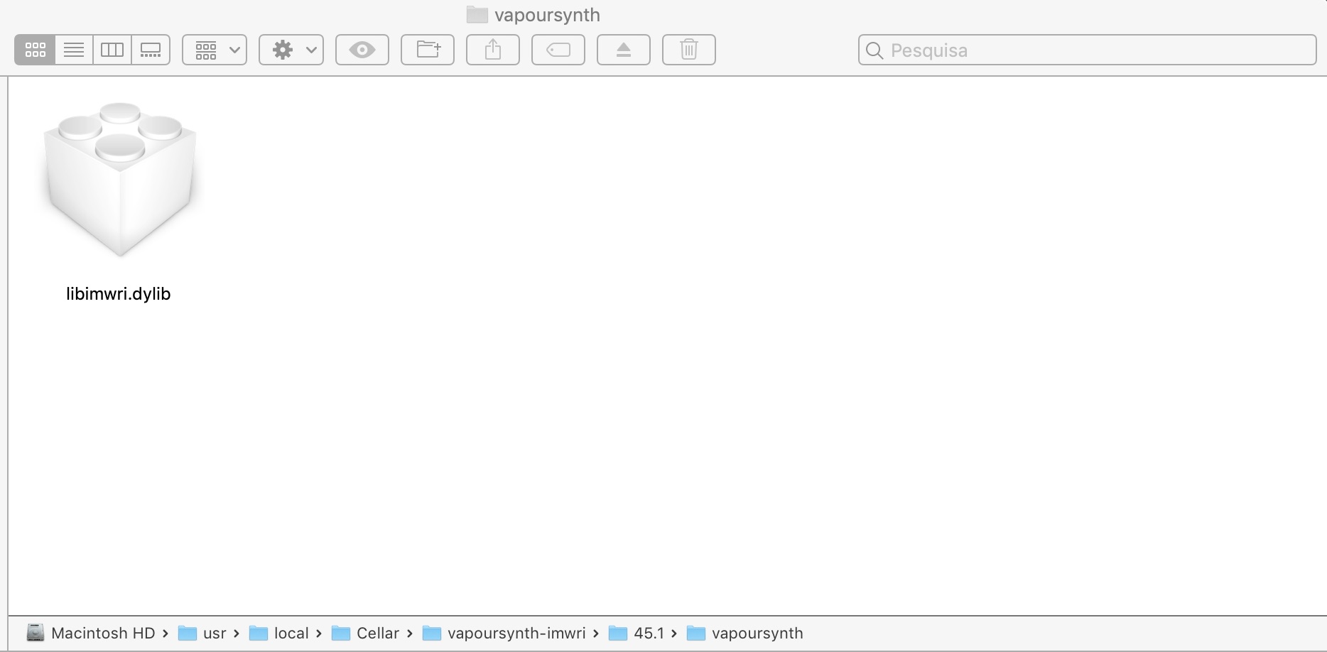

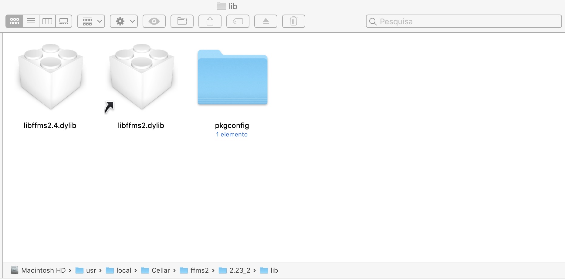

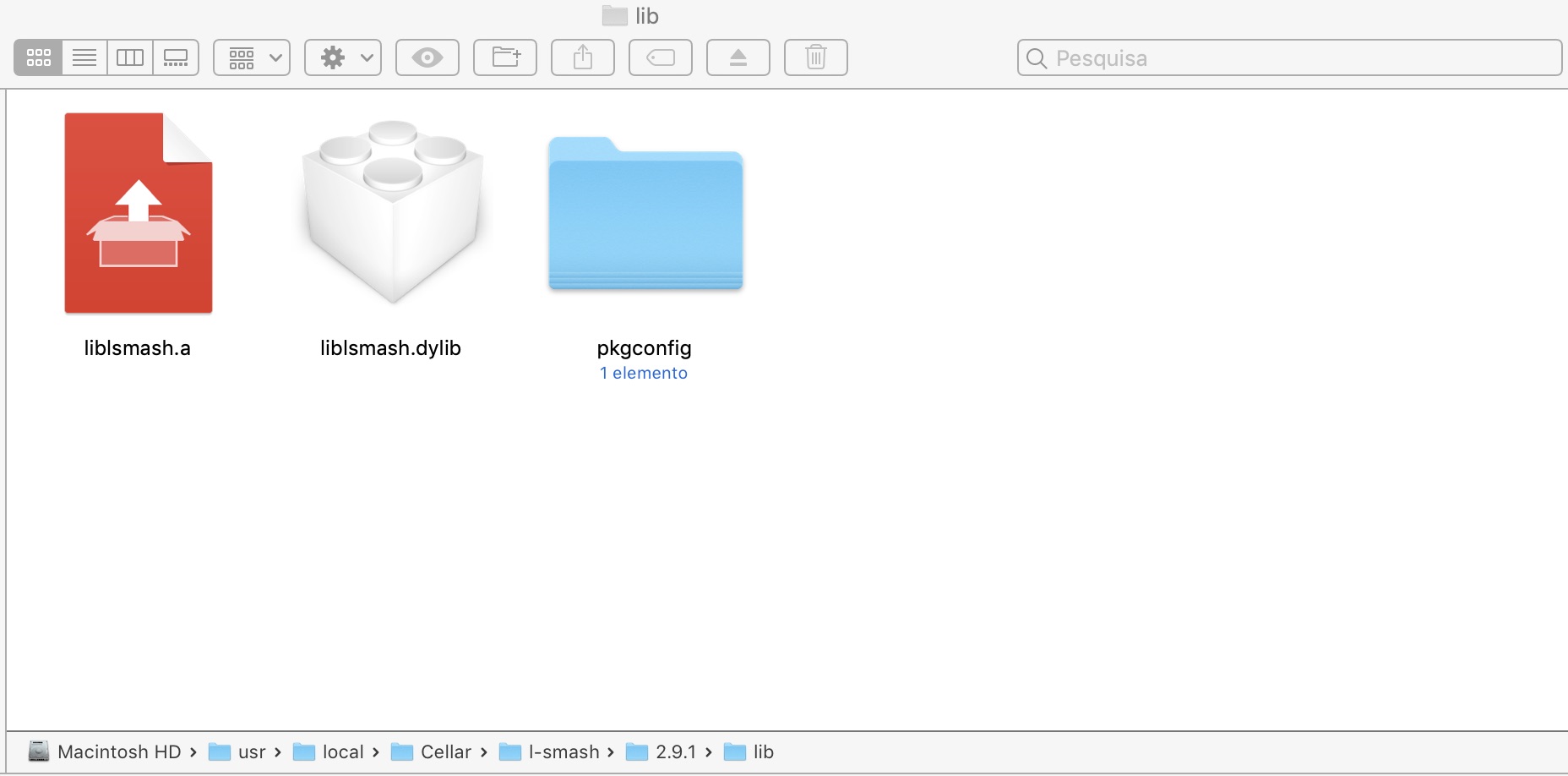

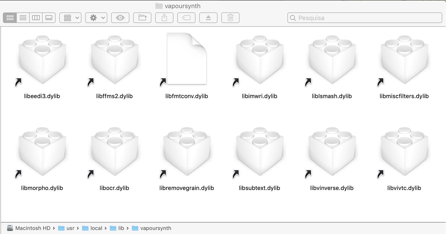

Thank you very much. This is where the plugins are (captures). One of the symbolic links (fmtc) is broken. Should I perhaps eliminate the symbolic links and just duplicate the plugins inside the /usr/local/lib/vapoursynth directory?
-celso
[Attachment 48783 - Click to enlarge]
[Attachment 48784 - Click to enlarge]
[Attachment 48785 - Click to enlarge]
[Attachment 48786 - Click to enlarge]
[Attachment 48787 - Click to enlarge]
[Attachment 48788 - Click to enlarge]
[Attachment 48789 - Click to enlarge] -
symlinks should be fine if they work.
users currently on my ignore list: deadrats, Stears555, marcorocchini -

Referenced from: /usr/local/lib/vapoursynth/libmvtools.dylib
Reason: image not found
Isn't libfftw3f.3.dylib loaded either? How can I install either/both , with brew? Or, how to compile a dylib? Thanks again. -
It says libfftw3f.3.dylib not loaded . And it's a prerequisite as indicated in post 18 in that thread1): Library not loaded: @loader_path/../libfftw3f.3.dylib
https://forum.doom9.org/showthread.php?p=1844578#post1844578I just checked and it also needs FFTW3 as well, sorry about that, in the process of getting all these up all in one day I missed marking those two. The easy way to fix would be to downloaded the provided dependencies and place them in the libraries folder (either through the shortcuts on the desktop or by browsing to /Library/Frameworks/VapourSynth.framework/lib). Having both of those should fix the issue.
It's in the dependencies folder
https://www.mediafire.com/folder/wvdlnjapm1vvw#9iuigreunnq6i
Not sure how to use brew or compile a dylib
You should register at doom9 forum if you haven't already, because it takes a few days to get approoved . Not many mac users of vapoursynth, and they all probably visit there
