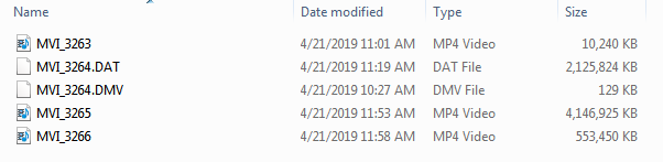

  1. Hello I am new to the forum My friend recorded an important event for me using Canon VIXIA HF G30, unfortunately with errors. (image attached)
    [Attachment 48771 - Click to enlarge]
    3263.mp4 only has 10mb and less than 3 seconds of playable footage
    3264.dat has 2.1G
    Both files were supposed to be close to 4GB.
    My friend suggested putting the SD card (unmodified) back into the camcorder to see if there is remedy. (how?)
    I've also heard about data recovery software such as EaseUs.
    I'm sincerely looking for tips and recommendations on retrieving (salvaging) the most out of this unfortunate incident... You help is greatly appreciated!
    (update: 3264.dat more or less saved with recover_mp4 tool + audacity for choppy audio)

  5. My concern is, solution in the manual addresses error caused by power interruption. In my case, it just gave me 2 bad files and went on to record 2 good ones immediately after. Hope to see if putting the SD card back into Canon will trigger any recovery attempt.
