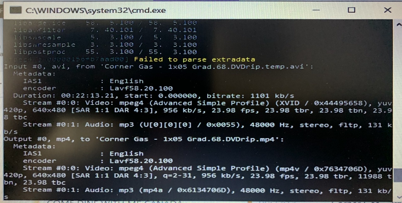

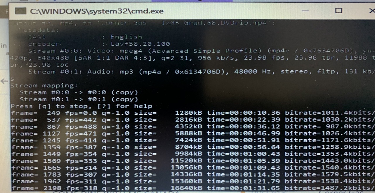

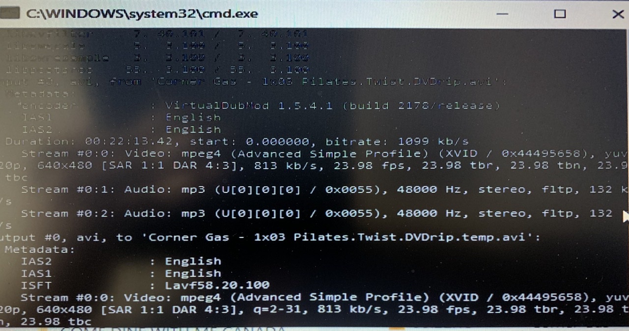

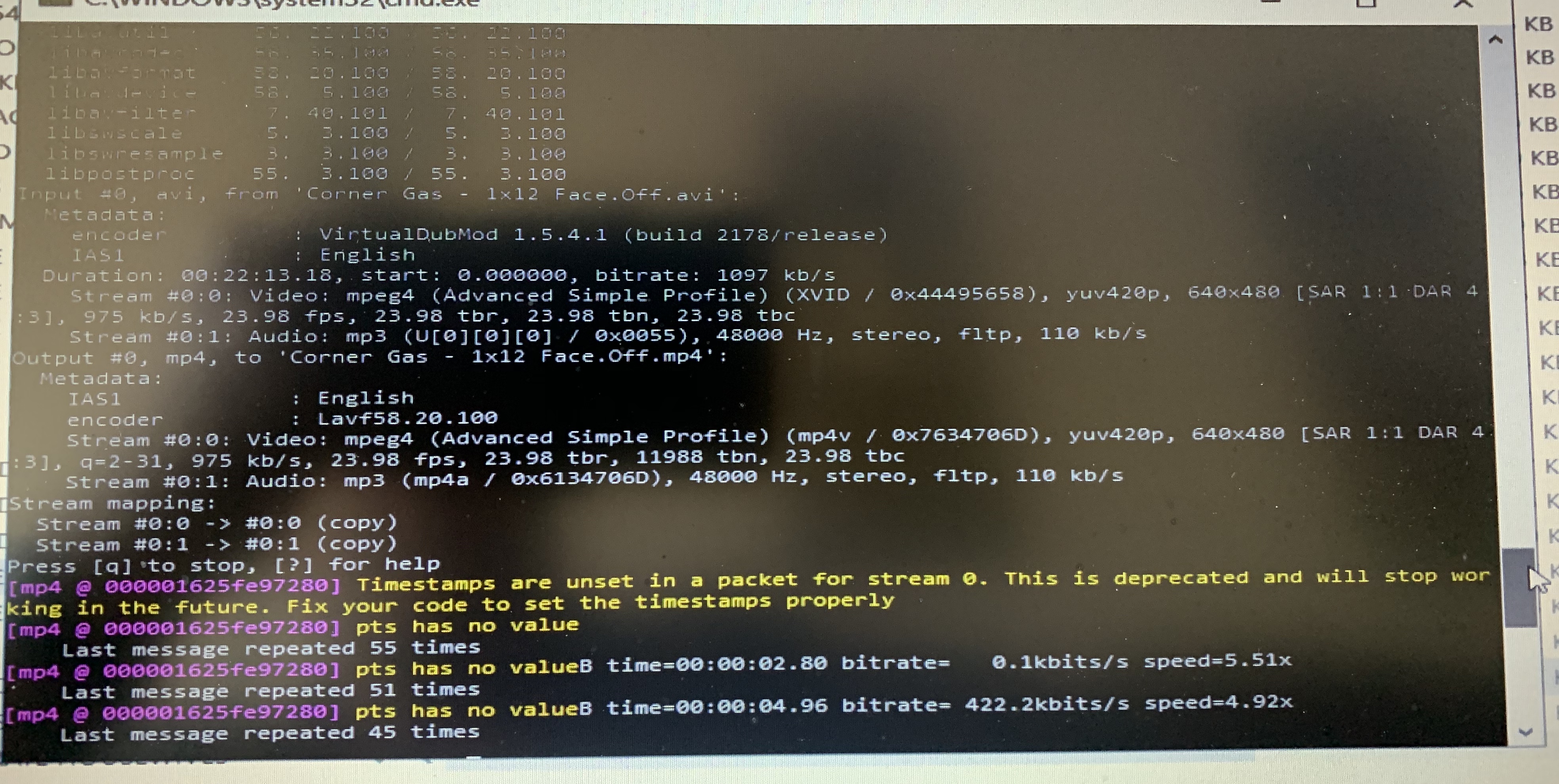

    Here is a screen capture of the messages that scroll as it is doing each file and there are a long list for each file but the new file seems to play fine.

    I tried this myself with some old xvid/mp3 avi files. It seems as if ffmpeg doesn't properly support the packed "B' frames in the avi.
    The conversion takes longer, and you can see stuttering in the output file during scenes with movement. Perhaps you
    should check the files
    Perhaps jagabo will respond, there was a thread in the last few months where something similar came up
  16. Earlier I tried it with some xvid/mp3 avi files (480x360, 29.97 fps, 22 minutes, ~200 MB) and the files remuxed nearly instantaneously. There were no problems. Looking at the videos showed they used only I and P frames. No B frames, so no packed bitstream.
    I found an Xvid AVI with packed bitstream -- I see the same "pts has no value" error messages and slow processing. It's the display of all those error messages that is causing the slowdown. You can avoid that by setting the log level to panic. Might as well eliminate the banner message too:
    for %%F in ("*.avi") do ( ffmpeg -hide_banner -loglevel panic -i "%%~nxF" -c copy "%%~nF.mp4" )
    But I found the resulting mp4 file was jerky in some players. MPCHC was jerky, VLC wasn't. So I looked for another fix. I found you can unpack the packed bitstream (-bsf:v mpeg4_unpack_bframes) and generate new timecodes (-fflags +genpts). But I couldn't get a file that played smoothly in both players. So finally I tried a two step process AVI to new AVI with unpacked bitstream, then new AVI to MP4 with new timecodes. That gave a video that played smoothly in both MPCHC and VLC.
        ffmpeg -y -fflags +genpts -i "%%~nxF" -c copy -bsf:v mpeg4_unpack_bframes "%%~nF.temp.avi"
        ffmpeg -y -fflags +genpts -i "%%~nF.temp.avi" -c copy -bsf:v mpeg4_unpack_bframes "%%~nF.mp4"
        del "%%~nF.temp.avi"
    The two step conversion is wasteful with AVI files without packed bitstream but the resulting mp4 files play ok.
    Note I added the -y flag to prevent the program asking if you want to overwrite existing files.

    The first option was very quick but the second produced the following output and took a few minutes per file. It isn’t a problem but thought I would post in case this should not be the result.
    [Attachment 53832 - Click to enlarge]
    [Attachment 53833 - Click to enlarge]
    [Attachment 53834 - Click to enlarge]
  22. I haven't had that problem here. Does the resulting file play properly? You can always add "-loglevel panic" to stop the error messages. That might speed it up.
    Yes the video seems to play fine. I only did a couple of files and only tested it on my Samsung TV but before I delete the original AVI files I would like to feel confident it will play on other players with no problem, as once I delete the files won’t be able to try anything else if I find problems on different players. When I have a bit more time I will test the output from all three of the batch files you provided. All three played fine on my Samsung TV. Can you tell exactly where to add the above to stop the errors. I have no doubt it would speed things up as the second command you provided made a huge difference in the time to process each file.
    Thanks again
  24. I'd put the -loglevel panic right after -y, before -fflags. Are the
  25. Member
    Join Date: May 2008
    Location: Canada
    In both lines or just the first or second line?
  26. Whichever line is causing the problem. I can't tell from your screen shot. Or both lines. It just supresses the less critical warning messages.
