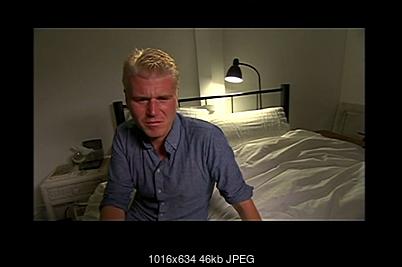

    Here is a sample of what I mean about the black borders all the way around. This video is 720x480 resolution but don't know what resolution to set the convertor at to get it to fill the screen as I have other video that is the same resolution but fills the screen.
    Thank youClick image for larger version

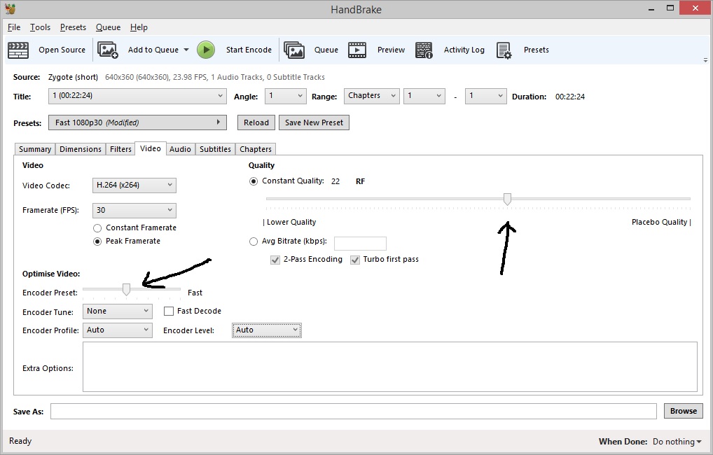

    Mar 2008
    The CRF value as well as the x264 preset (slow, fast, medium, etc) are about the two most important settings,
    other x264 encoder settings can be left to default unless you know what you're doing.

    The preset, as you say, affects the encoding time, the quality raises the slower you go. The default is medium so start there.
    The suggested CRF value is 18 - 22 (the lower the number the higher the bitrate).
    The output file size you get for a set CRF value depends on the complexity (clean/noisy, sharp/soft, still/movement, etc,etc)
    of the source
    If you have a requirement that you need a specific bitrate (file size) don't use CRF use 2-pass VBR

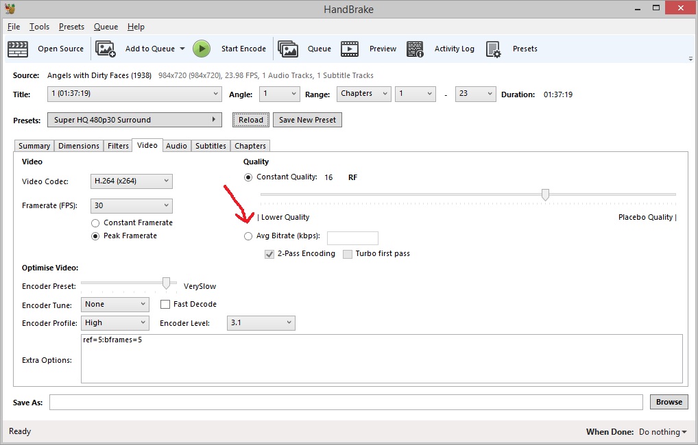

    I'm not sure what point you're trying to make, the presets are just suggestions, somewhere to start.
    All options are fully configurable when a preset is selected.
    2 pass VBR is not selected, it's not active, because the Avg Bitrate radio button is not selected -
    instead the Constant Quality is selected above. It's one or the other can't have both at the same time
