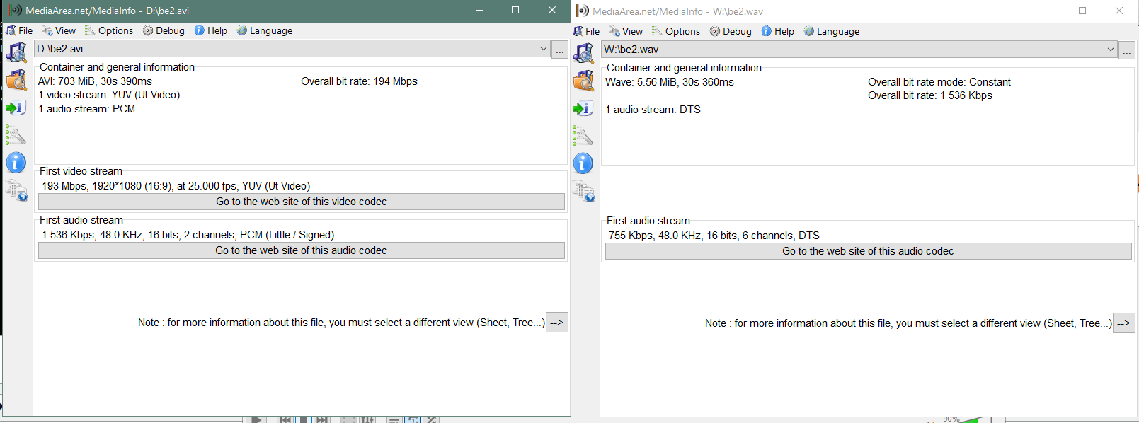

No real update - but I should stress this only works for me for Dolby Digital. Dolby Digital Plus didn't work. I haven't tried DTS. I very much doubt it will work for DTS HD MA/Dolby True HD. It requires that the compressed audio is SPDIF format over HDMI (so carried within a PCM 2.0 feed) - as I'm using the ffmpeg SPDIF filter (Which is designed to extract compressed DD audio over a SPDIF connection I believe)
True HD and DTS HD MA use a different form of carriage over HDMI - and the SPDIF filter isn't designed to cope with them. I believe that they also require 192kHz PCM 5.1 capabilities for the sink device (even though the source isn't using PCM 192kHz to carry the audio - it requires that level of bandwidth). The Black Magic capture solutions I have will only capture at max 48KHz - so I doubt they'd ever work for HD Audio.

You are correct - AC3/DD is only 5.1 max. I'm using this to archive content from a Sky Q box (216p60 HLG HDR or 1080i25 SDR + 5.1 AC3)
I have checked and E-AC3/DD+ with Atmos doesn't survive this route - I've not checked DTS.

ffmpeg doesn't like me specifying the input format for some reason. The 24bit -> 16bit conversion worked fine, but when I try to convert to AC3 I'm getting:
% ffmpeg -f spdif -i "T007_audio.wav" -c copy -f ac3 "T007_audio.ac3"

What is the MediaInfo for the original capture, and the 16-bit truncated capture, in detail?
Has your capture been split into stereo pairs or mono tracks? How many tracks have you captured? Do you hear buzzing on the first two tracks, or two channels of one track? (Stereo vs Dual Mono may be a factor here)
Also checking this is straight Dolby Digital-over-HDMI - not Dolby Digital Plus, True HD, DTS or DTS HD MA/HRA (and no Atmos or DTS)?Last edited by nogginvid; 24th Nov 2021 at 07:54.
haha Correct, 2.0 PCM. Yep I hear a constant buzzing while playing. Here's the MediaInfo on the original video file:
Code:General Complete name : /Users/rob/Desktop/NINJAV_S001_S001_T007.MOV Format : MPEG-4 Format profile : QuickTime Codec ID : qt 2005.03 (qt ) File size : 343 MiB Duration : 43 s 835 ms Overall bit rate : 65.7 Mb/s Encoded date : UTC 2021-11-22 20:06:55 Tagged date : UTC 2021-11-22 20:06:55 Writing library : Apple QuickTime com.atomos.hdr.gamut : Bt2020 com.atomos.hdr.gamma : PqSt2084 com.atomos.hdr.camera : Pq com.atomos.hdr.monitormode : Pq com.atomos.hdr.slider : Unknown kind of value! com.apple.proapps.image.{TIFF}.Make : Atomos com.apple.proapps.image.{TIFF}.Model : NinjaV com.apple.proapps.image.{TIFF}.Software : 10.7.3 Video ID : 2 Format : HEVC Format/Info : High Efficiency Video Coding Format profile : Format Range@L5@High Codec ID : hvc1 Codec ID/Info : High Efficiency Video Coding Duration : 43 s 835 ms Bit rate : 63.4 Mb/s Width : 3 840 pixels Height : 2 160 pixels Display aspect ratio : 16:9 Frame rate mode : Constant Frame rate : 23.976 (24000/1001) FPS Color space : YUV Chroma subsampling : 4:2:2 (Type 0) Bit depth : 10 bits Scan type : Progressive Bits/(Pixel*Frame) : 0.319 Stream size : 331 MiB (96%) Language : English Encoded date : UTC 2021-11-22 20:06:55 Tagged date : UTC 2021-11-22 20:06:55 Color range : Full Color primaries : BT.2020 Transfer characteristics : PQ Matrix coefficients : BT.2020 non-constant Codec configuration box : hvcC Audio ID : 1 Format : PCM Format settings : Little / Signed Codec ID : in24 Duration : 43 s 835 ms Bit rate mode : Constant Bit rate : 2 304 kb/s Channel(s) : 2 channels Channel layout : L R Sampling rate : 48.0 kHz Bit depth : 24 bits Stream size : 6.02 MiB (2%) Language : English Encoded date : UTC 2021-11-22 20:06:55 Tagged date : UTC 2021-11-22 20:06:55 Other ID : 3 Type : Time code Format : QuickTime TC Duration : 43 s 835 ms Frame rate : 23.976 (24000/1001) FPS Time code of first frame : 00:00:00:00 Time code, striped : Yes Language : English Encoded date : UTC 2021-11-22 20:06:55 Tagged date : UTC 2021-11-22 20:06:55
Code:General Complete name : /Users/rob/Desktop/t007_audio.wav Format : Wave File size : 8.03 MiB Duration : 43 s 835 ms Overall bit rate mode : Constant Overall bit rate : 1 536 kb/s Writing application : Lavf58.76.100 Audio Format : PCM Format settings : Little / Signed Codec ID : 1 Duration : 43 s 835 ms Bit rate mode : Constant Bit rate : 1 536 kb/s Channel(s) : 2 channels Sampling rate : 48.0 kHz Bit depth : 16 bits Stream size : 8.03 MiB (100%)
Maybe the Ninja V pads the 16bits differently than the BlackMagic, and so the 24 -> 16 truncation is ruining the format? I'm on a Mac, don't know if that matters.
Thanks for the help! -
Yep - could be the Ninja dithers rather than pads? I'm on a Mac too - so it's unlikely to be that. Checking your WAV in my MediaInfo install it doesn't detect any AC3.
My guess is that the Ninja either isn't 'bit perfect' in capturing this stuff and may be dithering or padding in a different way than just adding an LSB of all 0s to pad from 16 to 24 bit?
Media Info recognises the AC3 present in my PCM 2.0 prior to me running it through the SPDIF process in ffmpeg - but in your files it doesn't? That suggests something somewhere is corrupting the AC3-in-PCM 2.0 data.

Just to confirm that the audio is actually 24-bit not 16-bit PCM - here's the ffmpeg report from the same Quicktime file :

This may be slightly OT, but can someone explain why it's not easy to capture the multi-channel audio bitstream from the HDMI signal? It seems like a really basic stream capture. My sources are not HDCP so it's just a stream capture. I've tested a few of those basic capture dongles with Vdub, VLC and OBS and all want to capture the audio as 2-channel PCM. I'm not clear where that conversion is happening, but I suspect Windows. I remember a tool from years ago called something like displaygraph which could be used to configure codec behavior, is there something for win10/11 which could be used to identify what windows sees coming in from the USB capture device? (or should I start my own thread for this somewhat OT question?) -
1. You have to persuade your source to output 5.1 Dolby Digital not PCM 2.0. HDMI destinations use EDID (a data stream sent from the destination back to the source) to tell their sources what formats they support. If your capture device doesn't tell your source it supports Dolby Digital - your source won't output it. That's why I had to use EDID spoofing to get my route to work (my capture solution didn't flag Dolby Digital support - but I was able to put something in between to override that and tell my source that it DID support Dolby Digital). Without that - your HDMI signal will not have any Dolby Digital audio in it to capture. If you can re-program the EDID data your capture solution sends - you don't need the intermediate spoofing device - but pretty much every capture solution (other than things like the Hauppauge HD PVR 2s) don't flag Dolby in their EDID - they just flag PCM 2.0.
2. You have to have a bit-perfect PCM capture solution - many capture solutions aren't 100% bit perfect (the cheap USB HDMI capture dongles usually massacre audio). If you don't have a 1:1 bit perfect PCM capture - then your spoofed 'Dolby Digital captured as if it's PCM' capture won't be decodable back from the capture flagged as PCM via the ffmpeg SPDID filter to native Dolby Digital as it won't be a valid Dolby Digital signal. -
That makes perfect sense, so the problem is that capture device responds with supported audio as PCM (or no response and the source defaults to PCM). I was aware of this format negotiation with video, but never thought about audio because for formats like DTS the source historically asks the user to confirm that DTS is correctly delivered before fully enabling DTS. Sounds like current HDMI protocols may do a better job with the many audio formats. Thanks for the explanation.

I think this attempt was totally wrong. DVD captured DTS (as described above, for test only!) is not actually DTS at all (Mediainfo says so, but nothing plays it as such)
Tried as above (44.1/16) and also WDM 48/16
[Attachment 63344 - Click to enlarge]
Depending what version of wav2dts I use I get various errors:
W:\>c:\Wav2dts.exe .\be2.wav
FileSize : 5829224 bytes
Initial invalid bytes : 1912
Header 16le. Use SwapEnd to obtain a standard 16be.
W:\>c:\wav2dts1.exe .\be2.wav
Don't found any valid dts header in first 99998 bytes.
Definitely doing something wrong here... hopefully FLP437 can chip inLast edited by sebus; 13th Feb 2022 at 11:44.
If I do it with sox using -x I get:
E:\>Wav2dts.exe sou2.wav
FileSize : 5661700 bytes
Initial invalid bytes : 748
Header 16be. Seems is already a standard DTS 16be.
Absolutely spot on observation!
It is direct capture DTS (from DVD, will test LD later)Last edited by sebus; 13th Feb 2022 at 11:02.
