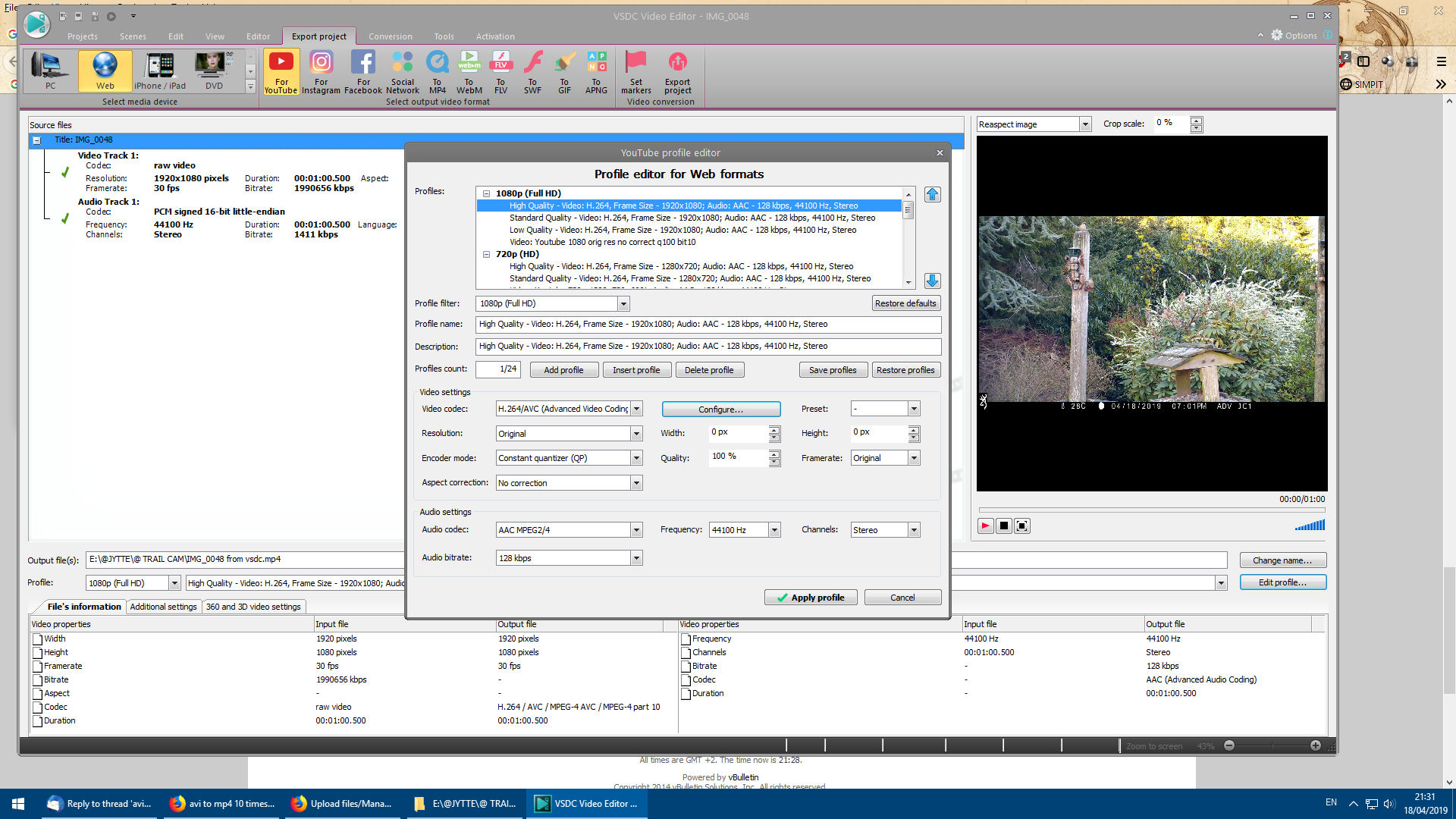

    I also tried VSDC. Imported the file, did not change a thing, went to export, using these setting:
    [Attachment 48708 - Click to enlarge]
    if the attach does not work, image is here: http://cotn.christrup.net/COTN/Forum/Vsdc1.jpg
    after export I ended up with a 1.184MB file ! That's crazy, isn't it?

    Somewhere you have to set the CRF value .... perhaps the configure button in your image above.
    Why don't you post the mediainfo (text view) of your output, the encoder setting should be in there, may help
    diagnose the problem

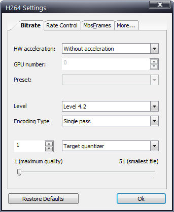

  18. That image shows you are encoding with a constant quantizer with a quality setting of 100. So of course you're getting really large files. You're telling it to use whatever bit rate is necessary to achieve "100 percent" quality. That's probably a constant quantizer of 1 or 2. Your source video is about 18 Mb/s, the output video is 160 Mb.s.
    Use a lower quality setting (or higher quaintizer) to get smaller files. Or change your encoder mode to use bitrate encoding with a specified bitrate if you want a specific file size.
    <edit>
    I see the later image shows a quantizer of 1 is being used.
    </edit>
    Mar 2008
    Yes, except the "encoding settings" is cut off in the image.
    But the settings box shows your "quality" is set to 1 by the look of it, this gives highest bitrate, biggest file size and best quality.
    Isn't this what you wanted?
    Otherwise put the quality slider to 18. What other options are there in the "rate control" tab?

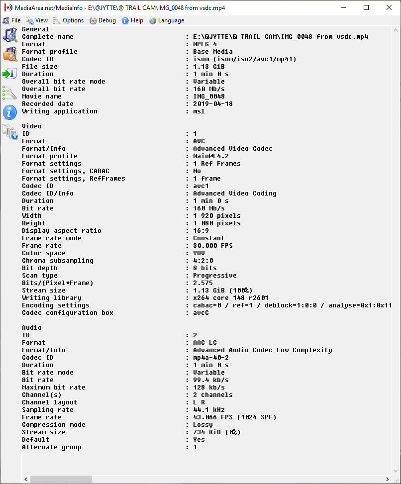

    encoding settings: : cabac=0 / ref=1 / deblock=1:0:0 / analyse=0x1:0x111 / me=hex / subme=5 / psy=1 / psy_rd=1.00:0.00 / mixed_ref=0 / me_range=16 / chroma_me=1 / trellis=0 / 8x8dct=0 / cqm=0 / deadzone=21,11 / fast_pskip=1 / chroma_qp_offset=0 / threads=12 / lookahead_threads=3 / sliced_threads=0 / nr=0 / decimate=1 / interlaced=0 / bluray_compat=0 / constrained_intra=0 / bframes=0 / weightp=2 / keyint=250 / keyint_min=25 / scenecut=40 / intra_refresh=0 / rc=cqp / mbtree=0 / qp=1 / ip_ratio=1.40 / aq=0
    greek to me
    Yes I want a quality file, but I'm at a loss to understand (I am a newbie) why an mp4 file that I export to 'same' mp4 file gets 10 times bigger.

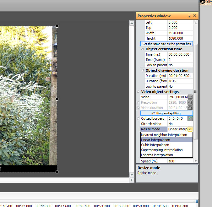

    I read somewhere (can't find it now) that the best compression mode is 'supersampling interpolation'. I checked it out in VSDC:
    [Attachment 48717 - Click to enlarge]
    I cannot chose 'supersampling' unless I upgrade to pro, which I'd do if I thought it would help me. But, I'm NOT resizing, I will always upload at 1080p (as raw), so...?
  22. Originally Posted by JytteC View Post
    I was wondering how these people, with great quality video at not so high MB, managed?
    davexnet is talking to you
    rc=cqp and qp=1 indicate a constant quantizer of 1 was used.
    You are decompressing the source video and compressing it again with x264. The new encoder knows nothing about what codec or settings were used on the original video. All it sees is uncompressed video frames. By using a constant quantizer of 1 you are telling it you don't care how big the file turns out, just save at the best possible quality.
