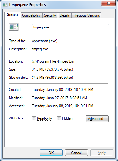

  10. ZIP up your bat file and upload it here. Also, navigate to your ffmpeg.exe with Explorer. Right click on it and select Properties from the context menu. Post an image of the General tab of the Properties dialog. For example:
    [Attachment 48685 - Click to enlarge]
