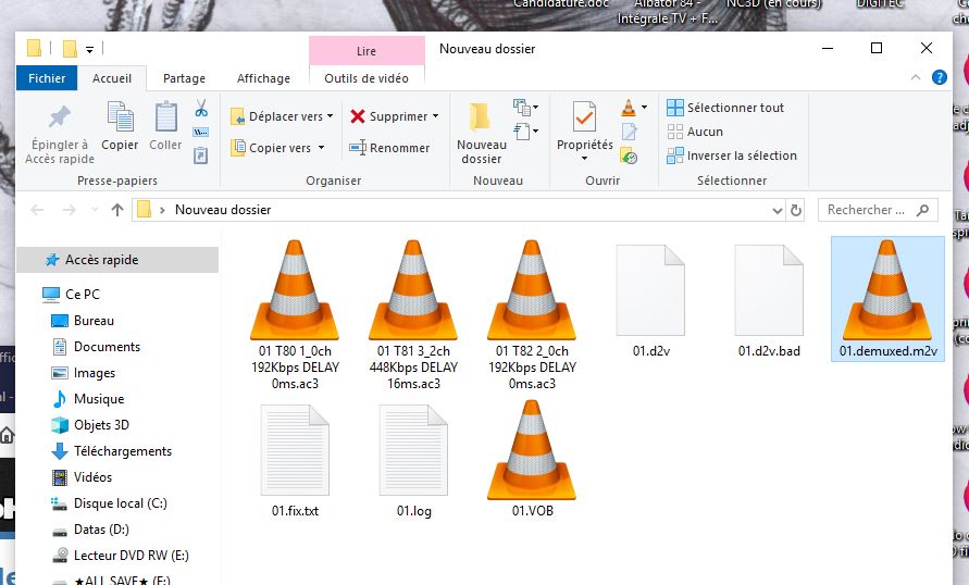

    I succeeded to demux my file with DGIndex. Now I have this.
    [Attachment 48715 - Click to enlarge]

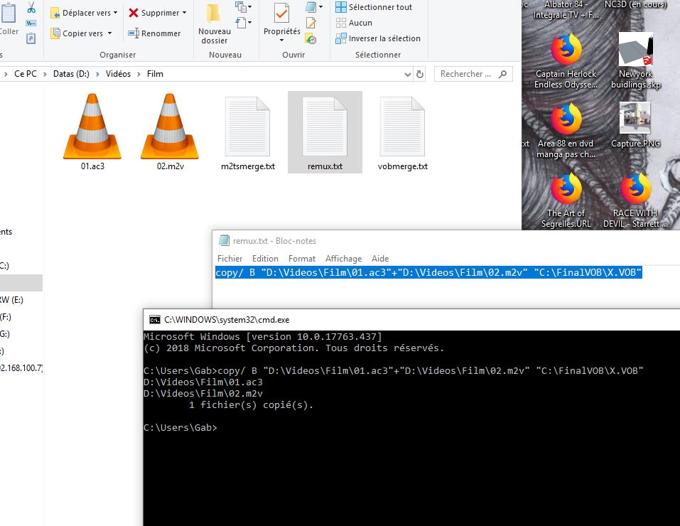

    Then, I did this, but it don't work, I only have audio on the final file. I also lost the subtitle.
    Btw, I didn't find any dedicated muxing tool to remux my extracted files.

  10. Copy/b isn't muxing, it's appending.
    Aug 2014
    Switzerland
    Pls can you write me the correct code?
  12. Copy/b copies all the first file to the output file, then appends all of the second file. That is not multiplexing. And even though you specified .VOB as the output file it is not a VOB file. (You can name a file with any extension you want, that doesn't make it that type of file. For example, rename your VOB file as .XLS and try to import it into Excel. It will fail miserably.)
    Multiplexing (muxing) copies a small amount of video (say, 1 frame), then a small amount of audio (1 frame worth of audio), then another small chunk of video, another small chuck of audio, etc. The video and audio are thus interleaved throughout out the file which makes it easier for a player to play the file. The muxer also follows the container's specification for how those chunks are organized and identified within the file so a player (or other program) can identify them. Different A/V containers use different methods of organization.
    I already gave an example using ffmpeg to remux from your source VOB directly to a new VOB with only the first audio channel. To mux the demuxed video and audio files you would use something like:
    ffmpeg -i video.m2v -i audio.ac3 -vcodec copy -acodec copy output.vob

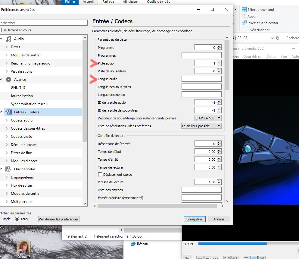

    Aug 2014
    Switzerland
    About subtitles: ok
    About audio:
    - files from folder#1: audio is fr1/jp2 (dragon ball)
    - files from folder#2: audio is fr1/jp2 (space adv. cobra)
    Settings I did on the files of the folder#1 will be not valid for the files of the folder#2 since those files was ripped from different DVDs.
    The settings I did is the following:Image
    [Attachment 48734 - Click to enlarge]
    >First step (audio track) is effective case by case as I described below. Number ''1'' on dragon ball will set ''jp'' by default, but same number ''1'' on space adv. cobra will set ''fr'' by defaut, or sometimes even no audio at all concerning other mangas, or movies...
    p.s. second step (audio language) doesn't change anything, even if I tape 1, 2 or empty.
  20. Member DB83's Avatar
    Jul 2007
    Try reset that first audio setting to -1 from 1.
    Use the audio menu to select the desired track and not rely on preferences.
