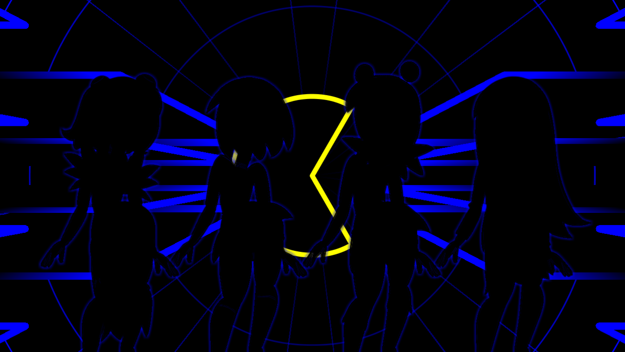

    Okay. This isn't the exact SWF I'm interested in, but it's another specimen from the same author, and I found it exhibits the same issues. Plays in Swiff Player, albeit at an unreliable framerate; VLC chokes on it; VDub only produces a single, inverted frame.
    http://eye.swfchan.com/flash.asp?id=206285&n=dffdgdfdgf.swf
  6. Aside from using something like "Macromedia Flash 8" you best bet converting such a file is to do a screen capture.
    Also converting an swf which loops forever will cause problems unless you stop your screen capture at some point,...

  13. Which swf ? "dffdgdfdgf.swf" ?
    This one isn't that complex ...
    If you decompile it, you will get 23 sprite shapes meant to be played back at 30FPS . It's essentially a png image sequence looped. Larger than 800x600. It's rasterized at 883x681 - you have to crop it to 800x600 to get what you see in a swf player, or potplayer
    This is a like a looped video with audio . You can use ImageSource to load the images (but you might have to rename the images to have the proper placeholder digits; instead of 1.png you need 01.png etc...), FFAudioSource or something to load the mp3
    A higher FPS doesn't give you more smoothness. It just give you duplicate frames. e.g if you have a 24.0p blu-ray, but you record at 60.0fps - you end up with 3:2 duplicates. If you "record" at UHD, but the source is 1920x1080, it's pretty pointless too...I hope you get the idea . This SWF is 800x600 @ 30.0 FPS looped
    Some swf's decompile with vector elements. This is better because you can re-create it at any resolution without quality loss (vectors can scale without quality loss if you use proper software)
    Complex swf's can be very tricky - they have composited elements, transparency, overlay layers, timed elements, user interaction...
    That was just one I offered up as an example of a SWF I was having similar difficulties with (smaller and less complicated). Fair enough. Here's one of the ones I'm specifically looking to convert. It has all of the problems that are making converters choke:
    http://eye.swfchan.com/flash.asp?id=203878&n=Ghost.swf

  21. Yes, Ghost.swf is more complex . And it will take a LONG time to decompile it; partly because of the length , because it's 9792 frames, but also the layer elements alpha chanel, and the BG canvas is 11210 x 6072 (!) . Large crop or viewing area . That also contributes to the poor playback performance . But it will work, and you will get every frame, not duplicates, no drops. Huge PITA, but OTOH, access to the individual elemetns gives you more control, for example, you could decide not to include the text overlay (which is a separate element)
  22. Member
    May 2009
    Okay, but I mean what steps does one take to decompile it? I assume you say it would take a long time because it has to be done by hand, but is there some kind of guide for this sort of thing? That's the important factor because this is really just one of at least half a dozen SWFs I intend to work on, each of which have pretty much the same exact problem that causes apps to choke on them. And I mentioned this to someone else earlier, but in a perfect world, what I really wanted to do was add motion blur (from within Adobe Animate or whatever passes for a Flash editor) because I think it could be made to look rather better with it. Either with a motion blur plug in (which exists) or by reiterating the entire animation at a higher framerate and then taking advantage of the added temporal resolution to generate the blur.
    And this still begs the question: How is some random Youtube bloke able to just whip out a rock solid 60fps of this like it was practically automated?
