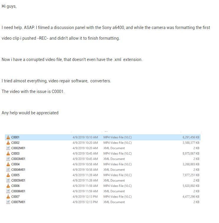

    Well, this is the problem.
    [Attachment 48613 - Click to enlarge]

    possibly the file didn't get the mov atoms written. without the file descriptors nothing can use it. one of those pay to repair sites might work since you have other working files from the cam. don't know if they can handle 6.5gb files though.

    Which one is my best bet?
    I tried the free ones but they restore a couple of frames at the beginning of the video and that's it.
    Mar 2008
    If it just the moov atom, it's possible the untrunc program that runs in Linux could help.

    The camera is not broken, i stopped her when she was formatting, by mistake of course.
  6. After first copying the contents of the card to your computer -- place the card back in the camera and try using the "Recover Image DB" function on the camera. It's designed for just this kind of situation and usually works.
