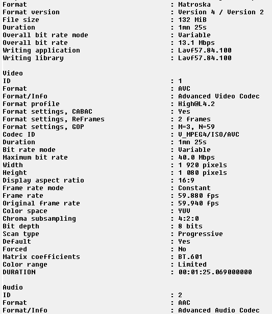

Using MKV container. I'm not sure if the following test sample is from an"auto" or designated (1 or 2sec) keyframe interval.
[Attachment 48612 - Click to enlarge] -
With that mediainfo, it looks like you have a hard 1 second GOP. So GOPs above 1 second should be impossible if the M=3 N=59 is honored. So seeking times should be fast. What are you trying to seek in, what program?
Edit: You are going to want to change your Matrix Coef to BT.709, instead of BT.601. 709 for 720p and above, 601 for SD. Generally. This can be changed in OBS.Last edited by KarMa; 8th Apr 2019 at 13:58.

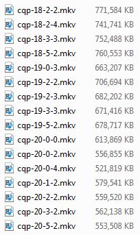

Took some time last evening and this afternoon to run quite a few tests. This included 5min records of the same media segment using CQP with variables being CQ Level (18-20), Keyframe Intervals (seconds, 1-5, 0(auto)) and Max B-Frames (0-4). Interestingly, as seen in the CQP-20 series of tests, the file size results weren't always linear. I'd also have to say visual quality was indistinguishable throughout the entire test. The noticeable difference was absolutely in seekability. The worst was when keyframed "auto" followed by "5". The sweet spot looks to be "3". Pair that with a Max B-frame of "3" and CQ of 19 I think I have most of my settings sussed.
