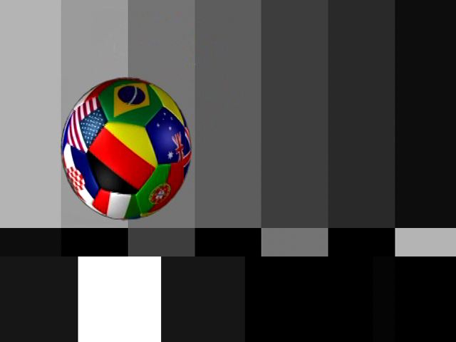

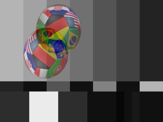

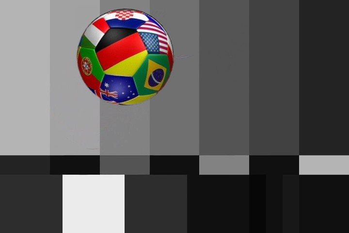

  11. Here's an example of the bad chroma handling of DV in Handbrake.
    Two frames generated from the two fields of one DV frame (yadif+bob):
    [Attachment 48861 - Click to enlarge]
    [Attachment 48862 - Click to enlarge]
    The same two frames generated by QTGMC in AviSynth:
    [Attachment 48863 - Click to enlarge]
    [Attachment 48864 - Click to enlarge]
    You can see that Handbrake blended the colors from the two fields together. That has caused ghosting of the colors on the grey background, and loss of saturation on the moving ball (because the colors of the ball were blended with the grey background).

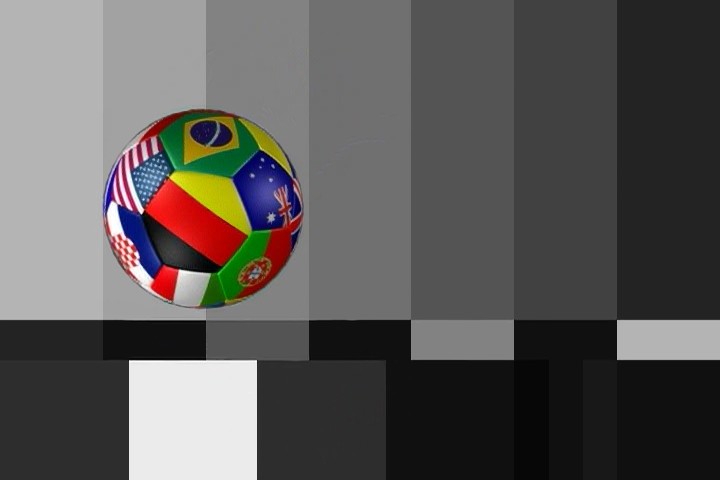

    That's really so interesting, thanks for the samples. Just for comparison, this is the same frame from deinterlacing with JES deinterlacer plus "Remove jaggies" and "Reduce noise". It is jagged, but no color bleeding. Definitely, QTGMC is better.
    [Attachment 48866 - Click to enlarge]
  16. Originally Posted by celsoac View Post
    Why doesn't this have the same chroma problem as Handbrake?
    This is why I don't like freeze-framing a very specific scene - it's great for illustrating a point or showing the strengths/weaknesses of a particular approach, but never gives the full picture.
    I'm 100% sure my home video footage does not have a very clear and super colorful ball bouncing quickly across the screen. Most of it is people sitting around in the backyard or opening Christmas presents. However, in this very specific example, JES Deinterlacer looks better than yadif/bob/handbrake/ffmpeg - but yet I know how everyone [else] feels about JES Deinterlacer!

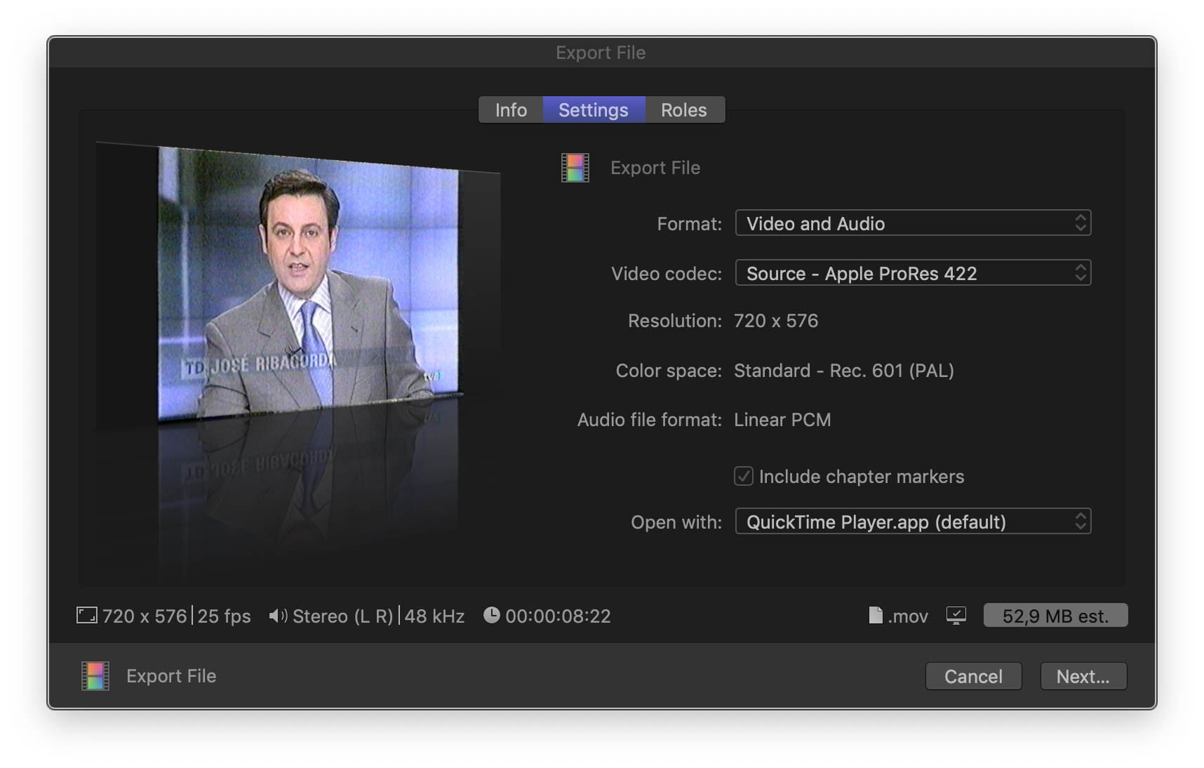

    My version of FCP Pro 10.4.6 does not do that: apparently it works with ProRes as an intermediate codec. If I input a DV file and I output it as "same source" in Export, look how the "same source" is ProRes:
    [Attachment 48867 - Click to enlarge]
    I don't want to be whatever, but, are you sure the codec of that output is DV? Are you sure FCP can edit directly on a DV format? That is, if editing is done, in my mind whatever software one uses needs to reencode, at least the part that was changed. It may be the case that, if you use DV as output, what FCP is doing is re-reencoding it to DV from an intermediate format.

  22. Originally Posted by jagabo View Post
    People where talking about JES's blend deinterlacing. What's done in post #255 isn't simply blending. A pure blend deinterlace would look like this:
    [Attachment 48868 - Click to enlarge]
    Yes, absolutely. When I (hundreds of posts ago ) said that JES Deinterlacer blending looked better than other options is because (a) in scenes with very little movement is quite good, and (b) when there is fast movement, interlaced output looks horrible. This is a sample from the same recording from TV:
    [Attachment 48869 - Click to enlarge]
    So, what to do? In my previous experience, deinterlacing by dropping one field per frame (whether keeping only one field or double framerate) diminishes quality. At least blending seemed better in no-motion scenes, and it looks similar to motion blur in others. Now that I've learned here , I see that blending is generally wrong also for interlaced material (there is nothing worst than poorly done telecine, with lots of frame blending in 24fps => NTSC, etc.). But in general I don't think that doubling framerate is a good option, either. Now, QTGMC is quite amazing as compared to other methods, because it seems to treat each field as a separate full frame calculated from the contiguous ones, almost as if the original source were 59.97p or 50p instead of interlaced.
    In other words: no, blending in general is not a good idea, you are right. I've been convinced of that.
    Here are some samples (some superfluous), for the sake of it.
  23. Originally Posted by Christina View Post
    I know there are some pretty big differences between FCP 7 and the current version. In fact it's basically not even the same program anymore. So maybe your version just handles it differently and doesn't have that option anymore.
    Yes, I am pretty sure! I believe it is called lossless editing and if I'm wrong, someone please correct me. From what I remember, an hour+ video took about 6-7 minutes to output using this method, so I am fairly certain it's not reencoding using an intermediate codec.
    Christina, thank you for the information, you're right. I didn't know that. I've been looking around, and, yes, this web page says:
    https://larryjordan.com/articles/picking-the-right-version-of-prores/
    "My recommendation is that if you are shooting HDV, XDCAM HD, XDCAM EX, or DVCPRO HD, transcode into ProRes 422. If you are shooting R3D, HDCAM, HDCAM SR, or 2k formats, transcode into ProRes 422 HQ. While ProRes can also be used for SD projects, my suggestion is to work with the native codec, such as DV, rather than transcode into ProRes."
    So, FCP 7 transcoded for other codecs, but not for DV. I believe that FPC X transcodes everything into ProRes 422.
    Unfortunately, I never had FCP 7. When I bought it, it was already FCP X. And, of course, Apple no longer provides it.
