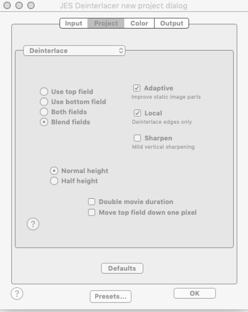

    Hi there, Christina. So, I'm back here after having tested quite a few things, as I think we have common purposes and similar limitations (Canopus hardware). Let me explain what I'm doing:
    - First, I digitize VHS with and old version of iMovie that does not break the recording due to bad syncing etc. The result is, yes, limited DV, but that's what I've got. It makes no sense to digitize directly into ProRes through a DV device.
    - Now, this interlaced DV file is tricky -- interlacing in general is, unless the source is 24fps film. When the source is film, it is easy to restore a progressive frame made up of the two fields (top + bottom). But with an interlaced TV signal, actually each field is recorded at a different time, so blending them may yield blurry frames. And another problem is, of course, "teeth" or edges when blending the two fields. BUT,
    - I've found out that a very good option is deinterlacing the DV file by blending the fields into a progressive-frame format, specifically with JES Deinterlacer, free, very flexible. I've tried other deinterlacing/blending methods, including with Final Cut Pro, Handbrake (Bob), etc., and so far JES Deinterlacer is the best by far. The options I use are these: Blend fields, Adaptive (to movement), Local.
    - The output for this may be ProRes, or uncompressed 2vuy (lossless in regards to the DV source, which is lossy, of course). Since I'm going to fiddle around more with the file, I often choose uncompressed.

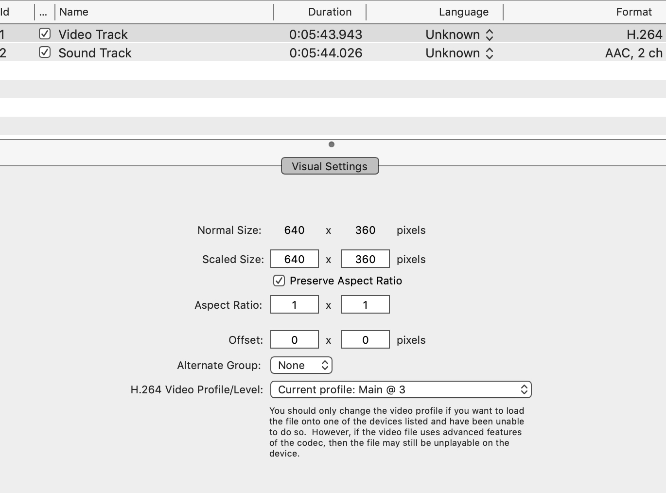

    - Since my video source is VHS PAL, the 576 horizontal lines don't fit nicely into any of the standard sizes for upload to, f.ex., YouTube, which are 640x480 or 1280x720 (YouTube is one of the final destinations, so I also need to take this into account). NTSC is 480 lines, but it has 720 real (coded, sampled) vertical pixels, so in my mind downscaling a NTSC file to 640x480 means losing real pixels, right? Wouldn't it be easier to upscale the file (by changing pixel ratio) to 720x540? If so, you've also got a non-standard resolution. So,
    - In order to preserve the best quality possible from a VHS source, in my humble opinion a good solution is to insert the 768x576 or 720x540 frame into a 1280x720 frame, with black edges around. MPEGStreamclip can do this: source 768x576, destination 1280x720 with negative cropping. So, the picture inside doesn't take the entire screen, but when played at 100% size (for example, in the computer) it maintains the original size/quality.
    - For the final output for playback I choose MP4 at high bitrate. Info can be edited with Subler
    In short, my tools are iMovie, JES Deinterlacer, MPEGStreamclip, Subler.
    That's terrible advice. May as well not even convert the video, it'll look like crap.
    You're also confused about AR, discussed earlier in this thread. Read those posts.

    And, like lordsmurf, I think blend deinterlacing is about the worst possible choice. Too bad you're on a Mac as AviSynth has the best deinterlacers, if your sources are really interlaced and not telecined.

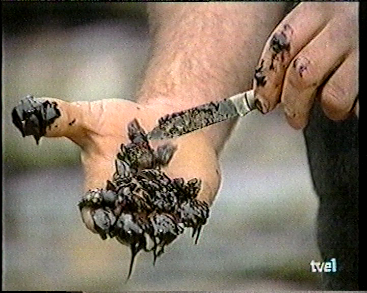

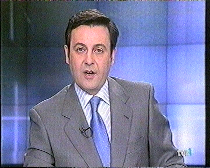

    Here you can compare a short segment in interlaced DV and deinterlaced (both fields blended) with JES Deinterlacer, in uncompressed 2yuv and ProRes, from a 2002 video recorded from TV.
    The best way to preserve a DV digitalization is of course keep it unconverted. But it turns out that DV needs to be converted to MP4 to be shown on-line. That's the purpose of deinterlacing (turning it progressive). Of course I know that MP4 means a loss of quality.

    Same thing about aspect ratio. I may not express it correctly, but I know how to correct aspect distortion in a MOV or MP4 without reencoding the file, which is what matters to me.

    Man, do I have to re-comment ALL of your snappy comments for your unsatiable display-of-knowledge?
    1) I KNOW MP4 is just a wrapper, an envelope. But, as you say, usually the format is H.264 "online", which, if you have read, in my case means YouTube.
    2) I KNOW many types of formats/envelopes can be streamed locally. I do that with movies in my home network.
    3) Have you watched the "butched" segment of a deinterlaced video whose link I sent? I've tried MANY deinterlacing methods with lots of software. Have you tried the one I'm talking about, JES Deinterlacer? It surprised me.
    4) "There's really no way to do that, aside from setting flags. But that's often not valid, depending on usage. For example, you can't just re-flag the video for DVD authoring. Nor Youtube submission. Re-encode will happen, whether you realize it or not, often a hidden function of the software."
    Have you ever used Subler. Well, here is the screen where I change the display appearance of a video that looks distorted (it's not real 4x3, or it looks 16x9 but the source was 4x3, etc.), by playing around with scaled size and aspect ratio. No reencoding takes place.
    [Attachment 48760 - Click to enlarge]
    Again, flagging is flagging, software choice makes zero difference. (And unless something has changed, Youtube ingest is 1x1 SAR as 16x9/etc DAR, or it re-encodes.)
    I sometimes re-flag videos for varying reasons, using MKVToolNix. But not all devices will cooperate with the re-flagging. My Samsung Blu-ray player will reject some resolutions, and distort the video. The only foolproof way to correct bad AR is via re-encoding. And again, some strict uses will entirely reject non-compliant flags, forcing re-encode.
    Video has rules, and you must abide by them. Video has constants and variables, and you must understand them. When you do whatever you want, problems happen, quality loss happens.
    OK, it's good to know that YouTube ONLY takes SAR = DAR, ie PAR 1:1. The material I upload it's already been reencoded by me, to MP4/H.264 with "real" pixels.
    I understand that. But for particular uses, as you do, if I have an MP4 with the wrong aspect ratio, reencoding it makes it loose quality, while flagging doesn't.

  29. Originally Posted by celsoac View Post
    Do you presume it looks terrible, or have you downloaded and watched the fragments I uploaded?
    I downloaded the videos and looked at them. First of all you encoded a video with hardly any movement. So the worst effects of a blend deinterlace aren't shown. But here's an example, frame 23 from your JES 2YUV:
    [Attachment 48763 - Click to enlarge]
    Notice how the lower edge of the knife blade is badly aliased. At normal playback speeds edges like that "buzz". The black blob just below the knife edge/tip is fuzzy and indistinct. That's because it's a blend of two different fields. Here it looks a bit like motion blur because the motion was small. But with larger motions it would look like a double exposure.
    Here's the result from QTGMC(sharpness=0.7) in AviSynth (frame 47 after QTGMC):
    [Attachment 48764 - Click to enlarge]
    The knife edge is smooth and sharp. The blob below the knife is much sharper. For reference, here's the QTGMC result of the prior field (frame 46 after QTGMC) that was blended in the JES deinterlace (your blend deinterlace is a blend of these two fields):
    [Attachment 48765 - Click to enlarge]
    Beyond those types of problems, your video only has half the motion smoothness (25p) of the original video (25i, 50 fields per second). QTCMC produces a 50p video by default, keeping all the motion smoothness of the original. 25p is jerky and flickers when motions get larger.
    And regarding the quality of the DV capture, the video has pretty poor horizontal time base. Scanlines of the picture wiggle erratically to the left and right with each field. You need a line TBC to stabilize that. And your VHS deck is badly oversharpening horizontally, creating halos around sharp vertical high contrast edges.
  30. Originally Posted by celsoac View Post
    Do you presume it looks terrible, or have you downloaded and watched the fragments I uploaded? Because, in fact, the blended version looks better to me: in the DV version, sometimes you see the lines/fields, as is common in any interlaced source.
    But compared to other higher quality deinterlacers it looks bad
    Blend deinterlacing quality is poor. In general, it's the worst choice. Because you are combining 2 fields into 1 - you have both ghosting (double image), and aliasing artifacts (jaggy lines, marching ants), with 1/2 the motion samples (choppy motion) . You are essentially throwing away 50% of the information right off the bat; youtube supports 50p for many years now for 720p or higher
    Contrast is increased too much - levels blown out - reduced highlight, shadow details . It's unclear if jes did that, or something else in your process
    Here is a comparison (1:1 , not AR corrected) as an apng (safari, firefox, chrome should support it)
    CLICK to open apng
    [Attachment 48766 - Click to enlarge]
    -blown out shirt collar details
    -aliasing jaggy lines around the collar, and eye lids.
    -missing hair detail from aliasing
    -blurry suit and microphone (ghosted image) , and if you had real motion (e.g. sports) it would look even worse .
    Your specific sample has timebase errors, jitter field issues. Blending the errors between fields helps by by averaging them out, but at the expense of motion smoothness, aliasing, blurry ghosting.
