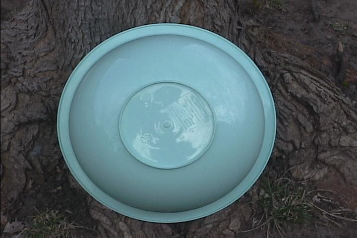

Now we resize from 704x480 to 640x480 to give a 4:3 frame:
[Attachment 48626 - Click to enlarge]

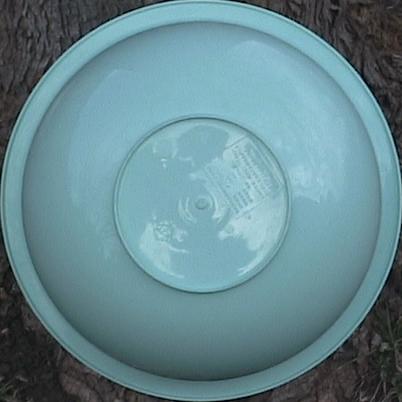

Let's verify that the bowl is a perfect circle. We further crop so that the frame just touches the edges of the bowl:
[Attachment 48627 - Click to enlarge]
That leaves a 402x402 image, a perfect square surrounding a perfect circle. We have now verified that the correct DAR is 4:3 and that comes from a 704x480 portion of the original 720x480 frame. -

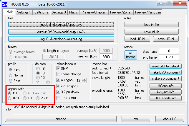

If you are making a DVD, for example, from a VHS capture and keep things at 720x480, how do you get things back to real proportions? (i.e. how do you get your plate back to a perfect circle if you’re not displaying at 640x480?)
You specify the DAR flag when you encode. For example, in HCGui:
[Attachment 48629 - Click to enlarge] -
