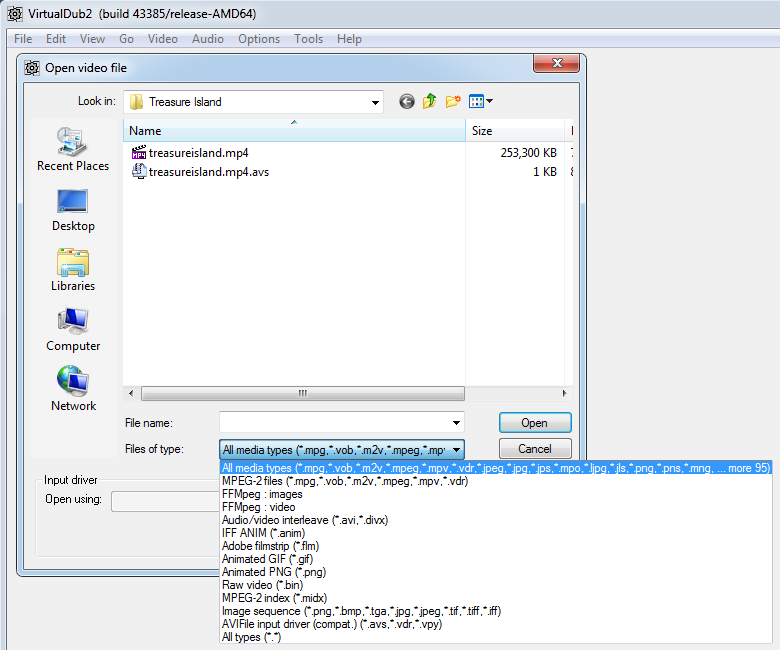

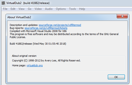

    The program you are running is not VirtualDub2. Select Help -> About... and post a screenshot showing both the main VirtualDub2 window and the about dialog:
    [Attachment 48538 - Click to enlarge]
  23. This is it.
  24. In the Open Video File dialog what does the Files Of Type pulldown show?
    [Attachment 48540 - Click to enlarge]

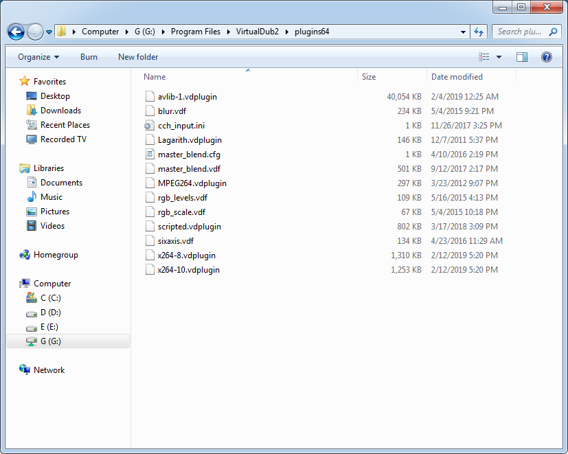

    And what's in the Plugins64 folder:
    [Attachment 48543 - Click to enlarge]

  26. You appear to be missing a bunch of the plugins -- those that allow the opening of MP4 files, for example. I downloaded and used the same version you have just before post #26 so those are all the default plugins. I don't know why you're missing a bunch.
