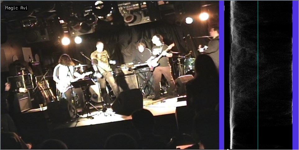

  1. so it could be compared shifted, ok
    import vapoursynth as vs
    from vapoursynth import core
    input=r'F:/Output.avi' #magicyuv (here it is RGB)
    clip = core.ffms2.Source(input)
    clip = core.std.SetFrameProp(clip, prop="_FieldBased", intval=2)  # 2 is TFF
    clip = core.resize.Bicubic(clip, matrix_s = '170m', format = vs.YUV420P8).text.Text("Magic Avi")[129:]
    d2v_file=r'F:/Source .MPG'
    clip2 = core.d2v.Source(d2v_file).text.Text("MPG")
    clip_out = core.std.Interleave([clip,clip2])
    clip_out.set_output()

    magic was check interlace and check full range with rec601
    and used levels to put them in legal range within vegas

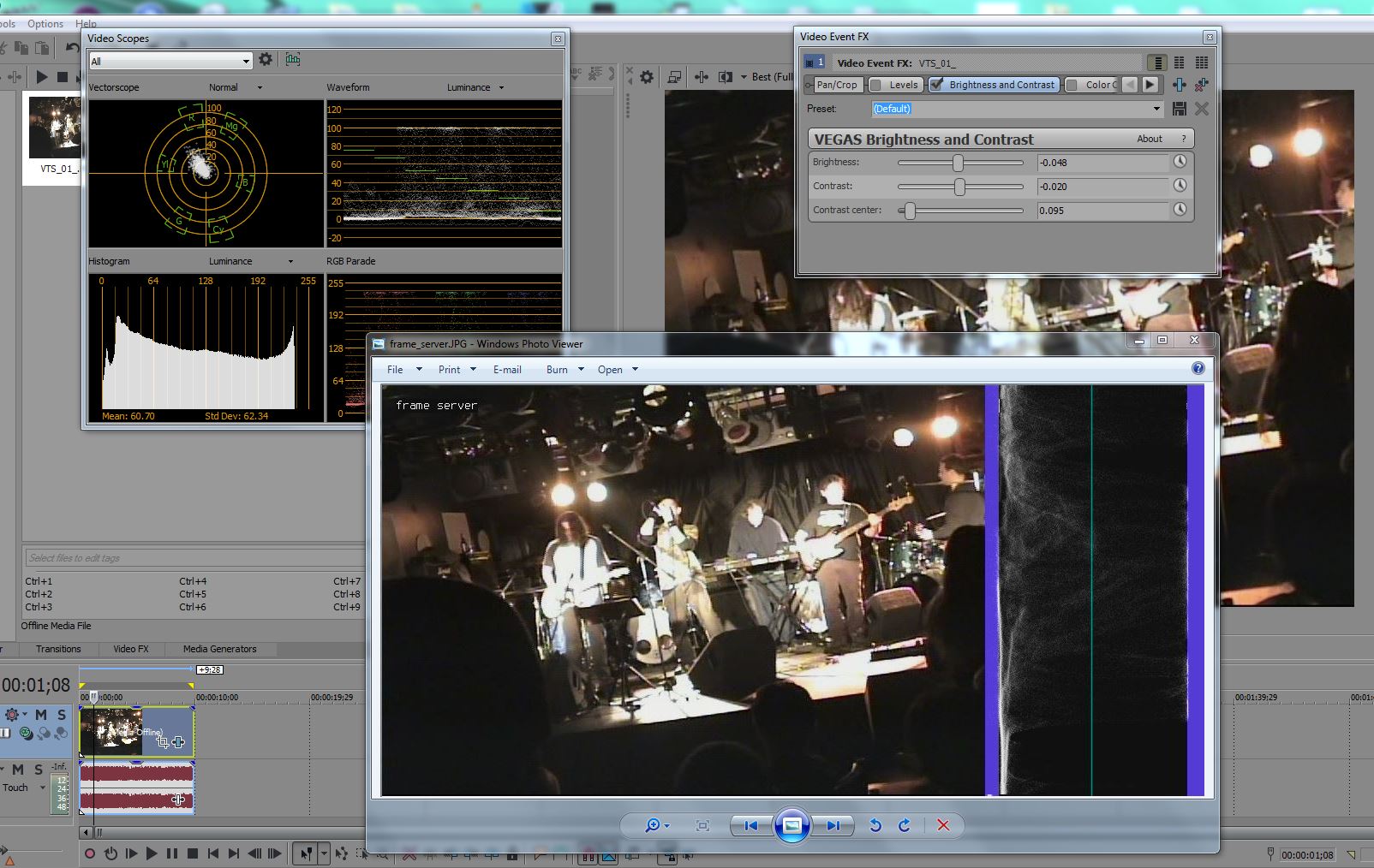

  3. Vegas crushed both blacks and whites.
    Dec 2010
    quebec
    avisynth's histogram showed them both borderline..
    i'll give them more headroom to breath , the whites are already blown in the source
  5. For example 255 values were brought down to legal value 235
    and blacks also the other way , but it is not needed
    you do not need to fix blacks
    what effect did you use?
    use basic brightness, contrast and center to tune it up , that should be in your version of Vegas - > to bring whites down, not blacks, or blacks just a tiny bit towards dark
    this is your MPG and that Magic comparison, as you can see you do not need to crash blacks further together with whites

  8. nice tricks
    in that Vegas using basic logic, just small steps, basics how to fix it:

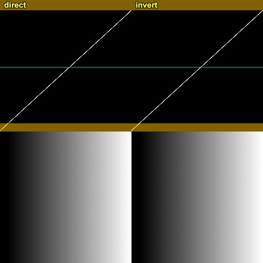

  12. Why invert, adjust, then invert again? SmoothLevels is linear (when not using the gamma option) so skip the inversions and just use SmoothLevels to pull the whites down.

  14. You're not using the gamma option in your SmoothLevels call (it's set to 1, no change). So the function is linear.
    function GreyRamp()
       black = BlankClip(color=$000000, length=256, width=1, height=256, pixel_type="RGB32")
       white = BlankClip(color=$010101, length=256, width=1, height=256, pixel_type="RGB32")
       StackHorizontal(black,white)
       StackHorizontal(last, last.RGBAdjust(rb=2, gb=2, bb=2))
       StackHorizontal(last, last.RGBAdjust(rb=4, gb=4, bb=4))
       StackHorizontal(last, last.RGBAdjust(rb=8, gb=8, bb=8))
       StackHorizontal(last, last.RGBAdjust(rb=16, gb=16, bb=16))
       StackHorizontal(last, last.RGBAdjust(rb=32, gb=32, bb=32))
       StackHorizontal(last, last.RGBAdjust(rb=64, gb=64, bb=64))
       StackHorizontal(last, last.RGBAdjust(rb=128, gb=128, bb=128))
    GreyRamp().ConvertToYV12(matrix="PC.601")
    dir = SmoothLevels(16,1,255,16,235, HQ=true).TurnRight().Histogram().TurnLeft().Subtitle("direct")
    inv = Invert().SmoothLevels(0,1,235,20,235, HQ=true).Invert().TurnRight().Histogram().TurnLeft().Subtitle("invert")
    StackHorizontal(dir, inv)
    [Attachment 49020 - Click to enlarge]
    Also, note that the difference between 255 and 235 is 20, not 16.

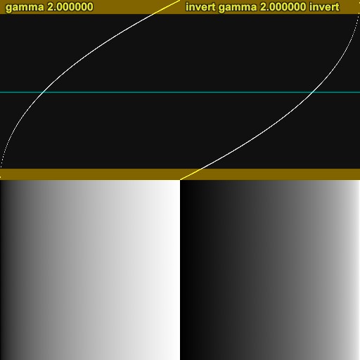

  16. Effect of gamma, SmoothLevels(0 ,2.0, 255, 0, 255, HQ=true), and invert() before and after.
    [Attachment 49024 - Click to enlarge]
