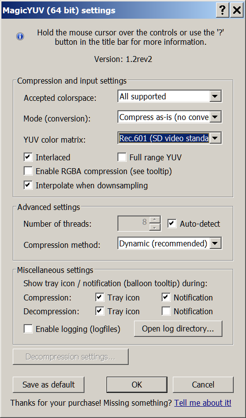

    my source , output and dialog box

    Virtualdub uses MagicYUV for decompressing .. so MagicYUV isn't used for every application ?
    some do..and some don't ??.. i guess this codec can recognise itself ..
    it's a FourCC thing stored in the header and .AVI doesn't support it . Am i understanding this well ?
    Would it be better exporting in .mov via the quicktime 7 option ?
    i won't resize so i let it to "none" i guess...

  22. I don't have MagicYUV installed so I used ffVideoSource() to read the AVI file. It delivered RGB32 by default.
    And once again, AVI doesn't support the flagging of interlaced video. I don't have MagicYUV installed but the interlaced setting in it probably doesn't do anything except control how it converts YV12 to RGB or RGB to YV12 (if asked to do so). It may also effect how the codec handles the video internally. MagicYUV also probably doesn't differentiate between TFF and BFF because it doesn't have to. It's up to you to keep track of that.
    Regarding what decoder is used for different programs, programs can use any decoder that supports the compression scheme. They can used installed VFW decoders, installed DirectShow decoders, or their own internal decoders. On top of that you have both 32 bit and 64 bit subsystems. What happens in one may differ from what happens in the other depending on what's installed.
