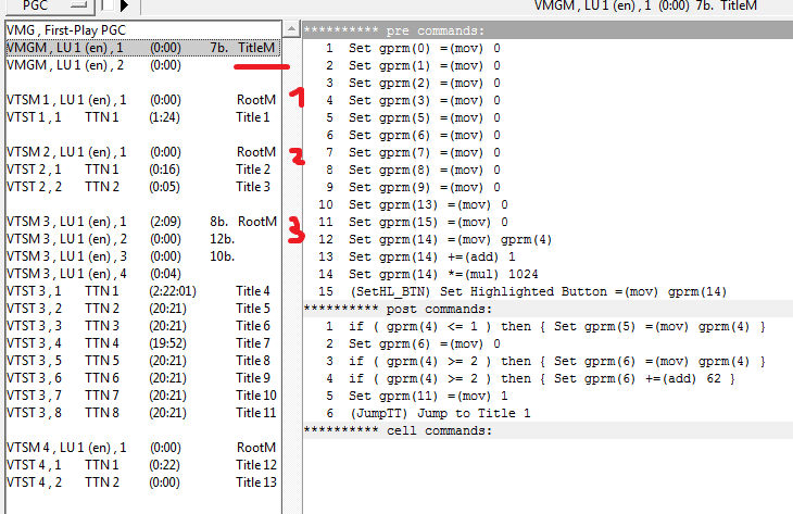

  4. only have one titlemenu, is set correctly, but when i click on rootmenu go back to titlemenu screen, i do not it, what do i do when i click on root to go to the rootmenu screen and not to the titlemenu screen?
    look

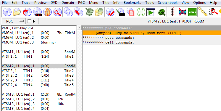

    But i tried another way by following his guidance, because i found your way too complicated, full of details, so i did like this: I did not create new PGC in VMGM, LU 1, in PGC 1, which is titlemenu. And in the VTS that contains the studio logos and warnings, i selected RootM PGC, in the Alphabetically tab selected JumpSS-VTSM, and gave a value of 3 in "Jump to VTS (0-99)", because it is in VTSM3 the PGC where the main menu.

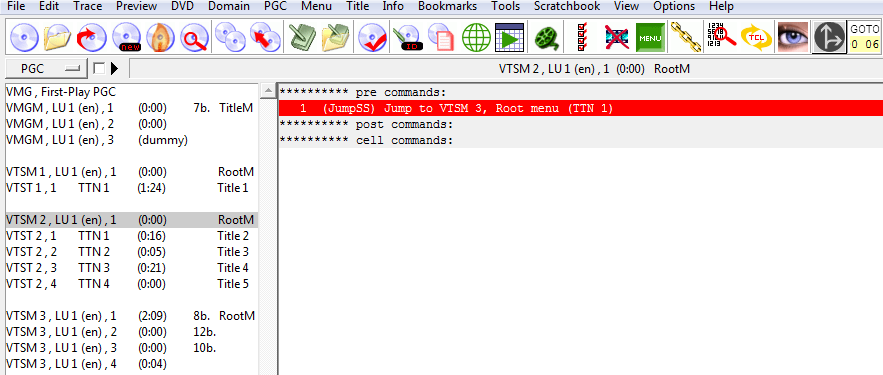

    It was successful not to go back to the titlemenu when i pressed root on the warning screen, although i did not test if all the buttons are playing as they should, but my way the RootC PGC command turned orange, and when i click it it turns red, this indicates something wrong?
    It my way
    2º doubt: why it turned orange and red this indicates errors on some part of the dvd that will not work?
    my question is whether it could save the DVD with my simplest way of doing it, or would it have to do in its complicated way full of details to have no problem on dvd?

    Yes, a red command means that it is illegal, and it will probably not work with the vast majority of hardware players (although some software players are more tolerant with the errors).

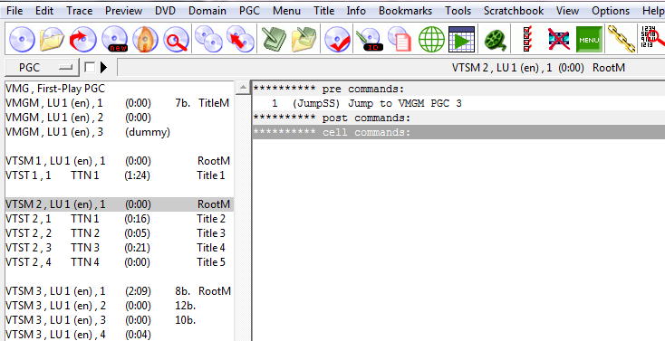

    The DVD-Video standard is complicated, and we have to obey the rules. In this precise case, it is prohibited to jump directly from a VTS to another VTS. You MUST bounce through the VTSM. So, complicated or not, only the method I have explained by email is acceptable and will certainly work.
    BTW, when you edit a command to jump somewhere in the DVD, I suggest to use the menu "Jump to..." in the command editor. From that menu, you can select the destination, and see if there is a command that can do what you want. The commands that you cannot use are greyed out, and the unreachable destinations are not available. In your case, you will see that it is only possible to jump from a RootM PGC to the First-Play PGC, any PGC in the VMGM or any menu or title PGC in the same VTS, but it is impossible to jump to another VTS.
