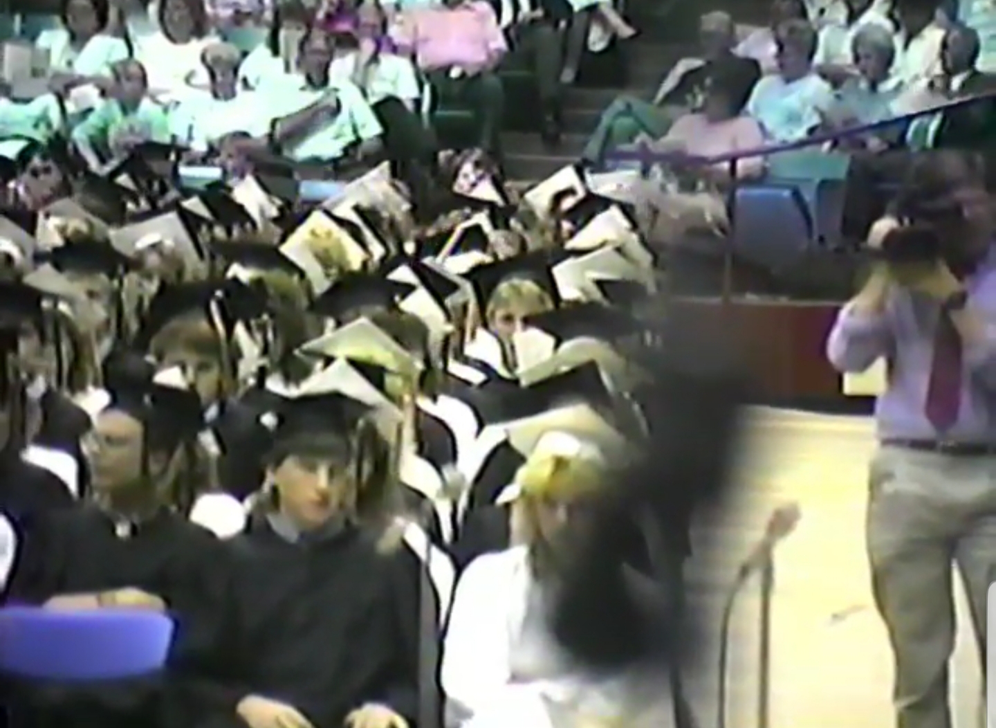

With horizontal lines:
[Attachment 48468 - Click to enlarge]

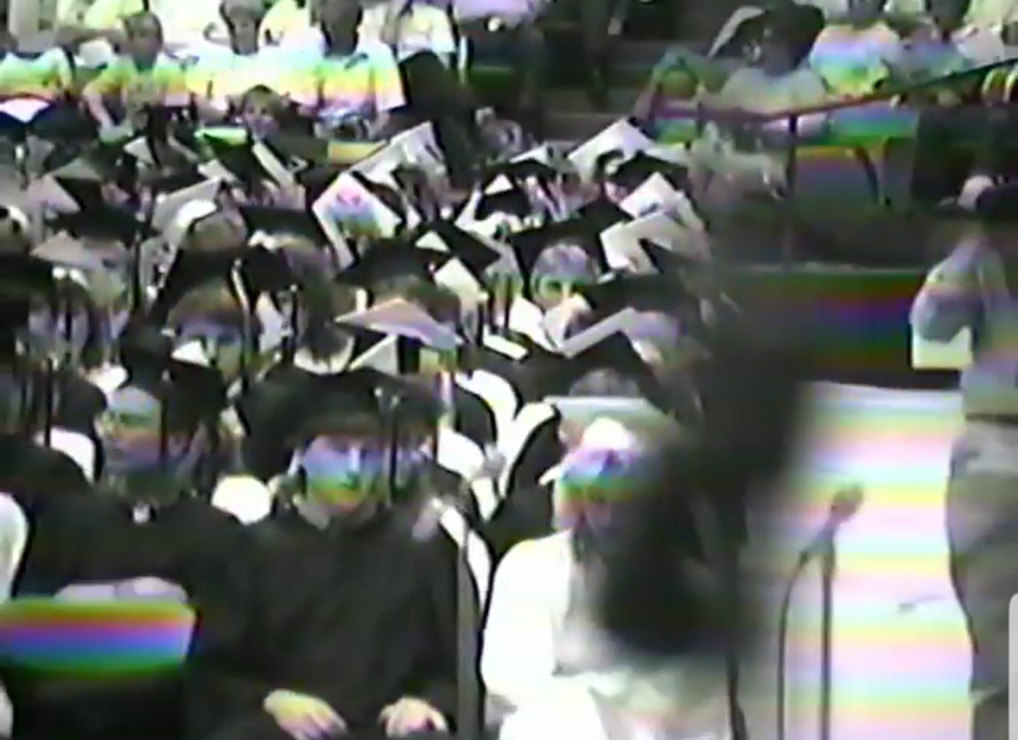

A second later the lines go away:
[Attachment 48469 - Click to enlarge] -
No, not dirty heads. When that happens you get snow. Does the artifact always occur in the same place? Across different tapes?
The artifacts always occur in the same places per tape and I see them on multiple tapes. I might have some old store bought movies on VHS. If I can find those I'll try and see if they show up on those too. Maybe it's just these old home videos.
This can be so much things, tapes losing magnetic information, electronics like old electrolytic capacitors that need replacement, hard to say. Did you try on other VCR's?
A VCR with a TBC would be the best to test your tape. -
Jagabo,
I was going to ask the same thing. It might be bad tapes and not the capture card. -
If the the damage is consistent in the same location of the tape then probably there is nothing he can do about it, Those rainbow artifacts usually happen in second generation tape recordings. The only way to know for sure is using a VCR with built in TBC and S-Video cable hooked up to TV or good quality capture card/device.
Video like that was often always like that. Meaning not a playback VCR, not aging, etc.
And lot of people mis-remember tape condition, so falsely assume the issue is current, or from aging.
I'd try another VCR. That sort of error can be many things, and in my experience, anything not present on the tape at record time is from a bad playback deck.Last edited by lordsmurf; 24th Aug 2019 at 19:02. Reason: forgot word
