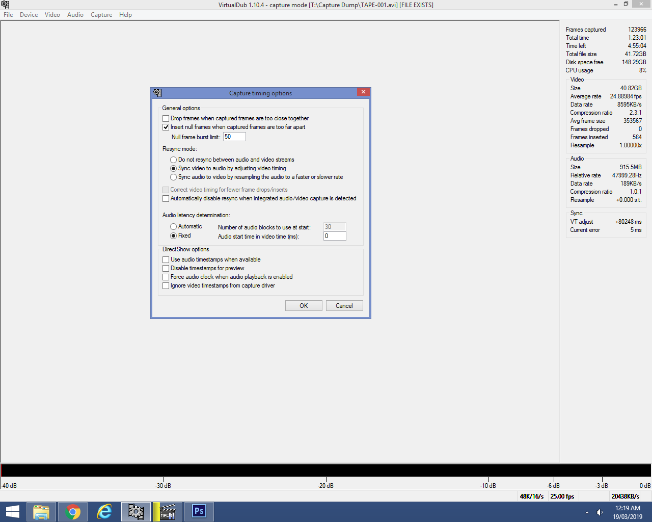

	YES. I've Fixed it!
 Finally, after 8 attempts.
 If anyone is interested these are the settings I used for the timing options and it finally worked:
 [Attachment 48455 - Click to enlarge]

	That's not good.Frames Inserted: 564
 Some other things to try:
 1) Resync mode: Do not resync audio/video
 2) don't let VirtualDub play the audio while capturing
 3) don't compress audio while capturing
 4) Use a fast lossless video codec while capturing
	Thanks for your response.
 The 'frames inserted' counter only rises when static is being captured between recordings on the same tape.
 You know the black and white static you get on tapes when nothing is recorded on it. It only happens when it captures that between some of the shots, it doesn't rise when it's capturing actual video signal.
 So I don't think it's a bad thing in this case, but you're right, if that figure was rising while capturing actual signal and not static, I guess that would be bad.
