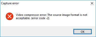

    2) Using lagarith I wasn't able to even capture and got the following error message (attached).
    Any ideas?

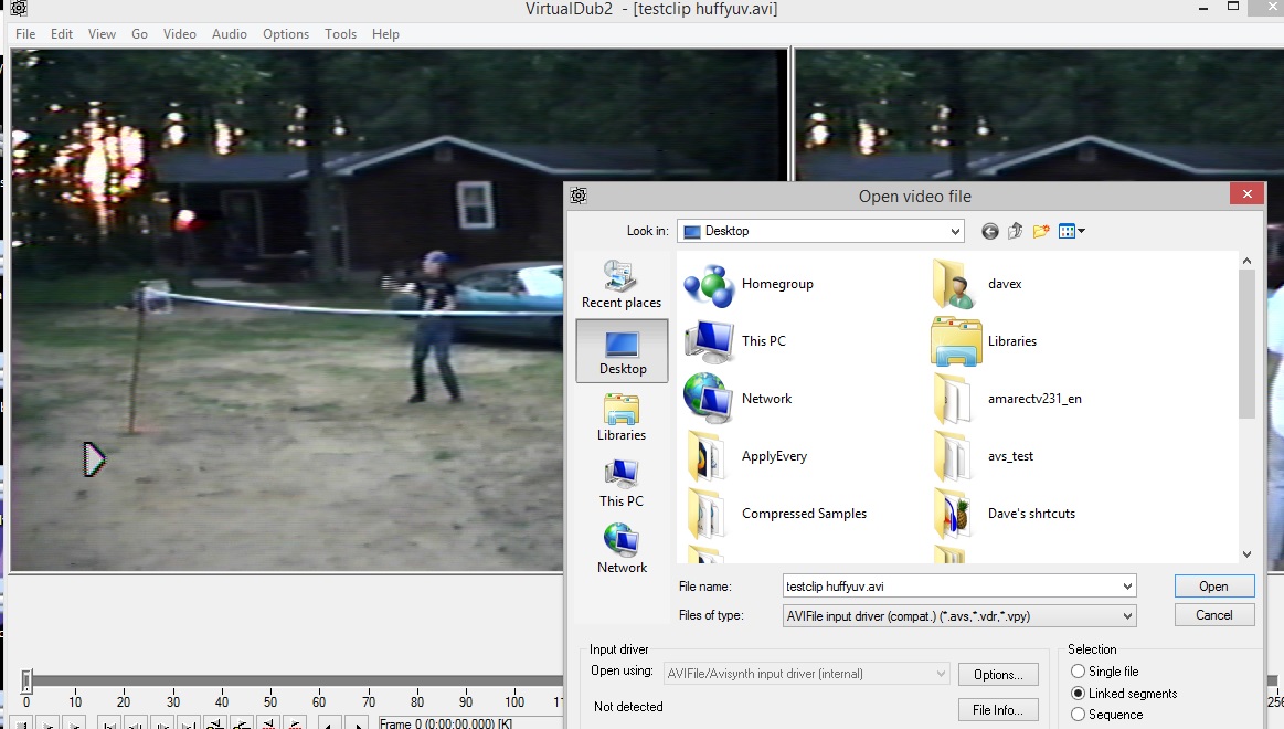

    It seems Virtualdub2 can open it if you set the input file driver (files of type) appropriately:

    That is very strange that the file type selection does not even match the avi extension file type and you need to type it in by hand.

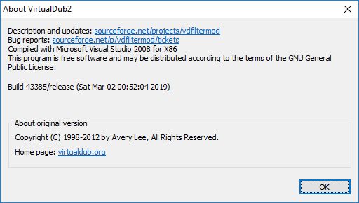

    As I stated in my original post I started by using VirtualDub 1.9.11 32-bit and huffyuv 2.1.1 with the CCESP Patch v0.2.5. I got these from the DigitalFAQ website. I installed huffyuv following the instructions on that site using a cmd window. On my second try I installed The VirtualDub 2 (see attached version). I am thinking about uninstalling the huffyuv version and reinstalling one without the patch or an earlier version.
